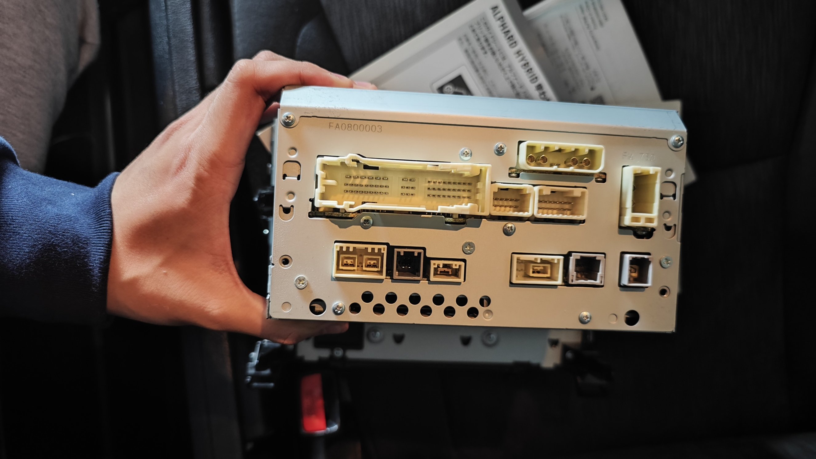

I'm trying to install this Head Unit on my 2014 Alphard (ATH20) and I've got some connection issues. Not sure which one is the ones for sound and which are for the steering wheel. Are any of you able to send a wiring diagram or connection list?

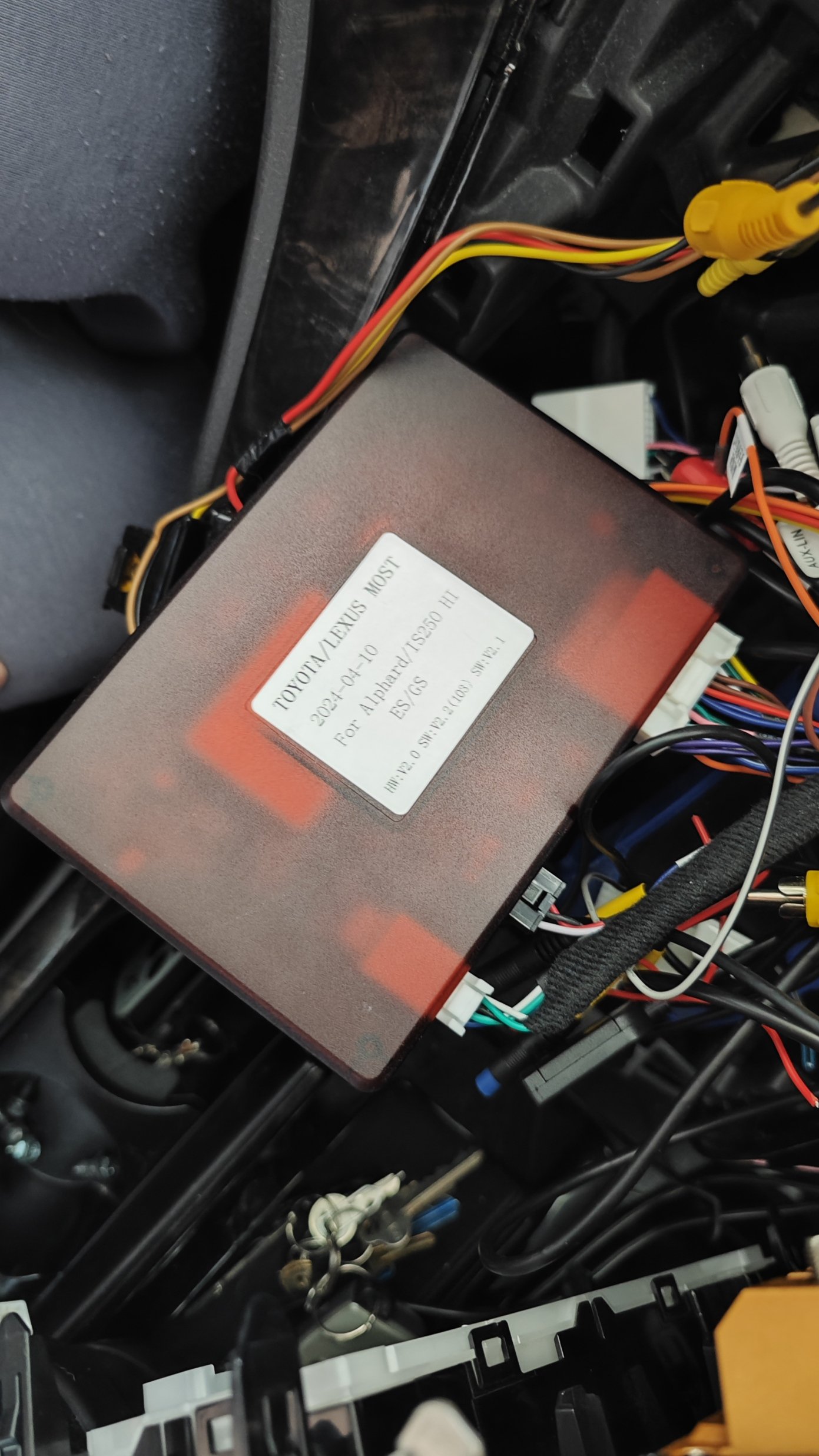

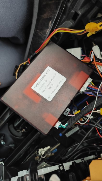

We are also using this to connect in-between. Not sure if this helps.
Those connections are identical to mine. It has been a bit of a nightmare trying to replace that head unit with a Pioneer one. I have identified some connections. I have to go out soon but will post a fuller acount of what I have discovered, later today.

Hi,
So, that looks identical to the head unit in my 2014 Hybrid - does yours have the 18 speaker sound system as well? If it has, I am (as sure as I can be) that you don't need the MOST adapter in the second picture (more for the OP's info than you Hardi) - that's for alternated HU's that don't have the MOST control built in (i.e. an Android HU).
From another thread on here on no sound issues, I think the top connector next to the one labelled FM 75 ohm with the 4 round co-ax type is the MOST audio bus that connects the amplifier and the rear screen sound - this is a loop system so if there are any breaks in it the audio doesn't work.

Hi Again - there is an error in my post of 11th April. The Audio connector is the bottom LH one - the one I originally identified as Audio is an aerial / antenna socket.
Interestingly, the connector immediately next to the very large one is not used in my Alphard (Hybrid 2014 model).
