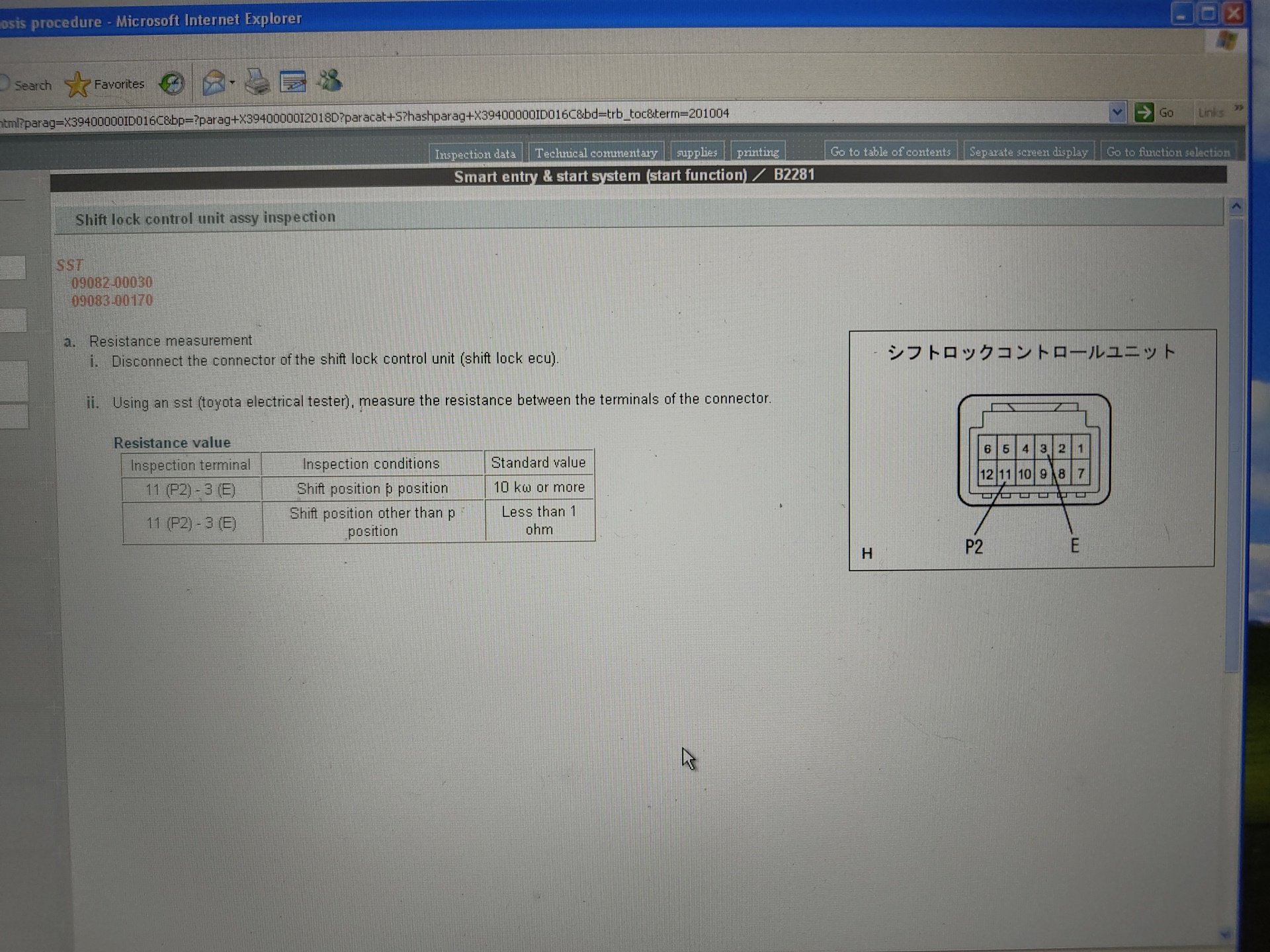

B2281 is smart entry and start system (start function)
Probably looked to some damage to the can system - ECU due not recognise shift is in P.

Really sounds like a connector or loose somewhere, probably when you recover the headunit.
The ecu has inputs for Reverse, gear selection, etc, so doors not detecting a park signal etc.
