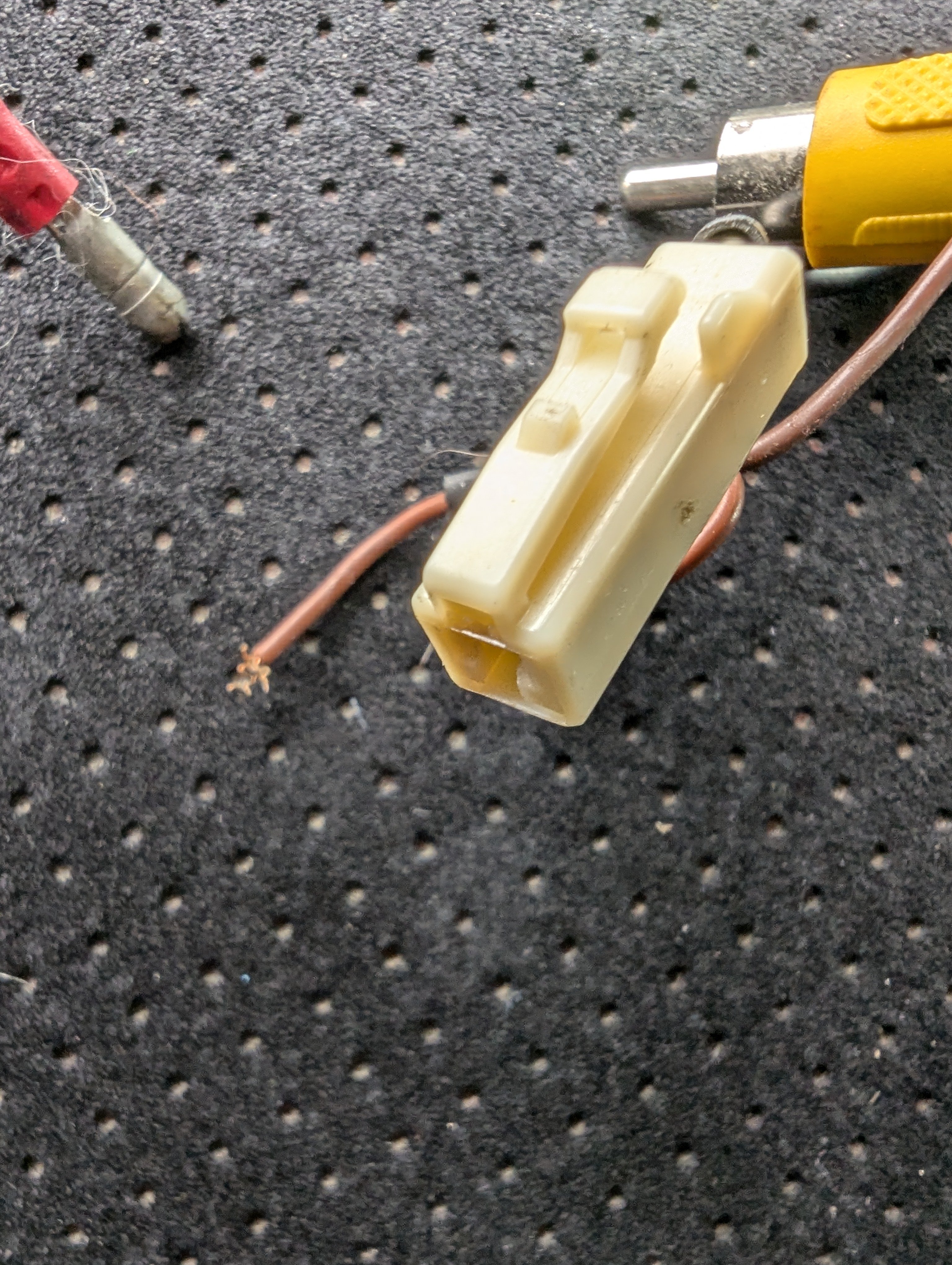

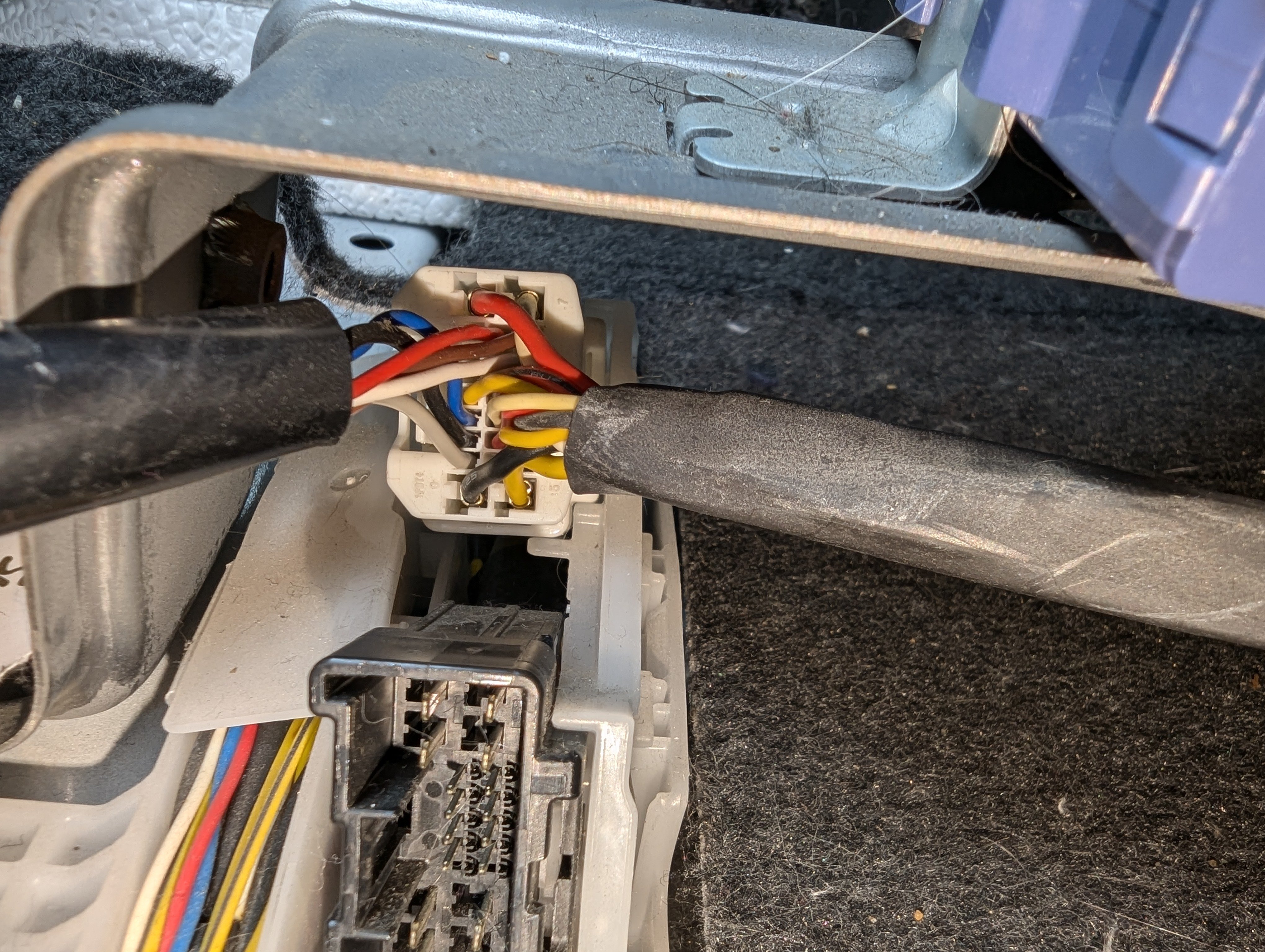

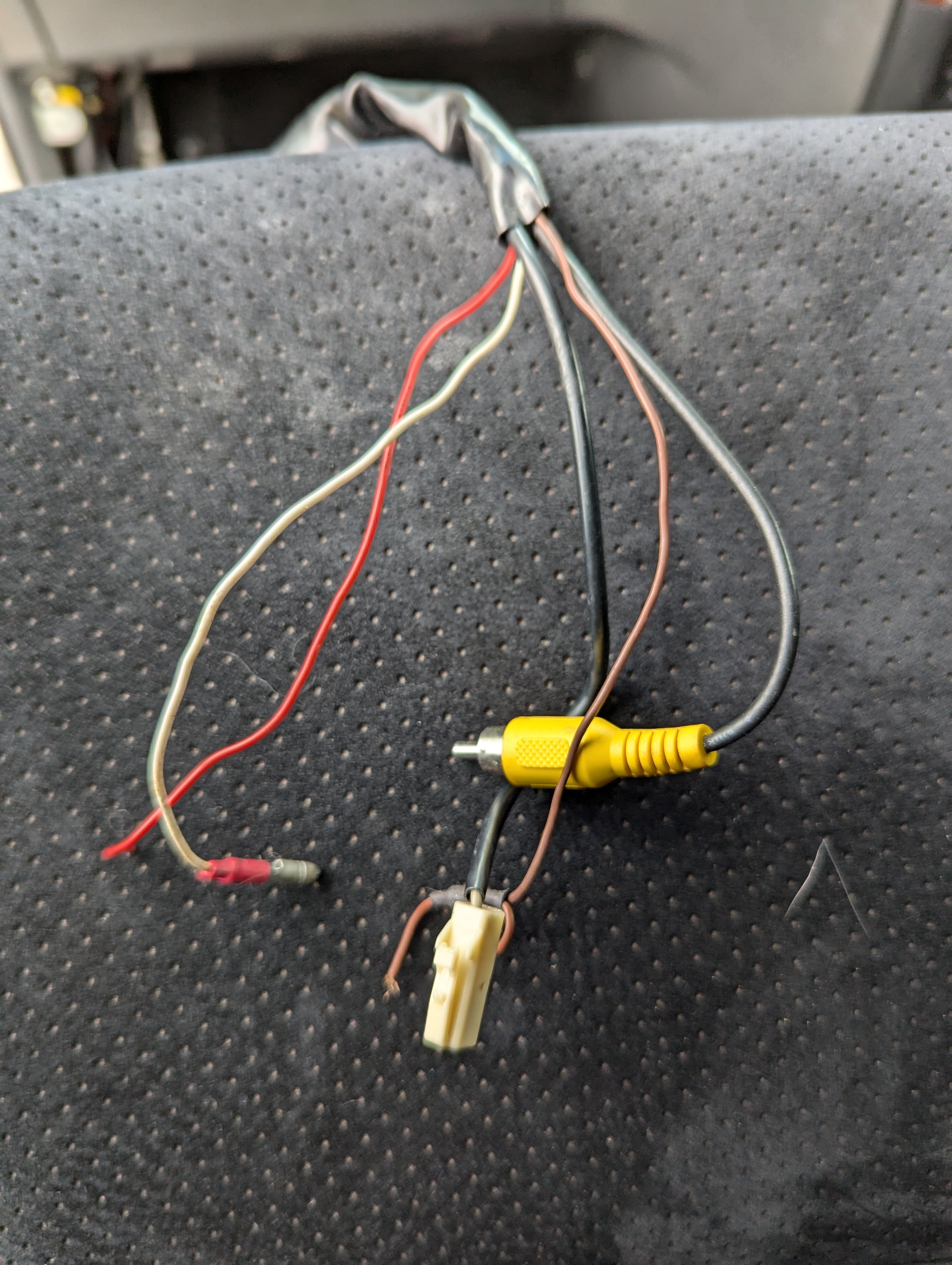

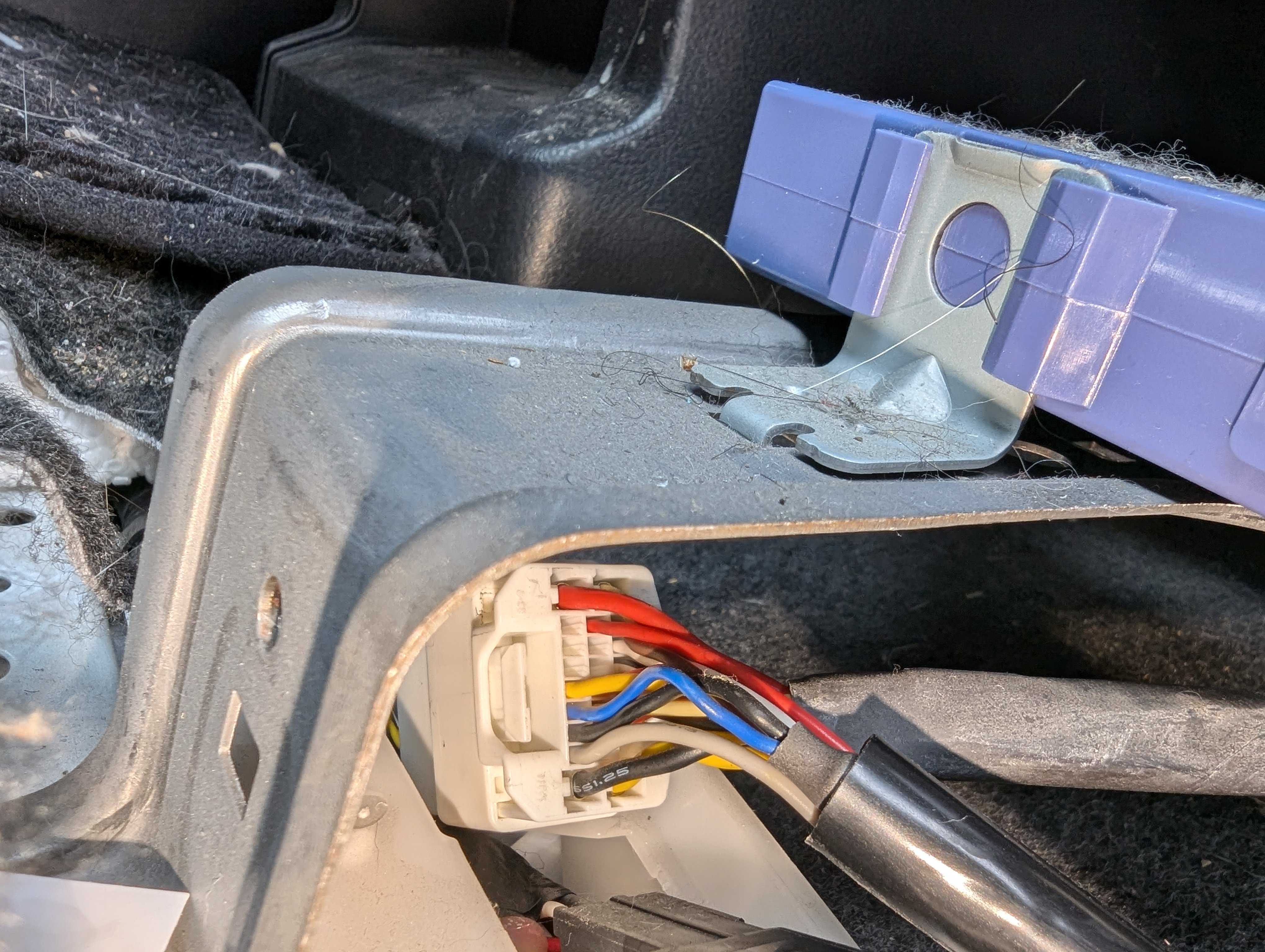

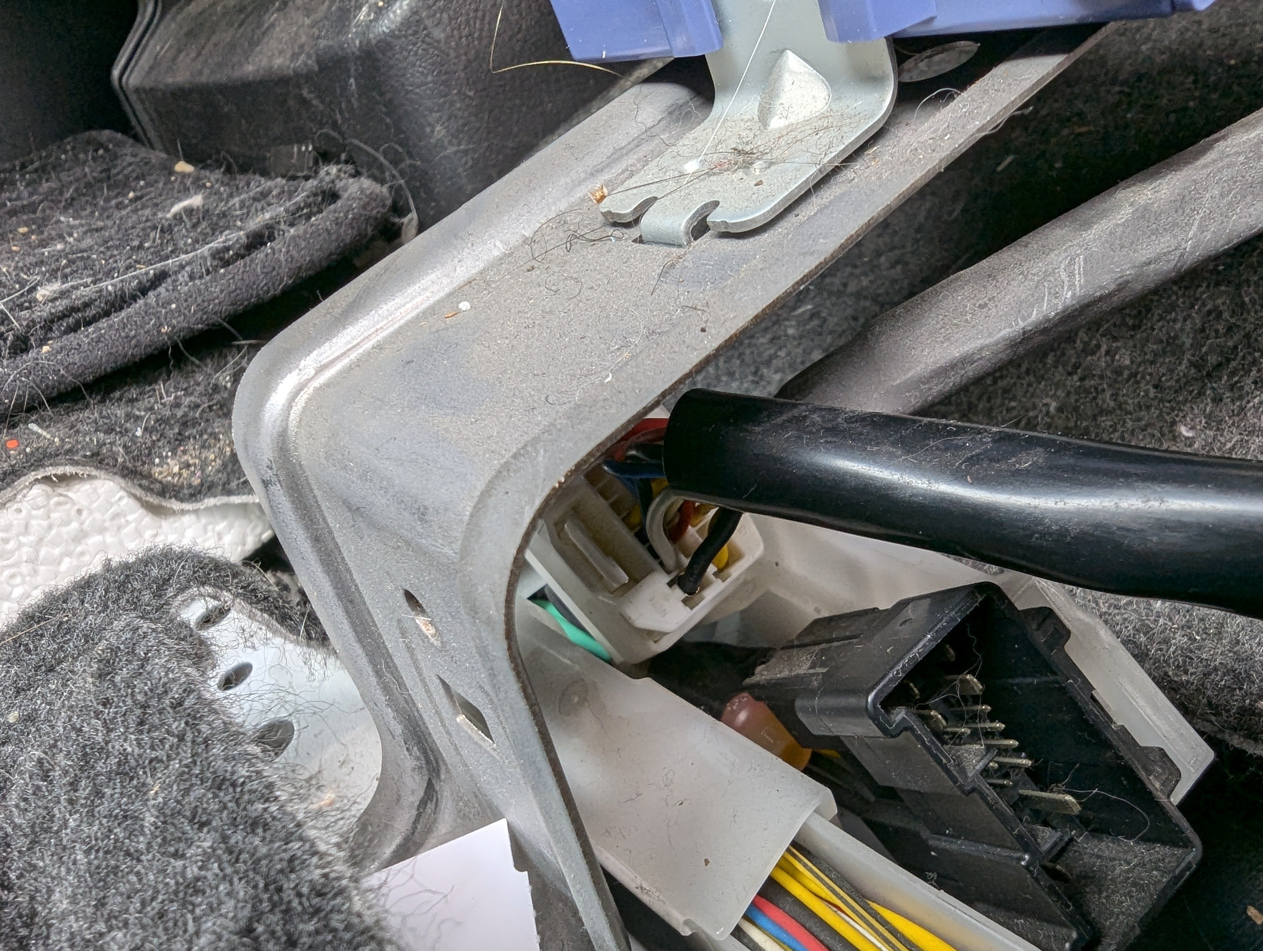

I found a cable hanging behind my head unit (a Sony aftermarket unit) that looks like somebody has cut the plug off. It looks after market with the sleeving and it has a phone connector. I followed it back to under the passenger seat where I expected it to be plugged into a box, but it connects to another connector and looks like its been tapped off an orginal cable. I know its not the reversing camera, I dont have an amp or a front camera (that I can see), so I am assuming it goes to the roof monitor that has never been working,
Can somebody confirm and if so it has 3 wires, a red, white and brown. I am assuming that it is positive, negative and acc, but could be wrong. Anyone shed any light on it and what the white plug is for.

In answer to my own question, as nobody else seems to know. The red is positive, the white and brown are negative. The white plug does not seem to do anything. Wiring the positive and negative give it power, adding a video feed shows a picture

Hi mate Brown would normally be Remote in or out depending on your roof Screen, Activated from head Unit.
 Thanks. I thought that, but I tested with 12volts and as long as white was negative, it didnt matter if you used brown or red on positive, the screen still sparked into life, so I just used two cables. It turns off when it is closed and on when you open it.
