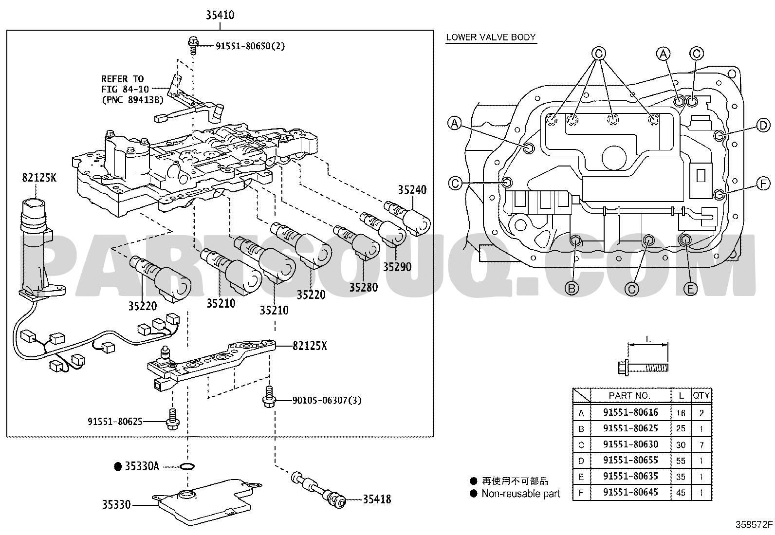

how do you remove the gearbox control module
Hi Roger, I would like to know if the gearbox control module can be
removed from the gearbox with out removing the gear box, its a 2009
Vellfire 3.5 engine, thanks Jim

thanks for the information,
I had a look at it today, and yes you can remove the gearbox control unit without removal of the gearbox,
it was quite easy, first remove battery and box remove two further brackets, then you can see the control
unit, undo the two securing bolts pull up the unit disconnect the plug and that's it, hope this post will be useful
for the forum
