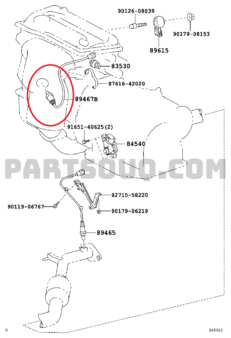

sorry delay full of man flu the front one is called a fuel ratio sensor not a lampda sensor the lampda sensor is the back/bottom one the front fuel ratio sensor is always the front one to fail i have atatched a picture and a link of where to buy one with the correct plug circled in red  https://automotive-japanese-spares.30.ekm.shop/toyota-alphard-anh10-anh15-24-front-fuel-ratio-sensor-34437-p.asp

Hope you're feeling better! Have ordered the Fuel Ratio Sensor. Thanks for the help. Regards. Tony.
