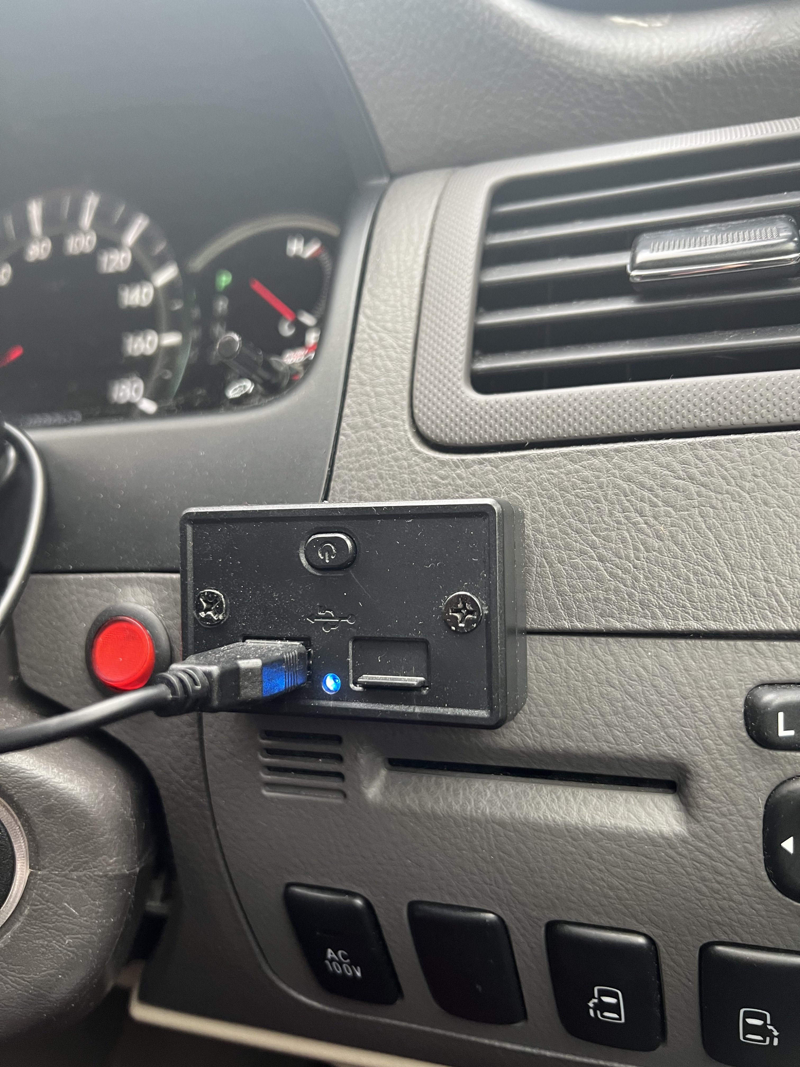

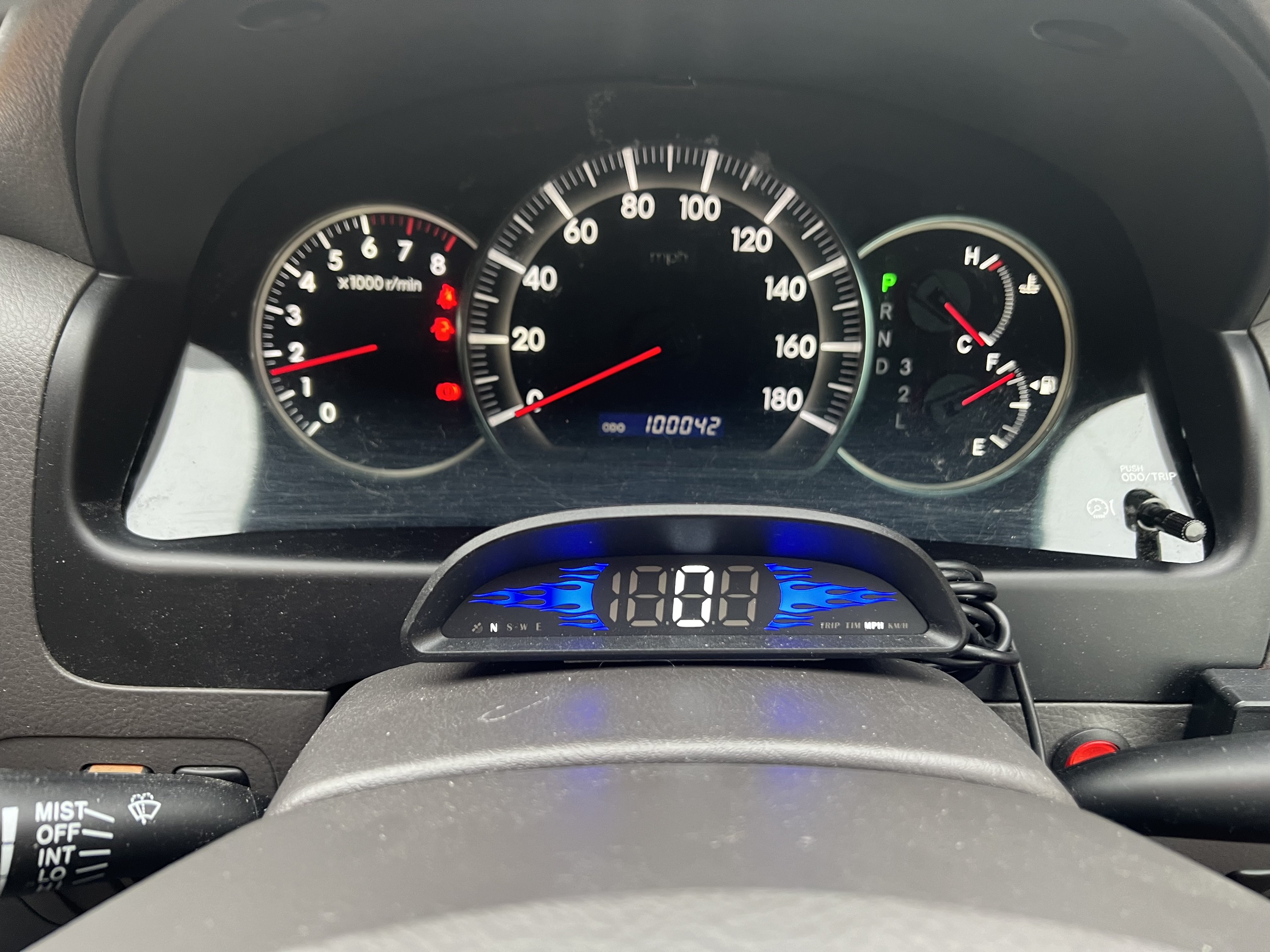

Hi, I had a similar problem and decided to remove the chip and reconnect the speedometer to read Kph. I used the power supply to the chip to wire in a USB socket into which I connected a digital GPS speedo, all from Amazon. See the pictures, it works very well and didn’t cost very much. IMG_3242.thumb.jpeg.0dd1345ff809e835c9e3e385e3411180.jpegIMG_3241.thumb.jpeg.e64aa224c772ba096fd31b6f72d1111b.jpeg
