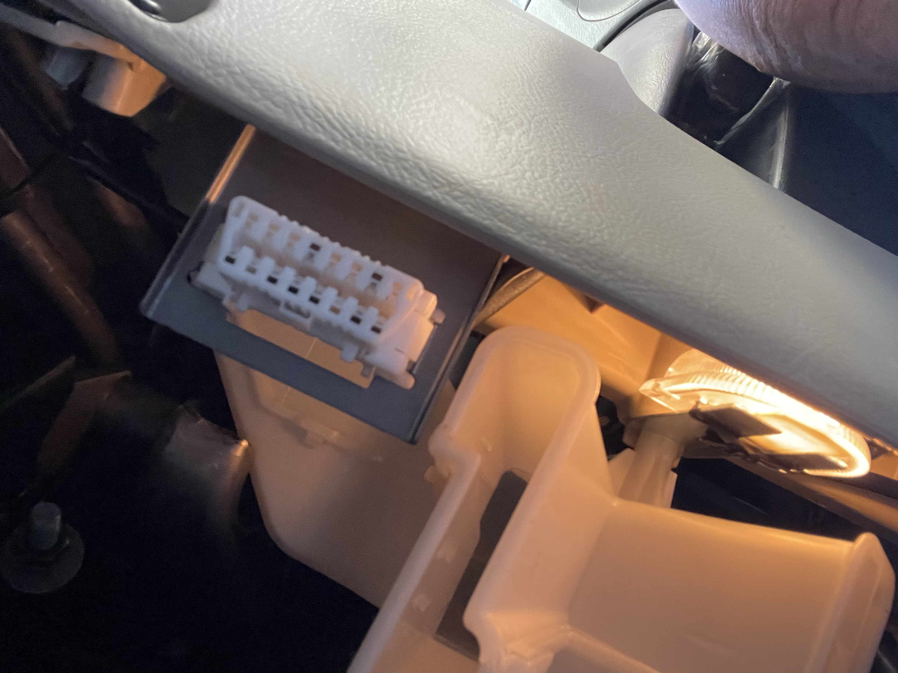

Thanks for the replies I think I'll go for the Ancel  - I take it this is the connection above the pedals
- Once I get it I'll let you know how I get onimage.thumb.png.6b4077daba15b1a46b612a8d21f5e0dd.png
