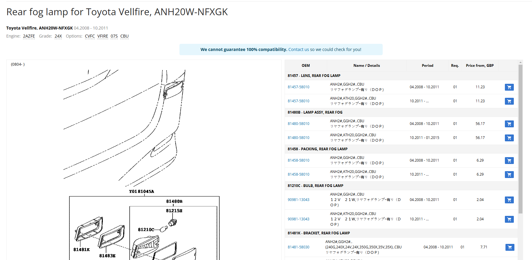

So I am one of the many people who had a reversing light changed to a fog light, with a cheap switch drilled into the dash. Its always really annoyed me.
Then I saw a post on here with a video installing a new stalk with rear fog light switch, dashboard light working and wiring a new light in replacement to the reflectors at the bottom of the bumber.
A post asking where to get to stalk came from a kind answer from a member called Gamath, taking me to Amayama.
As you do, I decided to browse the site looking what other upgrades I could go for and found a Rear Fog lamp assembly for the ANH20 Vellfire. It seams to fit at the top of the bumper where it goes up the tailgate.
There is a wealth of knowledge in this group. I wondered if anybody has seen anything like this fitted?
I've seen on a few Russian Toyota, and on the Japanese yahoo groups.
It was something i had thought of installing, for full oem, but the cost of the components and shipping were greater than the valanti retroreflectors.

 That was my thought. I thought about getting some UK replacements from another car but its the cutting holes in the bumper making them fit.
I got fog light replacements for the reflectors in the rear "bumper" panel, from Amazon for less than £20 if I remember correctly. They have two light levels so appear to be stop / tail lights but by selecting the stop light connection, they make a good fog light.
 A car on Facebook failed its MOT the other day with them because it takes away the reflector. I think it depends on the MOT tester but its a chance
Some of the fog lights available do retain the reflective element.
As far as I am aware, there is no minimum size for the reflectors so small ones suitable for motorcycles can be fitted very easily and at minimum expense.
