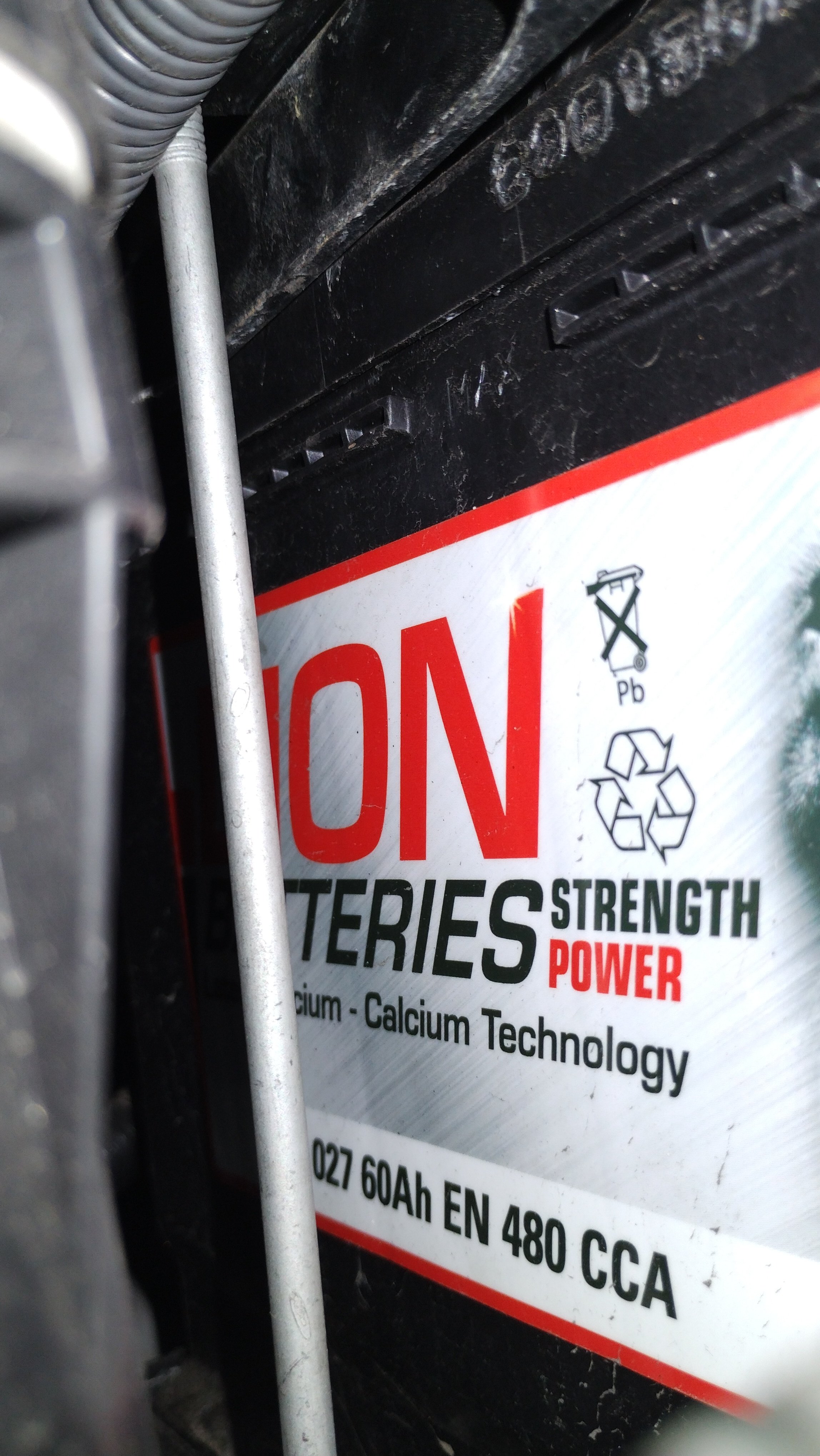

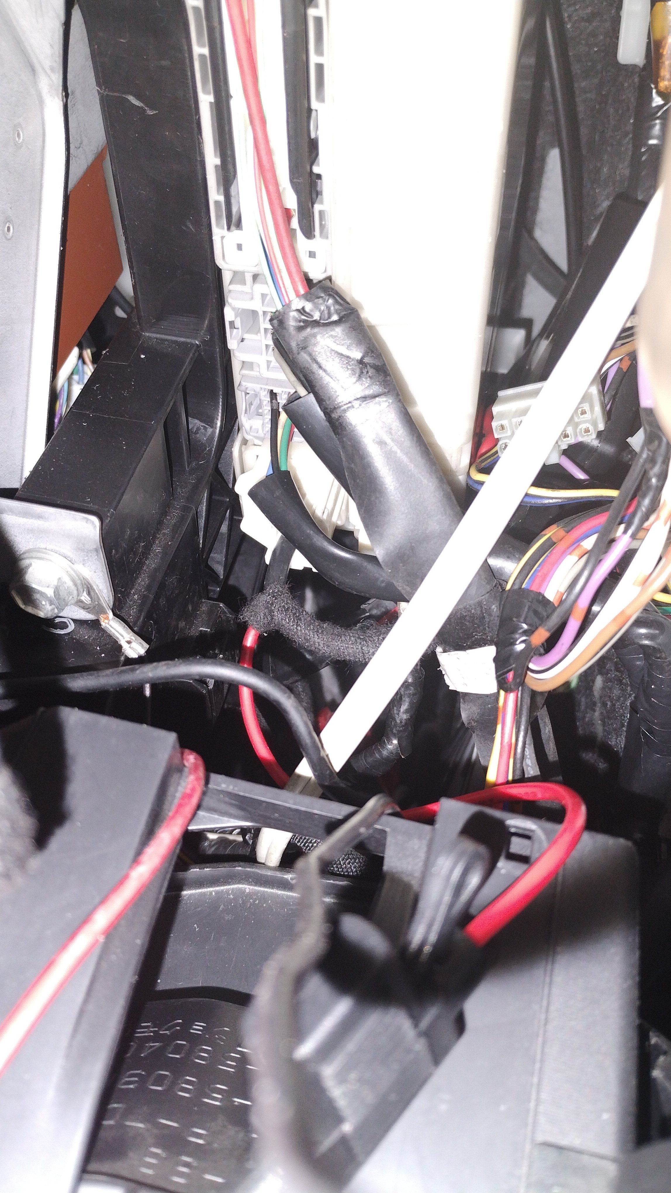

The previous owner fitted a new battery recently, but based on threads here, I think it is below spec, and there is some spliced wiring into the module in the pictures which I think is the real problem.
Does anyone know what that module in the photos is please?
And can anyone comment on whether I should try a beefier battery before I investigate wiring connections?
Photos of module and battery attached.

Hello max before you start messing with things I say this fault was known by the person you bought it off you say new battery been fitted the battery is a cheap lion battery supplied by Europe car parts they are cheap basic batteries . It’s illegal to sell any car sold as seen you got rights I personally get the person who you bought off to put things right or get your money back citizens advice will tell you your rights
Thanks Picasso. Took your advice re battery and have replaced with a Bosch one.
I've also edited the original post to remove security details, having thought about it some more overnight.
Battery has fixed the problem but long term I will have the aftermarket wiring removed by an auto electrician.
The module in question I believe is the SMART key control module. Will link resources which helped me below in case help anyone else in future.
