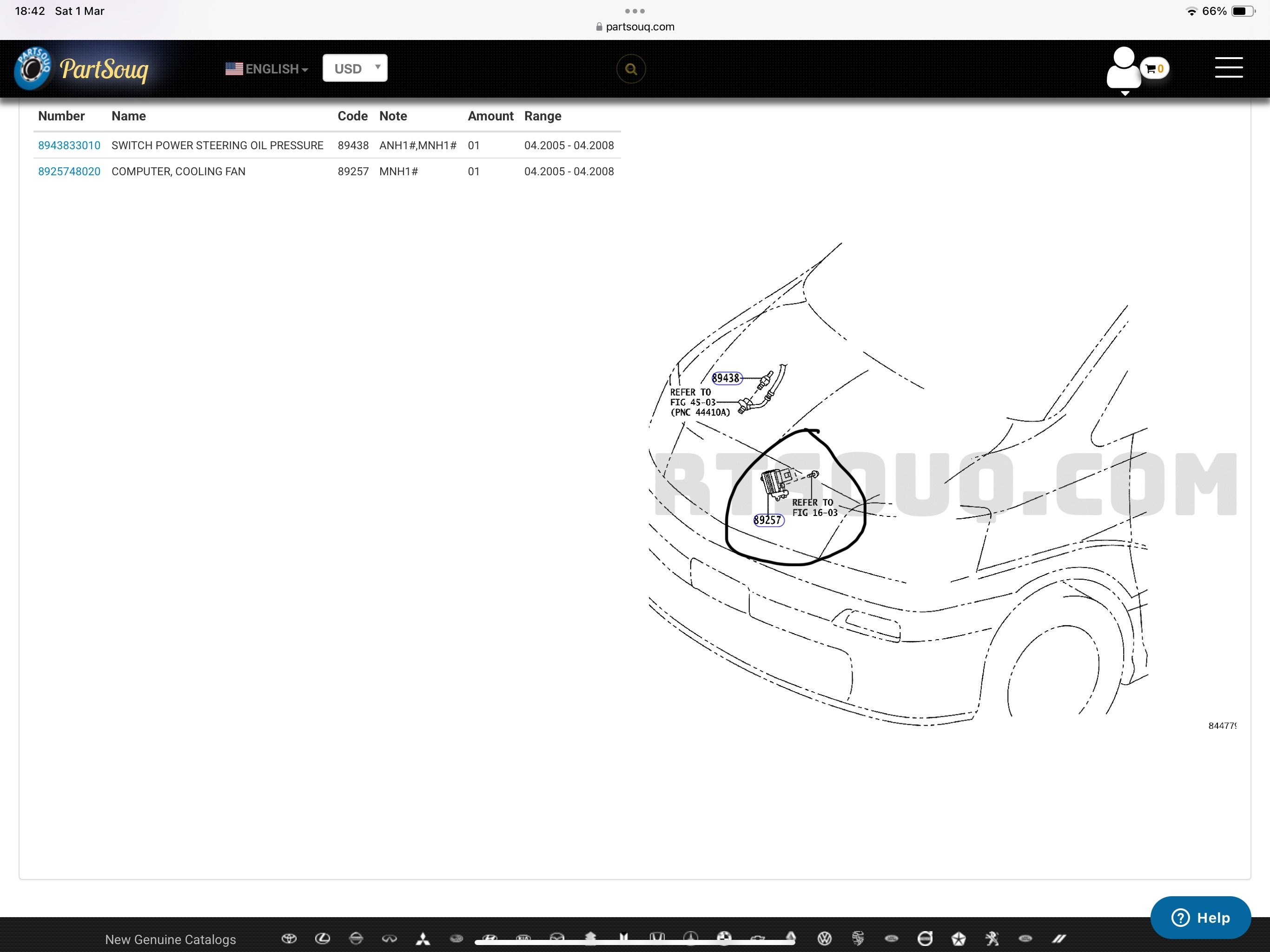

Hi everybody, I've been getting slight overheating issues with my alphard, suddenly realised this morning that my fans are not coming on, as its both of them I would guess it would be the fan controller unit, can't find one specifically for a 3 liter so just throwing it out there does anybody know if it differs between models?  They all look identical, however always best to ask if somebody knows!

Hello Simon picture attached circled of module Toyota part no. 8925730070    Check out this link   https://www.aliexpress.com/item/1005007739244280.html?spm=a2g0o.productlist.main.1.70aa4aJx4aJxTQ&algo_pvid=84f29220-0593-474c-8dba-f3c2abfa368b&algo_exp_id=84f29220-0593-474c-8dba-f3c2abfa368b-0&pdp_ext_f={"order"%3A"1"%2C"eval"%3A"1"}&pdp_npi=4%40dis!GBP!15.19!15.19!!!135.47!135.47!%40!12000042044877078!sea!UK!1606916510!ABX&curPageLogUid=aVUc4AJxid9J&utparam-url=scene%3Asearch|query_from%3A    Before placing the module make sure the fans move freely by hand because if they are seized they will blow the module I personally would replace the coolant  tempature sensor first as this tells the ecu when to switch the fans on
