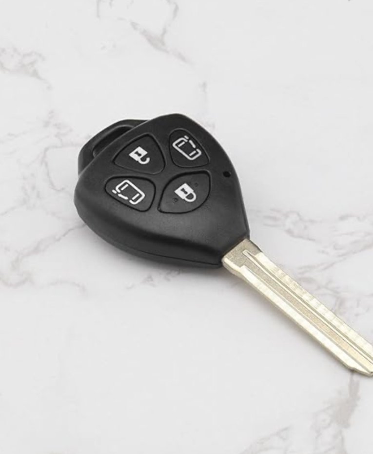

I have a 2006 Gen 1 facelifted Alphard.
I have a couple of keys, a Toyota 4 button one and a lookalike generic 4 button one, (see pic). On my drivers door handle and the tailgate there is a small black button which I think may require a smart fob (see pic) in order to unlock as at present they do not respond when pressed. Would I be correct in my assumption?
All 4 buttons on the key work for unlocking all and both side doors as both mine are powered.

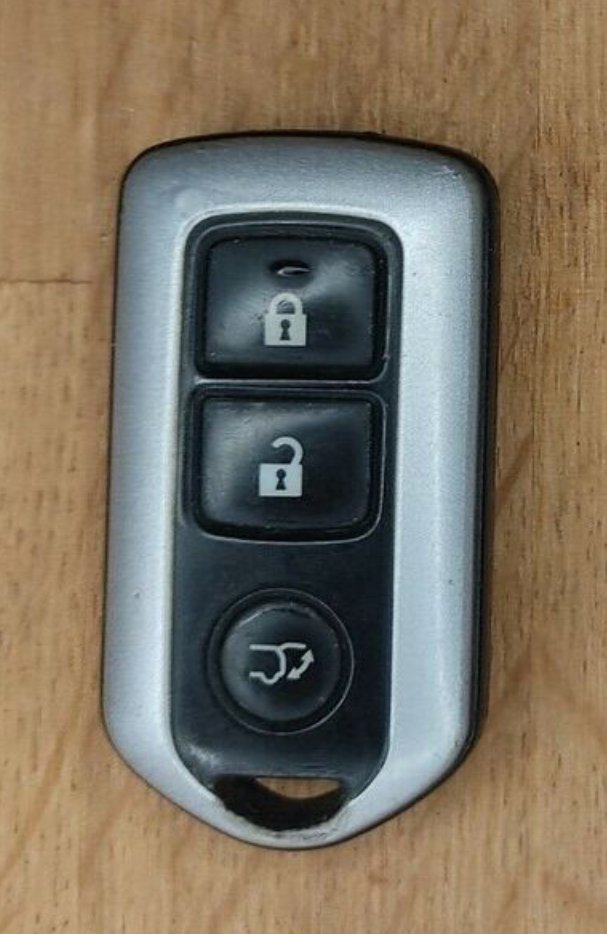

For the smart locking to work, that 3 button key will need to be near the door.
As you walk away the doors should lock.
As far as I am aware (see below), those small buttons you refer to are receivers; they are not push buttons (but I could be wrong on this as I have never tried to use them).
There is a larger button on the lower edge of the tailgate, inside, which should function to close the hatch.
I have the same keys as you do, but only use the 4 button as my daily key.
Indeed, my daily set do not even have the four keys, or internals, present.
I used the smart key for locking and unlocking.
You do have the drivers door 'lock' switch enabled ?
Of course, the 4 key unit is used in the ignition as it contains the immobiliser key.

I just tried my 'buttons'; one the driver's door and the one on the tailgate.
Both depress slightly, and beep quietly.
The driver's one does seem to activate some locking/unlocking mechanism audibly, but nothing seems to change.
Whether there is a programmable function, or not, I don't know.
Neither button opens the door or tailgate.
Please bear in mind that I have the smart fob very close to the door/tailgate.
