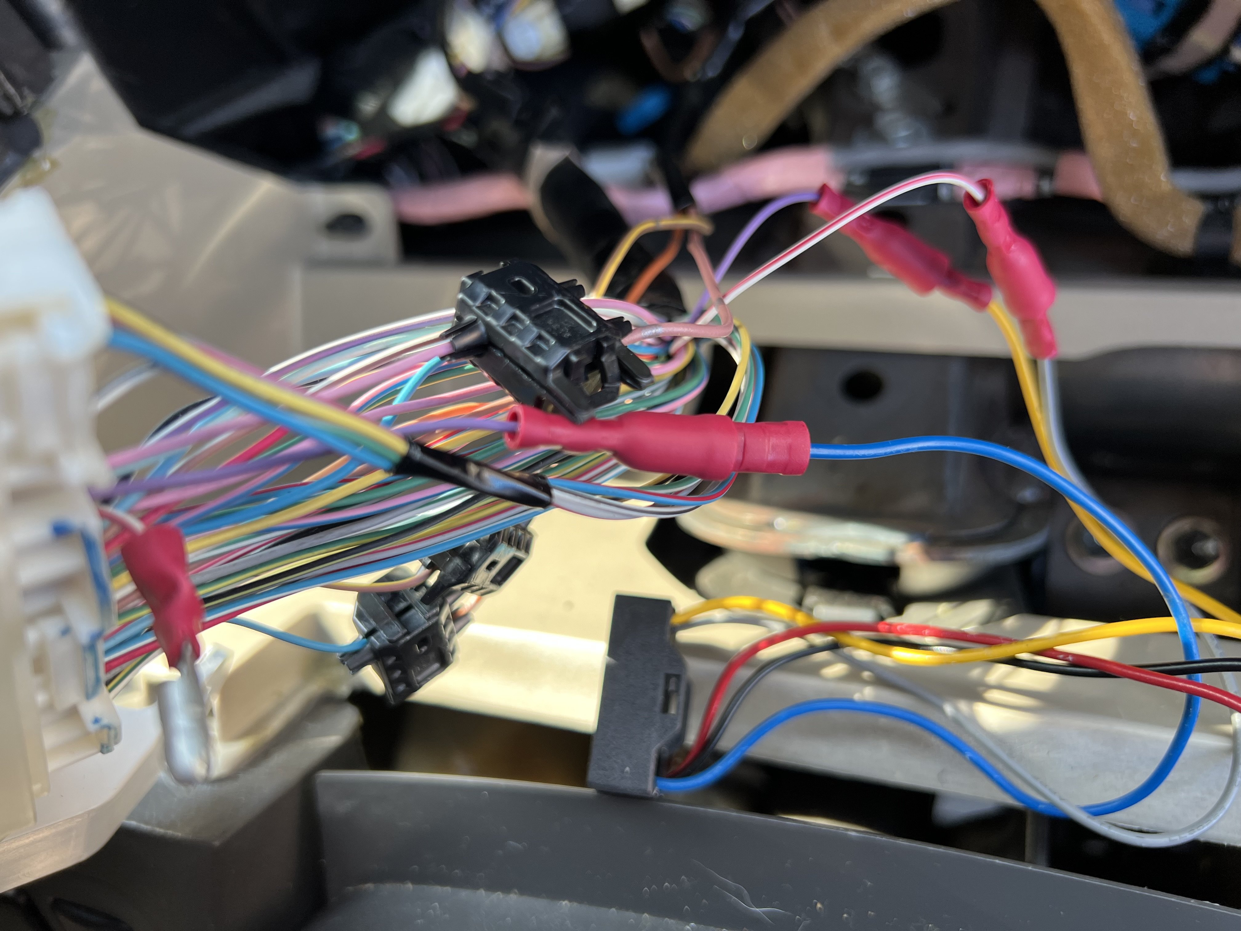

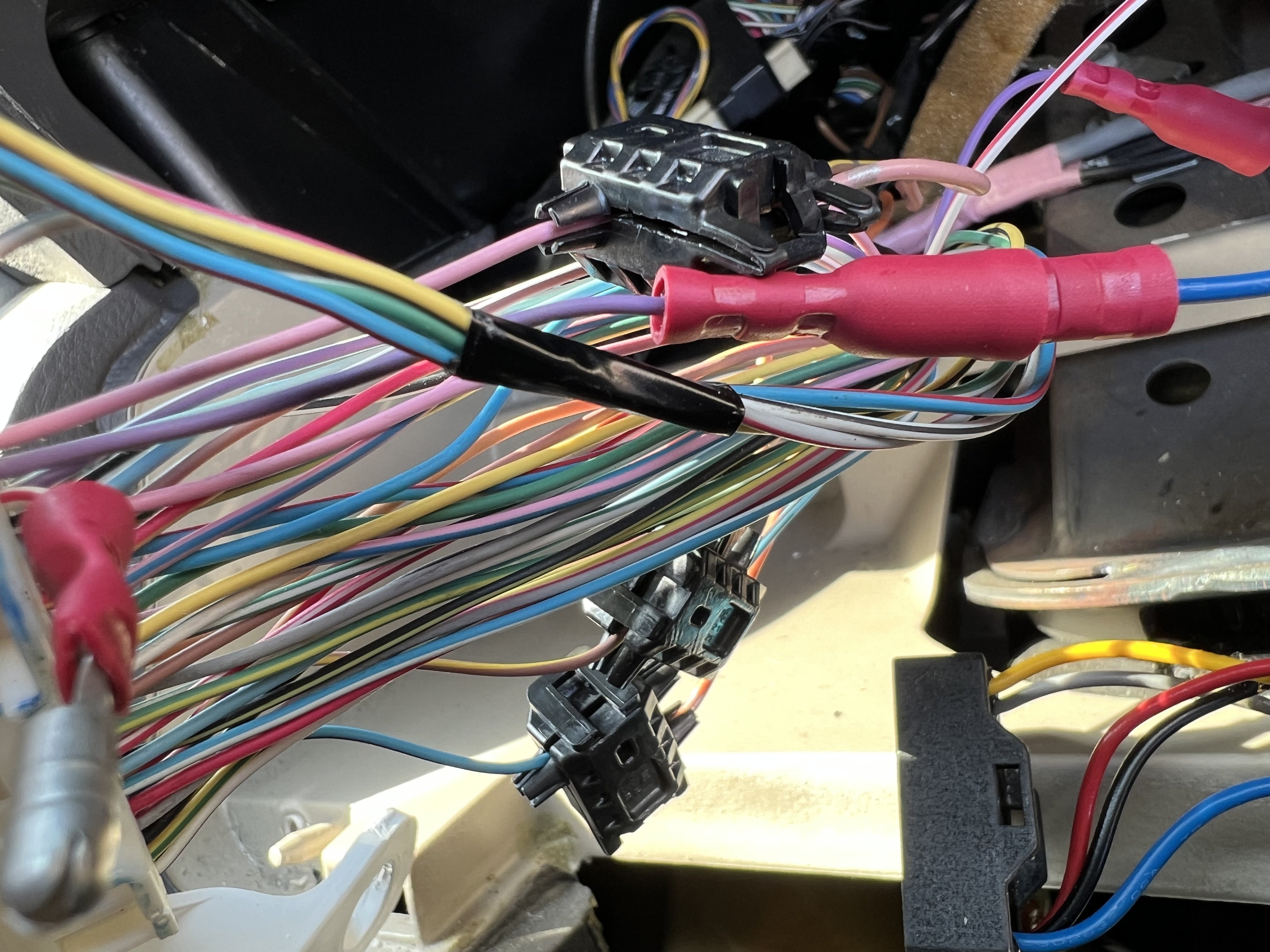

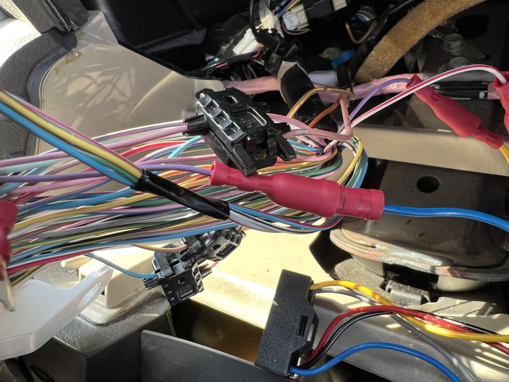

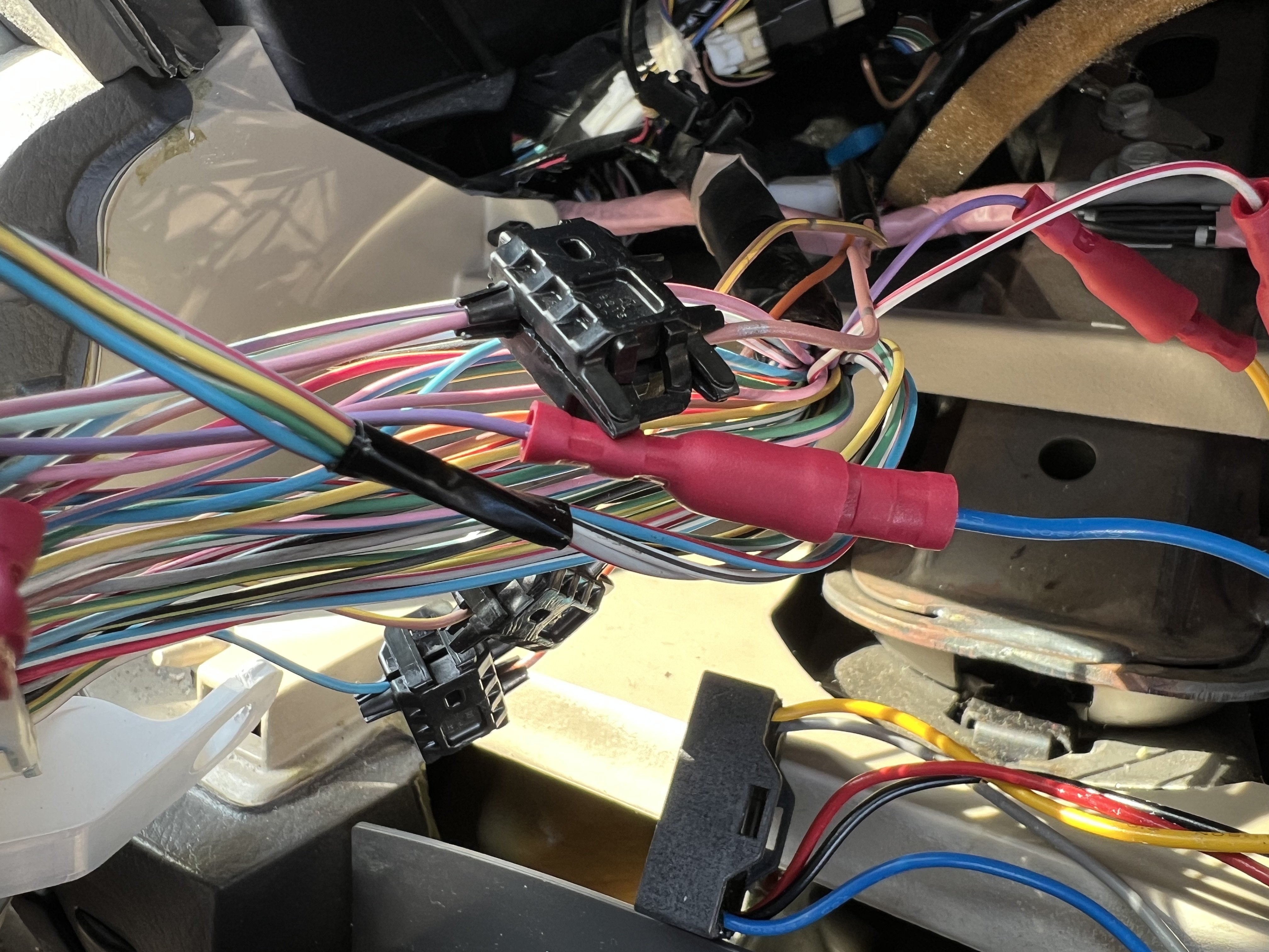

Hi Abbot, I had a problem with my speedo chip and eventually removed it, installed a GPS digital mph speed instead and reinstated the kph speedo.
However, I took some photos of the wiring just in case I needed to replace the chip which I’ve attached in case useful for you.
