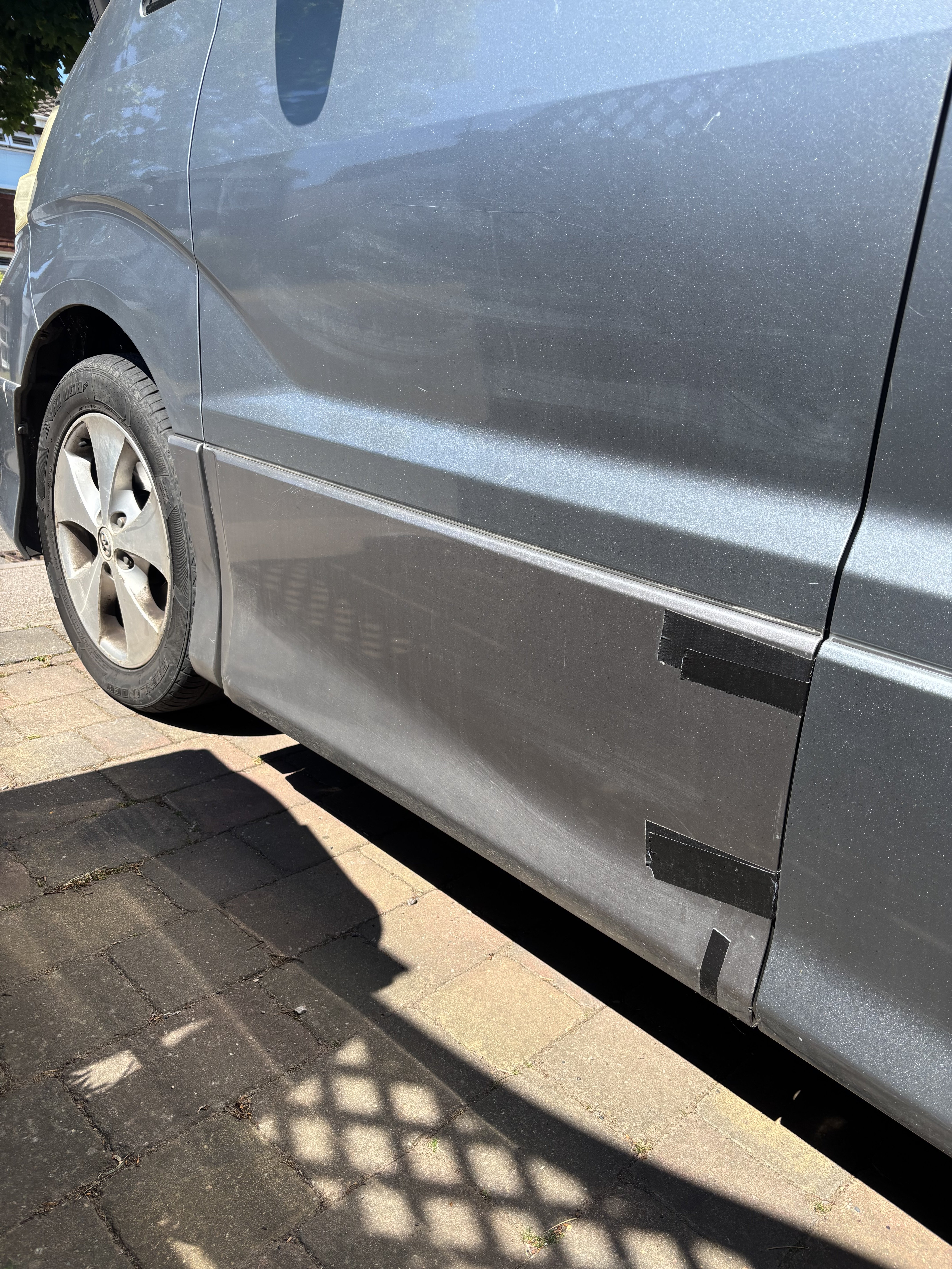

Hi, I’m a very non-technical Alphard Camper owner- so excuse me if the terms aren’t right :). The lower panel on the passenger side front door has come loose. It looks like a couple of the screws or clips are missing. Can anyone point me to the right place in UK to get these? I assume it’s an easy job our garage could do to secure it? I’ve taped it secure for time being.

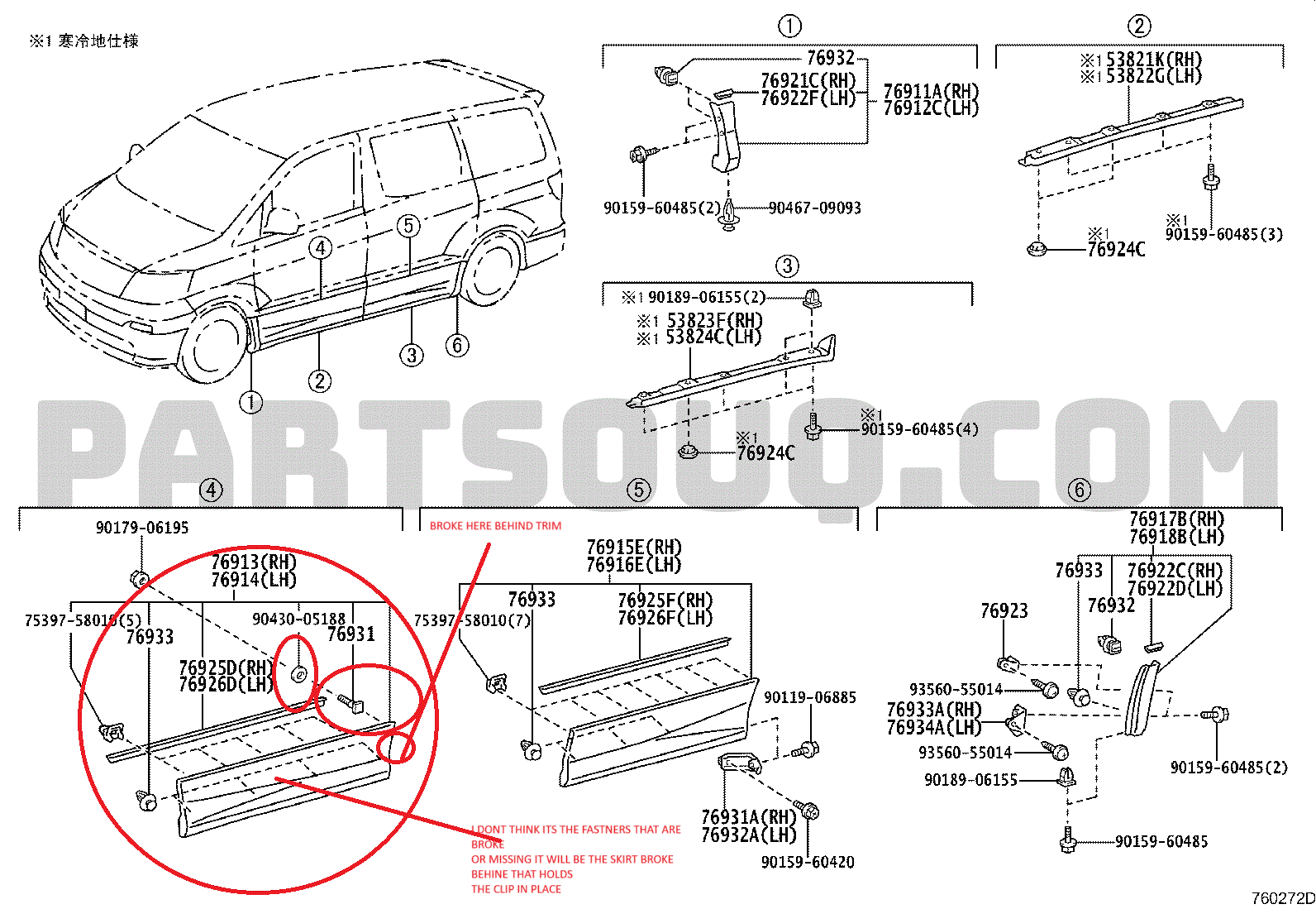

Hello Amy as promissed i have atatched a drawing from lookup system circled in red and discription added i think you will find it wont be the clips missing but the clip holder in the back of the skirt broken the retainers are now not avalible through toyota uk as i have a freind in toyota parts and tried for you i do have part no.s please check this linkin japan for prices i use this companty a lot and they are good for genuine parts and so do a lot of members on the forum .
https://www.amayama.com/en/part/toyota/9017906195
