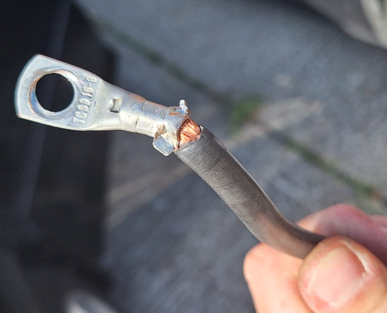

If you have a Sugoi Campers (south coast) converted van, like us, as Keith Bishop once said, "word of warning"...Get your electricals checked out, seriously...
I've just spent the afternoon pulling out some horrors which means I'm now in a rush to reharness all of this before an upcoming trip, so I'm seriously unimpressed. Yes this is partially venting but also it's safety related info and I gather they converted a few Alphards (and Elgrands) down here.
Some highlights:
  • A completely unfused 16mm2 live wire, straight from the leisure battery, no conduit, running down the full length of left hand side of the van through several steel bulkheads. A survivable side impact could very easily have shorted this and burnt the van to the ground.
  • The leisure battery ground cable was 16mm2 when the total load for the leisure circuits was 210A. This should have been 35mm2 minimum. Again, burning the thing to the ground is a very achievable outcome here. In a way they knew this needed to be more, as the outgoing live cables were a 16mm2 and a 25mm2. "Black cables aren't dangerous" clearly.
  • The 1.5kW inverter input cables terminated with thumb screws, that were...thumb tight...
Maybe we got unlucky but we had many issues with their work (not just electricals - lots more body and mechanical issues that I'm restraining myself from "just moaning about") which we made clear, and duly returned it for rework many times, up until they went...into...liquidation...I rather hope they've tweaked their workshop practices somewhat in the new conversion company I'm super excited to see they've started...
