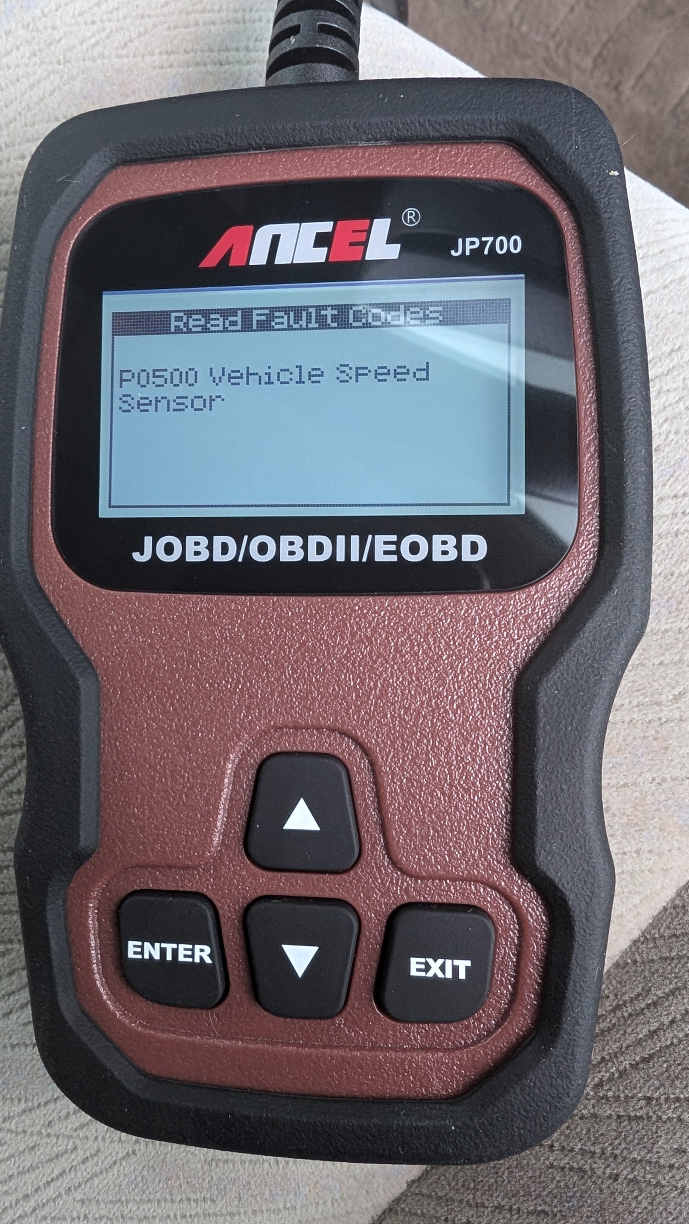

Help!!! My hybrid brings up an EMF fault once it goes over 20mph, code relates to a speed sensor fault but my local garage who are hybrid specialists and generally very good are struggling to get any information, they believe the fault may be a gearbox speed sensor but access is restricted, the fault only appeared when I changed the head unit but not sure it's related, anyone got any ideas or information that may help, car drives exactly as it did before the fault occurred.

DTC P0500 is a vehicle speed fault, not a gearbox speed sensor issue. Gearbox speed sensor faults are DTC P1820 and P1825.

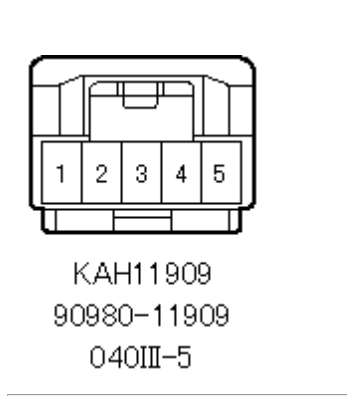

As the issue occured after installing your new head unit I would look at the speed signal wire to that. Grey connector, pin 3, violet colour
Hi, I have this problem on my 3.0L 2007 Alphard and its been driving me mad!!!  What and where is that connector in your post.  Grateful for any help.
This is a connector on the head unit that feeds in the vehicle speed. Note this is for a 2.4 10 series hybrid , your wiring will probably be different.
