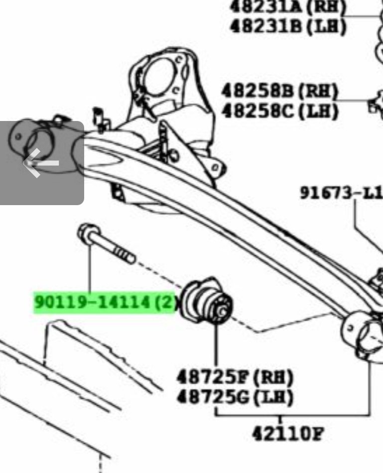

Imw87 Posted July 14 Posted July 14 (edited) Evening All, I'm in need of some help if possible. My car has just failed it's MOT on the rear axle sub frame bushes and bolts. I've managed to find the bushes ok. But I can't find anywhere in the UK that stocks the bolts. Amayama have the bolts listed under 9011914114. Does anyone possibly know of another bolts part numbers that would fit? Edited July 14 by Imw87 Poor spelling
Picasso Posted July 14 Posted July 14 Welcome Ian you got the correct part no. Have you tried your local Toyota dealer

Picasso Posted July 15 Posted July 15 ian just got a price from toyota they are just under £15.00 + vat a side including the nut the nut no. is 9017914045 avalalible a couple of days so take your no.s to toyota
