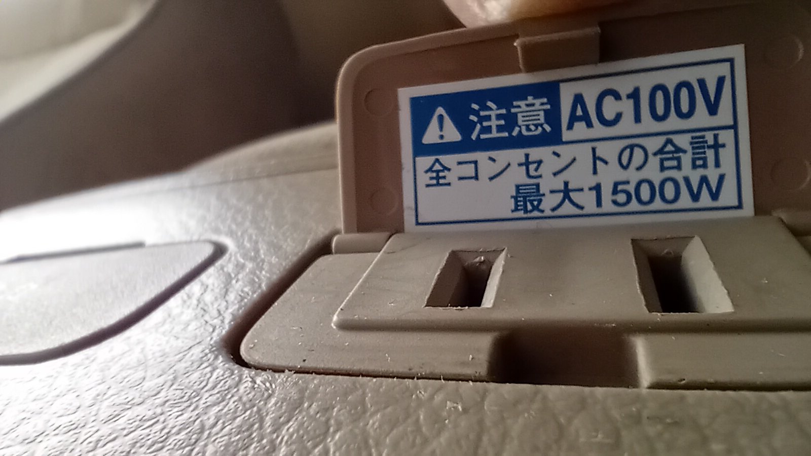

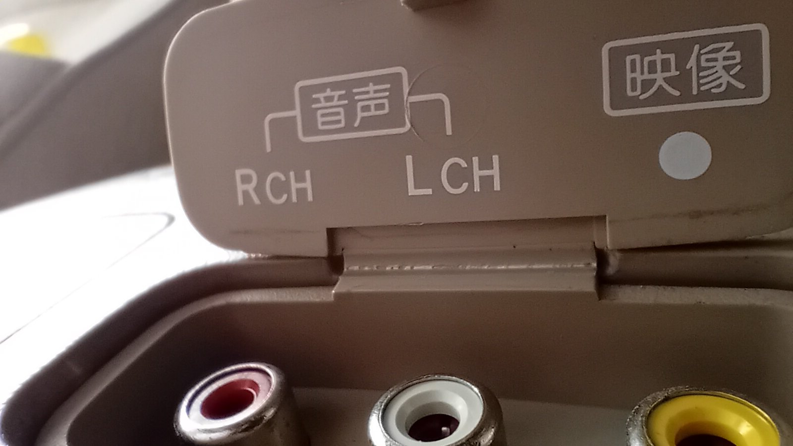

 Can anyone tell me what these are for and how to use them many thanks

The upper one is a power take off, the lower one an audio/video input to your head unit.
Can you explain further pls I have no idea what a power take off is ,or a head unit ,sorry not good with stuff like this at all

I am not a hybrid owner so cannot really speak to this.
You can draw power from your hybrid battery, but beyond that I cannot advise with any authority.
On the audio/video input you should be able to input a signal to the head-unit / entertainment system, albeit an analogue signal.
Power output sockets are 110v ac 1500w max, american style 2 pin plug. To use engine must be on, READY light on, 110v select push button,  to the right of the steering wheel, push in and the advisory light in the switch will light. Use a continental adaptor to charge phone, laptop, air fryer, induction hob etc with regard to max power and voltage applicable.
I had this issue in my Vellfire. Bought a multi plug extension lead with a US plug on it off eBay. Worked great!
