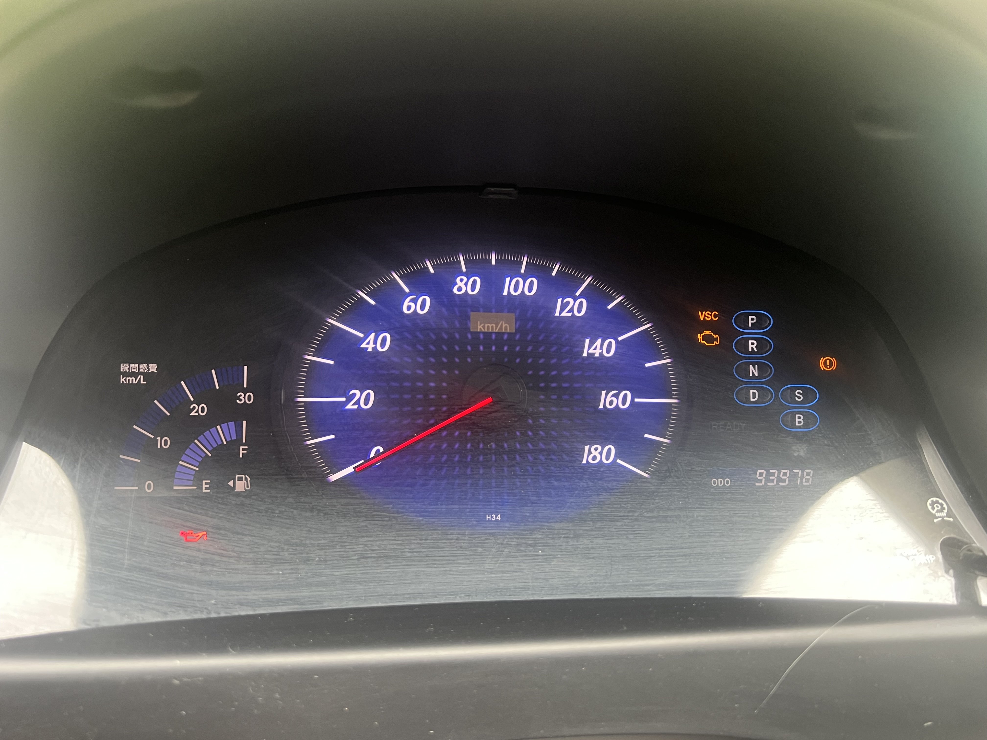

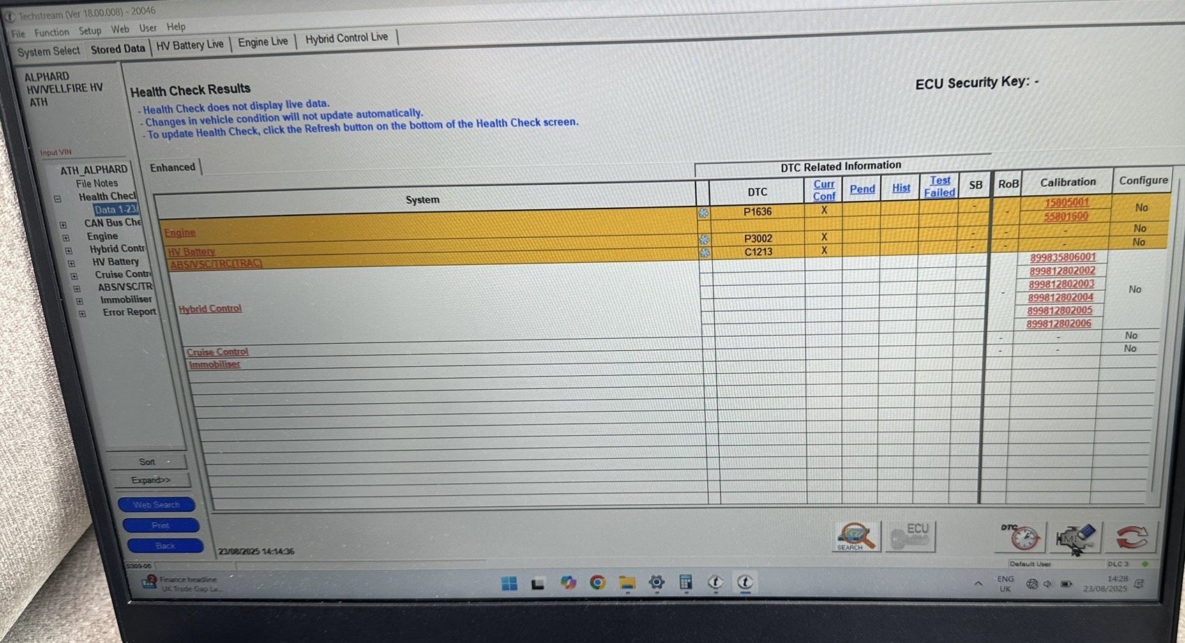

the attached are what the dash shows. Yes you can hear the clicking relays when it is trying to start. I think the ecu is detecting a problem and going into safe mode. I assume something is getting wet and drying as eventually restarts and runs fine.

dont have fault codes to hand but will get them and post them.

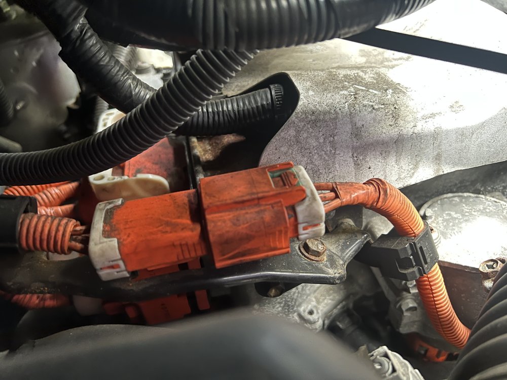

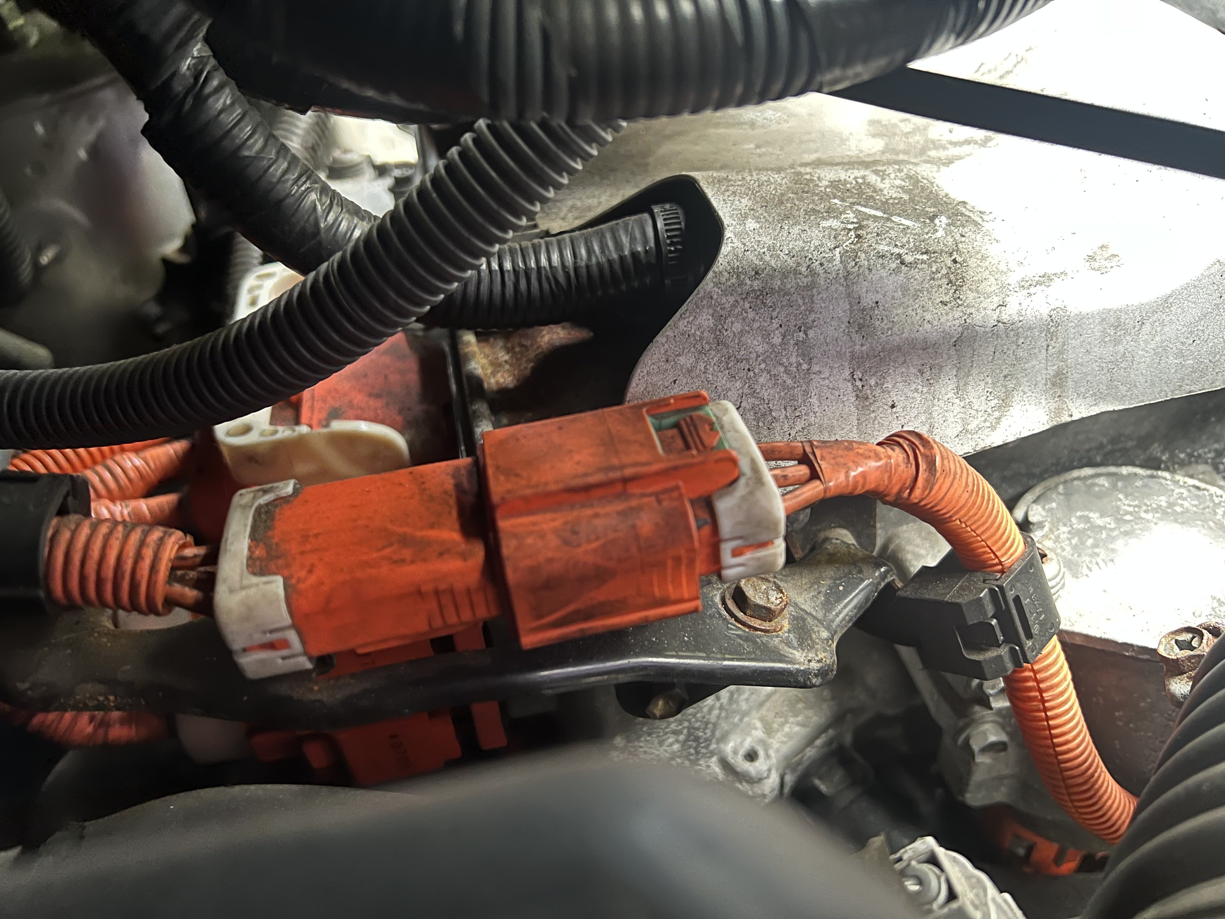

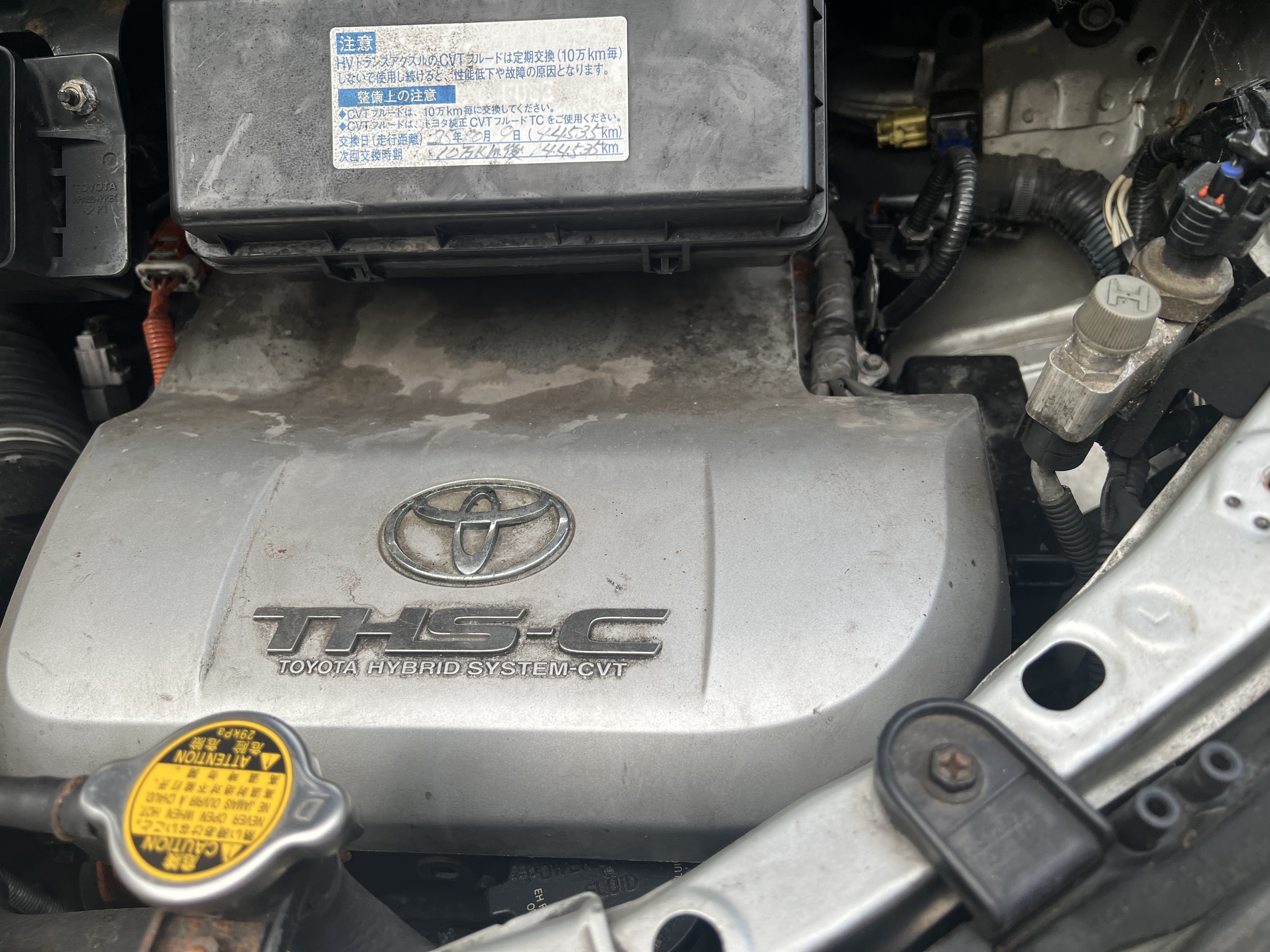

Hi there just wondered if you have checked under the silver plastic cover on the right hand side of the engine compartment? THS-C is written on it.
Pull it up from the front and lift out.
Underneath is a series of electrical wiring connectors you may have some water/moisture contamination? Give them a spray of WD40 it might help?
Thanks Shaggy I will give it a go.

C1213 - The skid control computer communicates with the hybrid control computer and controls the braking force in coordination with the motor regenerative operation.
Reception or transmission to or from the hybrid control computer is not possible. Check the sub code on the data page, could be 152, 153 or 154.
This is not necessary a fault, if there is an issue with the hybrid system it stops talking to the other systems.
P1636/81 When communication from the Engine Control Computer with the hybrid vehicle control computer is lost
Possible issues - Wire Harness or Connector or computers
P3002 - When an error occurs in communication from the hybrid vehicle computer to the battery computer ASSY
Hybrid Vehicle Computer
Battery computer assembly

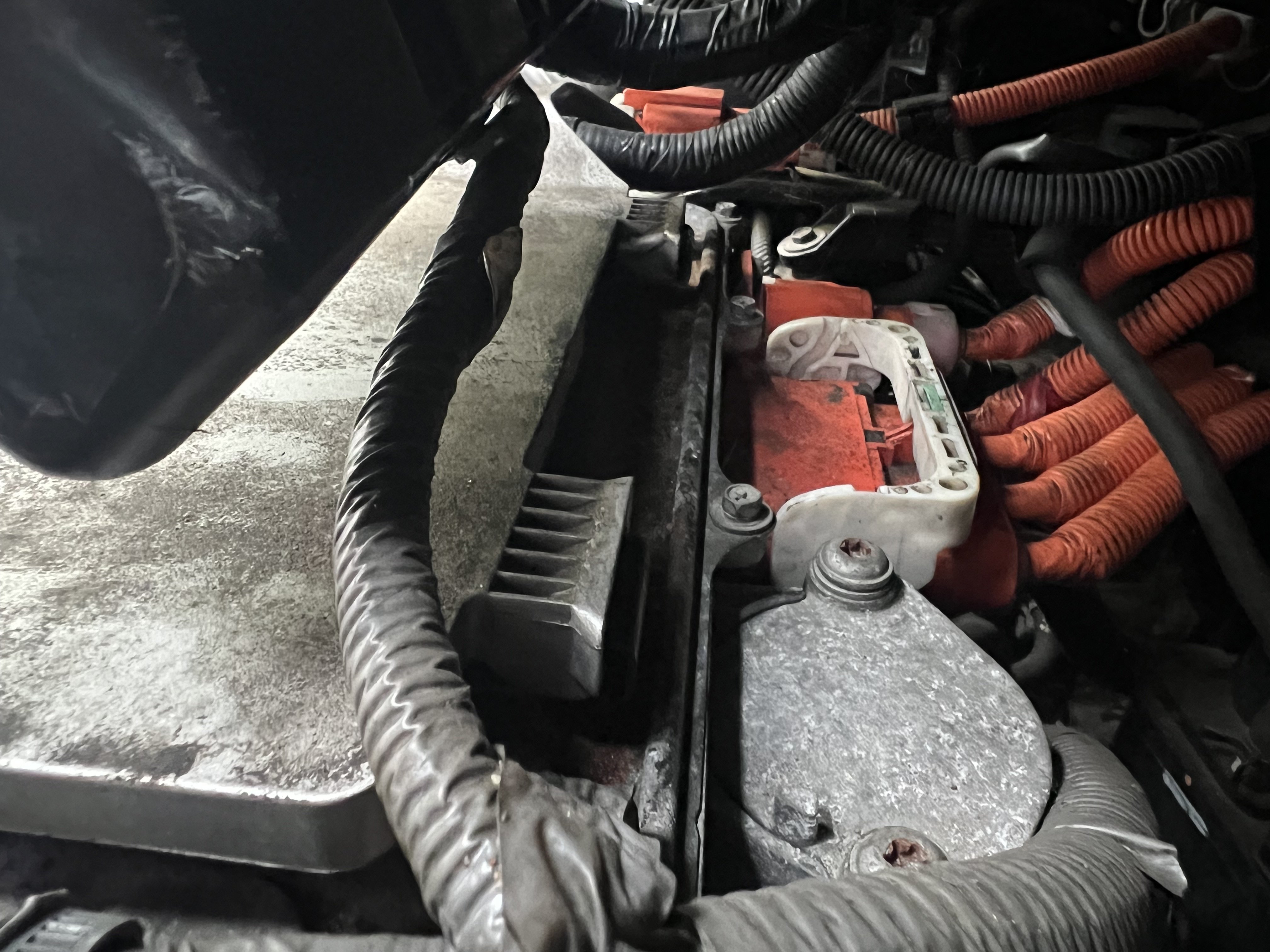

As the hybrid computer seems to be the common issue I would check all the connectors and harnesses on both the ECU, hybrid computer and battery ECU for damage and water ingress. ECU's are located behind the passenger stowage box and the battery ECU under the passenger seat, connector accessible behind forward trim.
I can give you the connectors and relevant pins to check for continuity of each harness.
Interestingly on P3002 fault diagnosis the first check is to "Stop operation of all aftermarket vehicle products or electrical products brought into the vehicle." then check if the fault code reappears. attached images are for P3002.

I found the positive connector was loose when it failed (something I wasn’t expecting as it was newly back from the garage).
