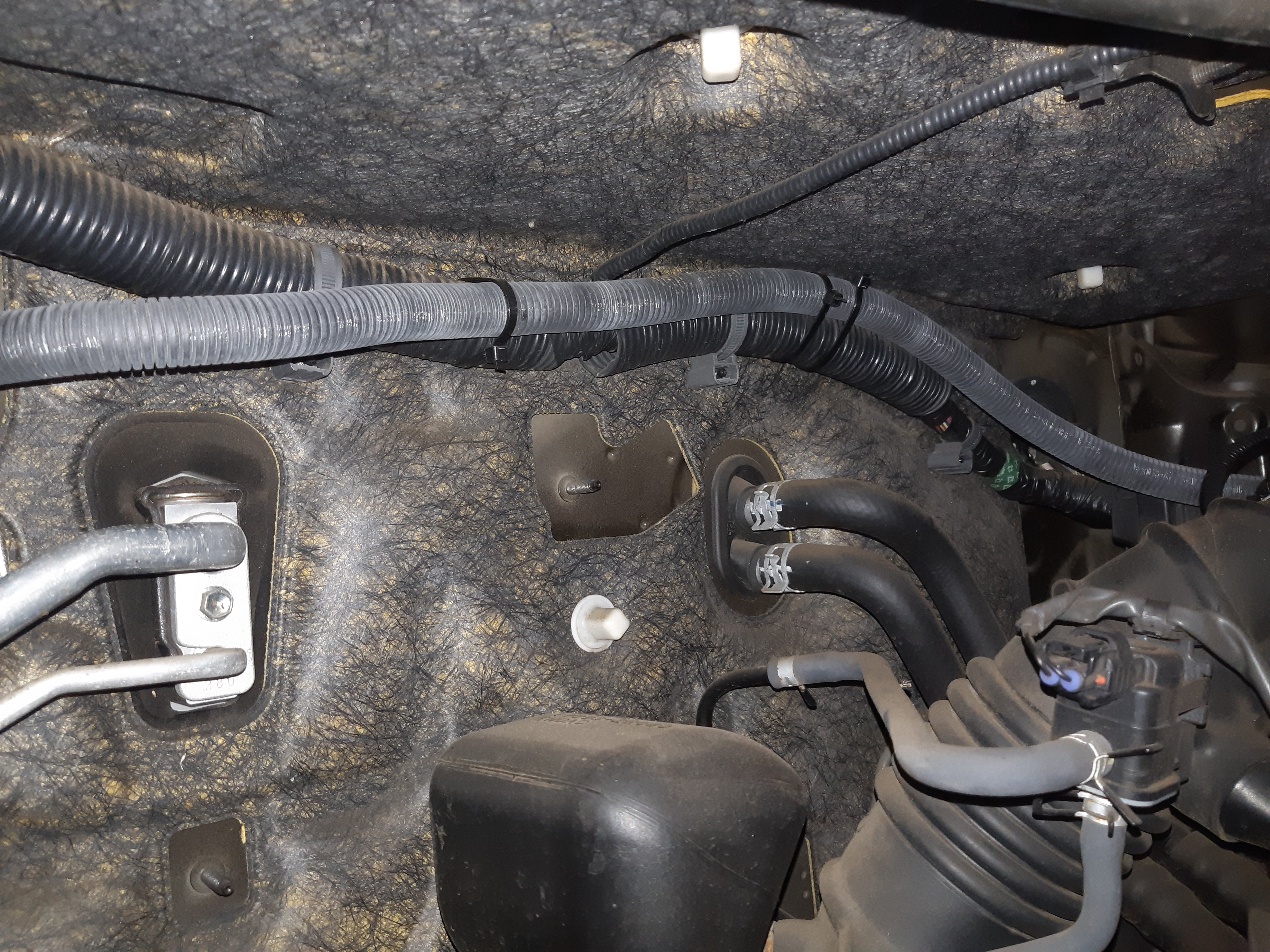

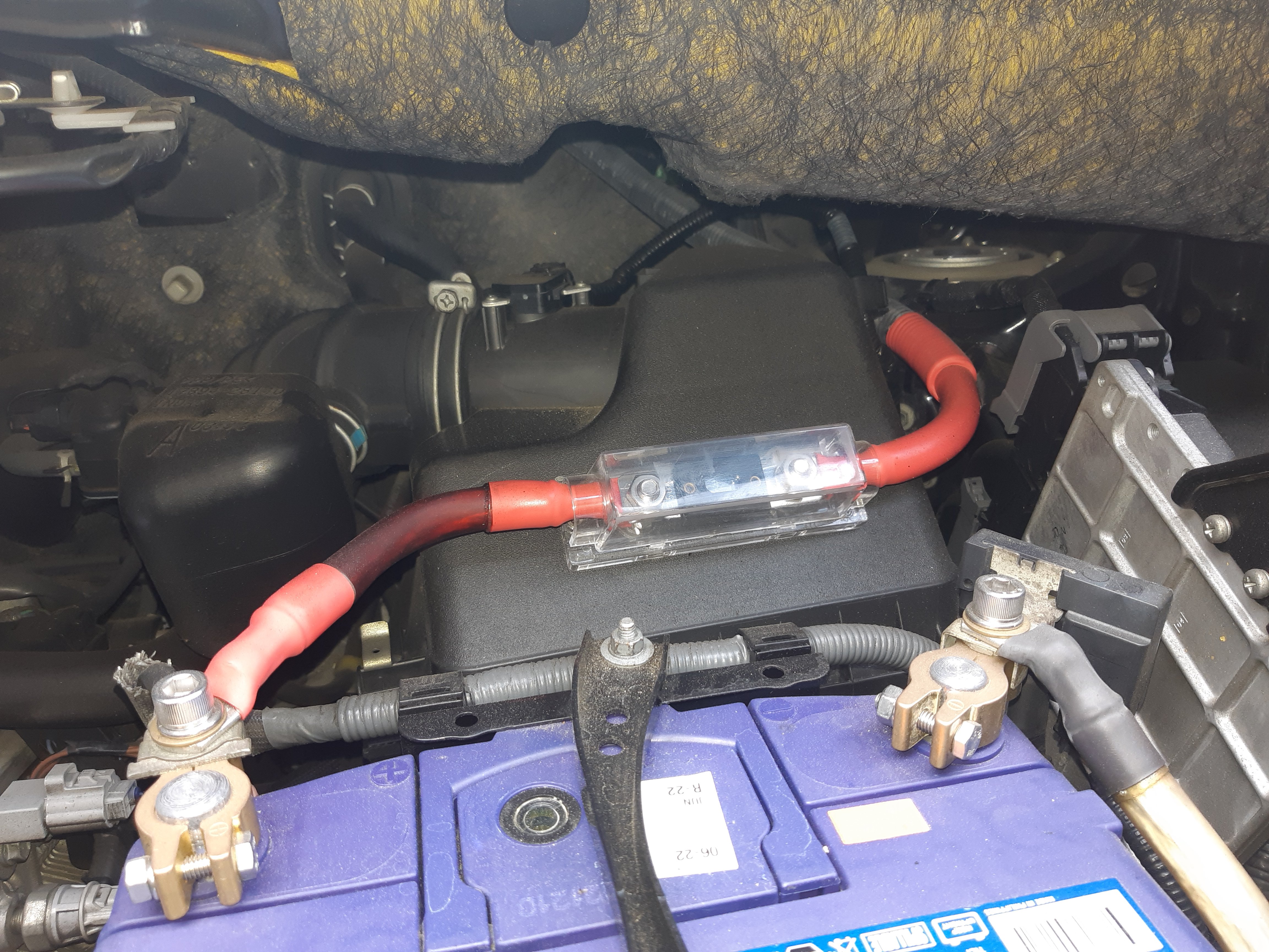

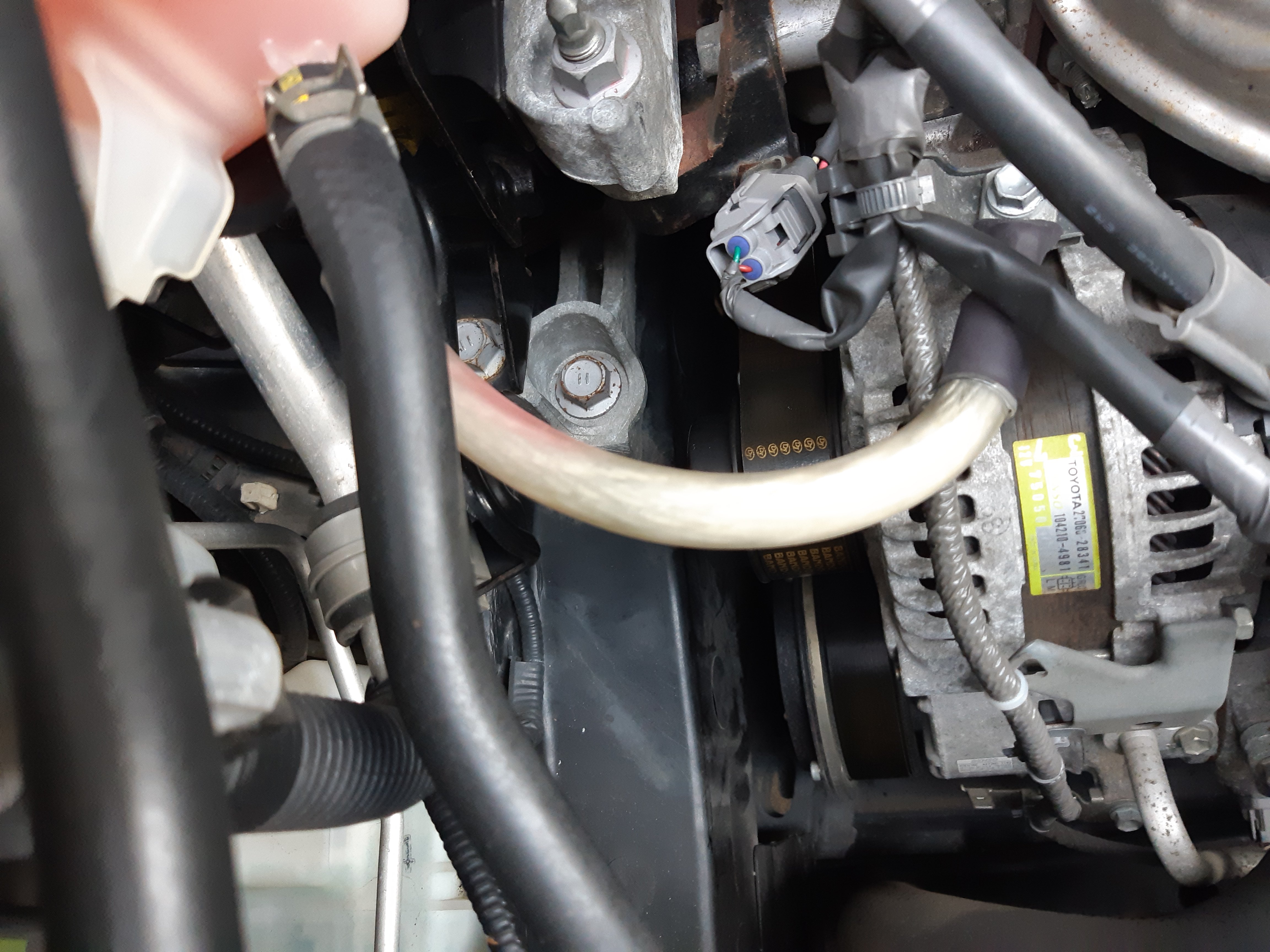

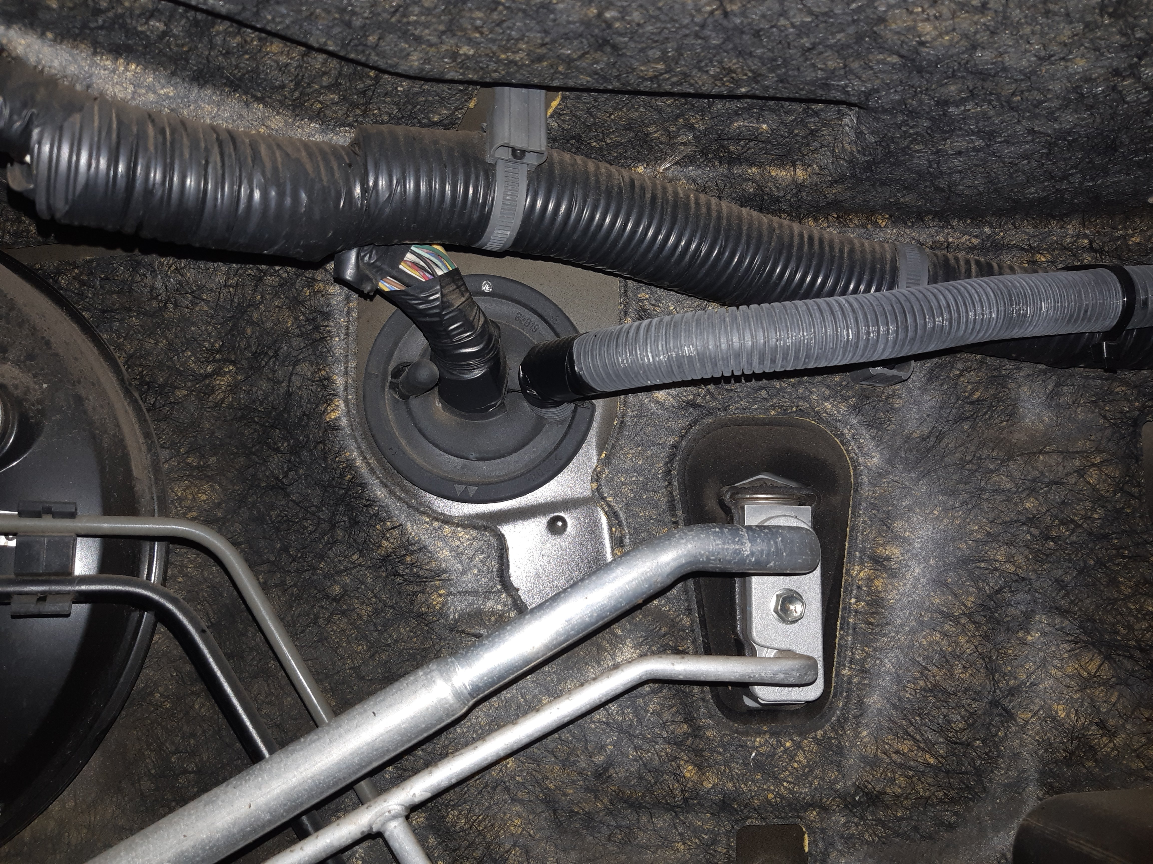

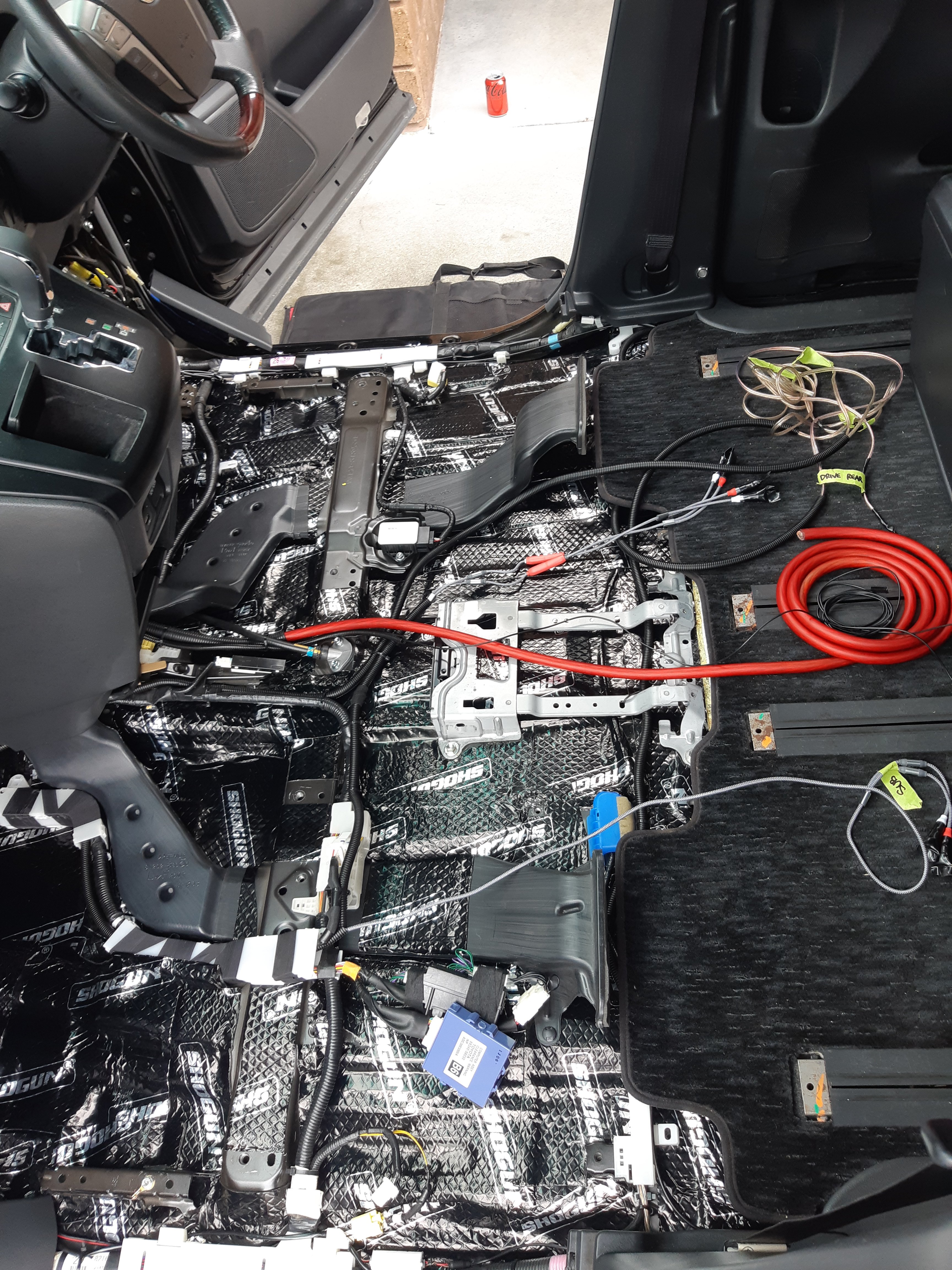

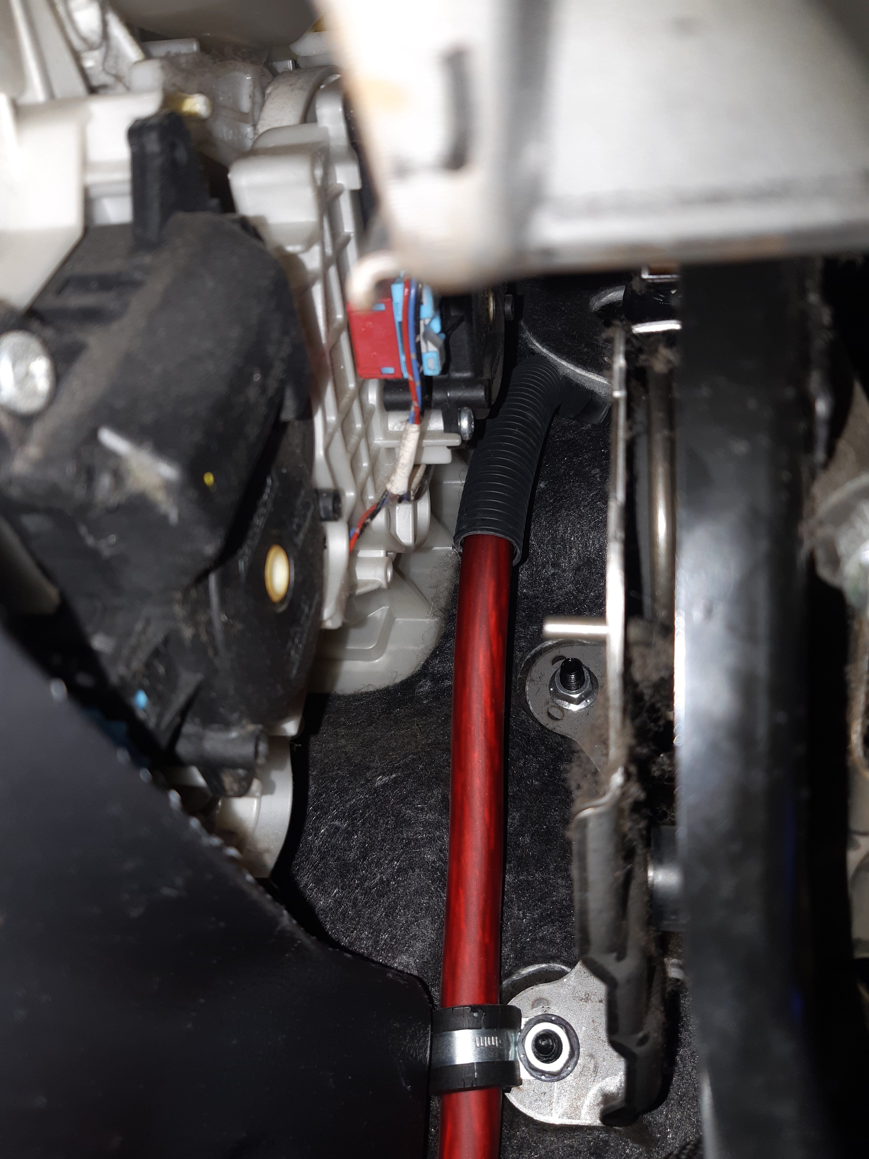

Hi Yusuf this is how i ran my power cable, there is a smaller grommet in the Firewall which gives you access to behind the Glove box also.
