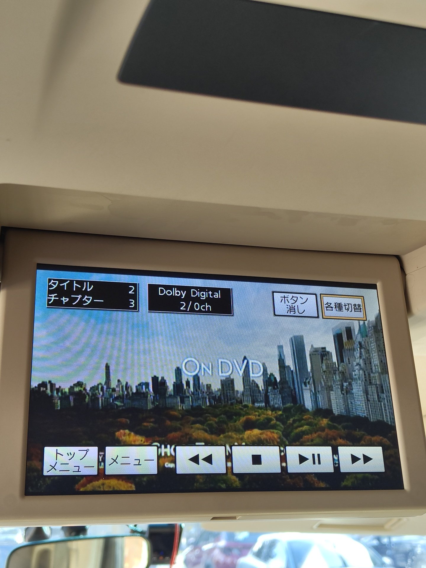

The dual button on the rear screen allows you to have separate source between the front seats and the rear, including splitting the audio so the front 8 speakers are used for phone call, radio/music, and the rear 10 for the dvd etc.
Your interface is slightly different to mine,, but there should be an option on the headunit to select video source

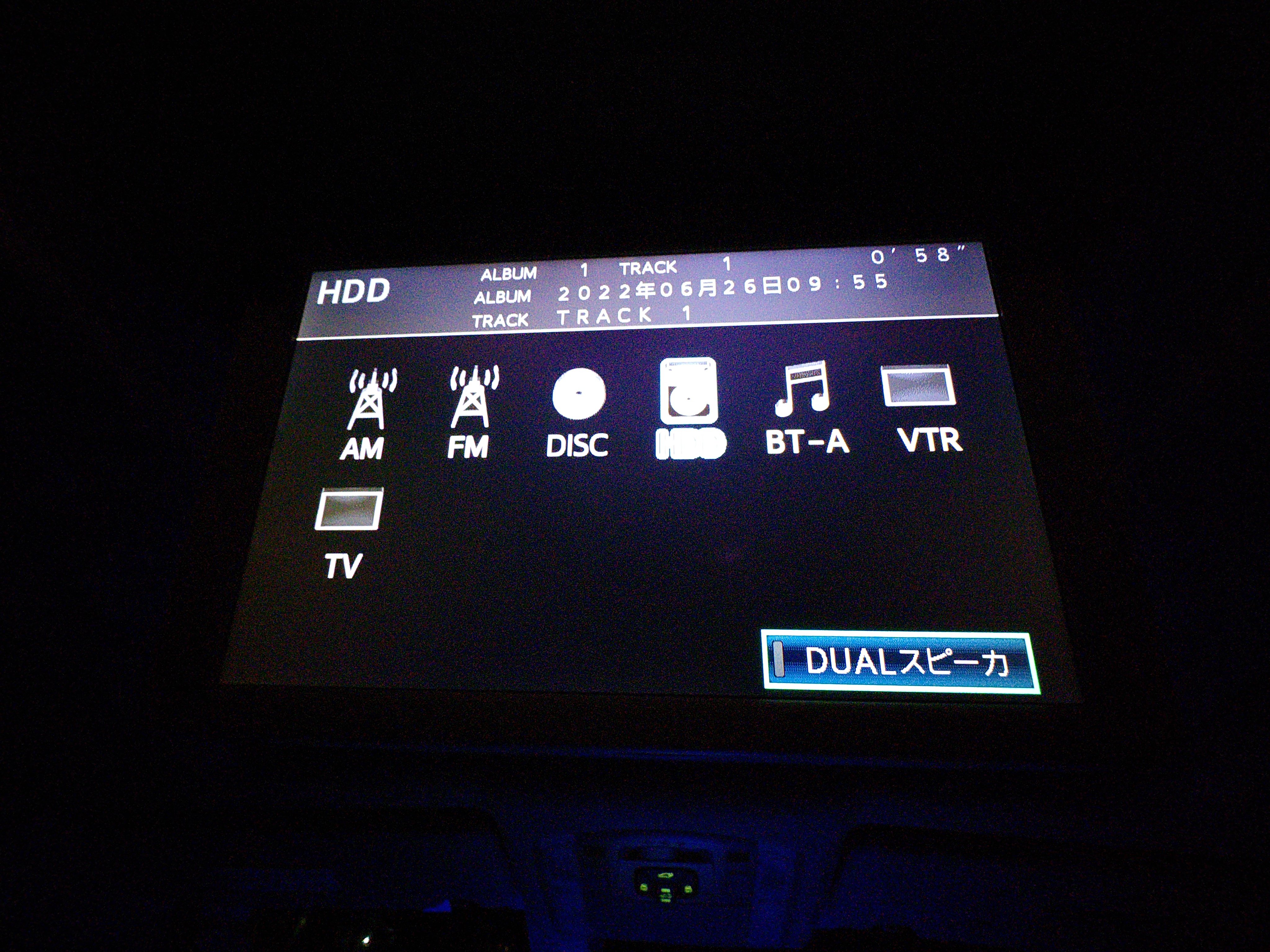

It's not the head unit I have the issue with it's the rear screen, I can't get it to display the DVD.

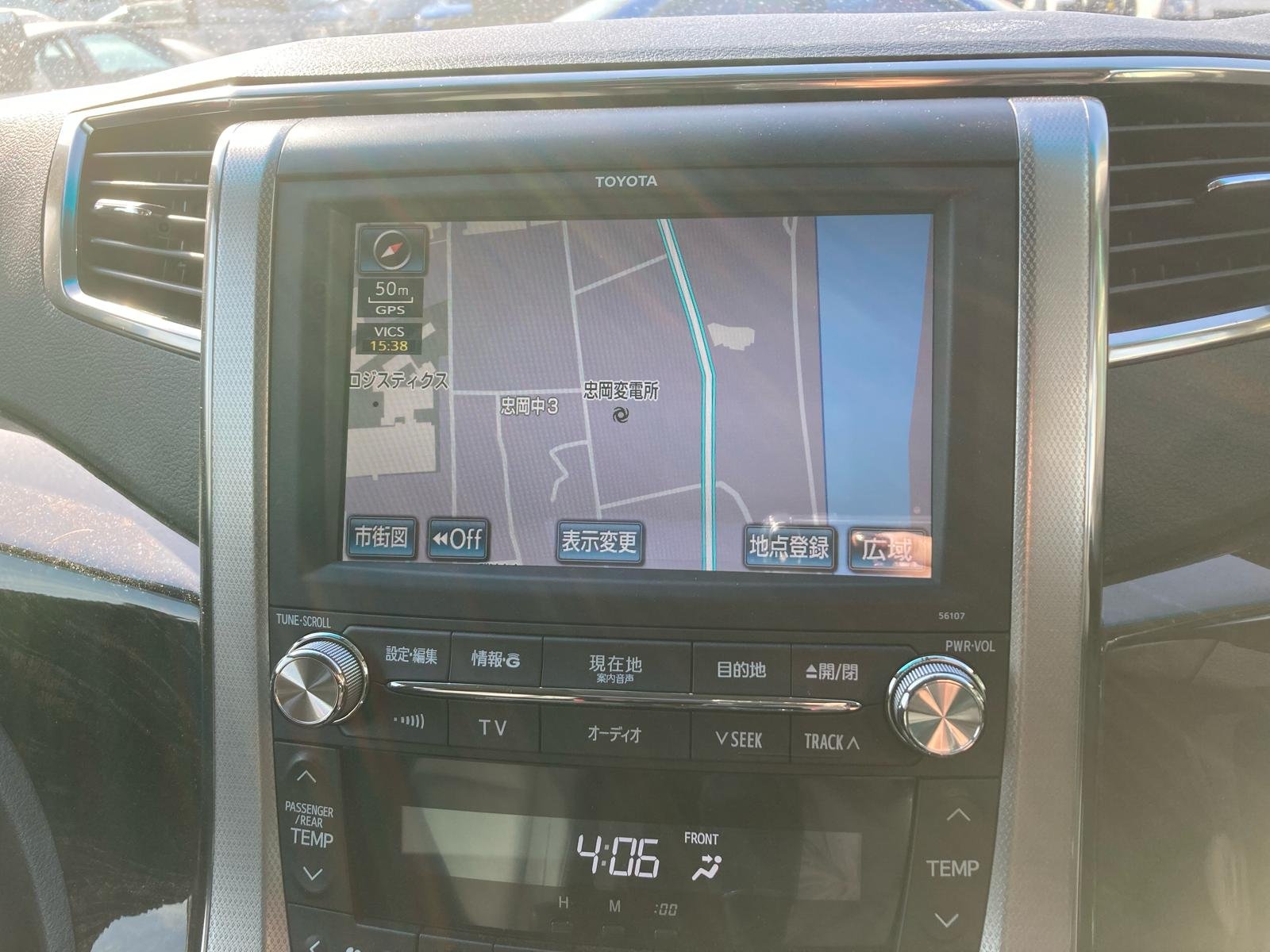

In the image, you have it set to hdd, which is the internal harddrive that stores mp3 chips of music cds you insert into headunit

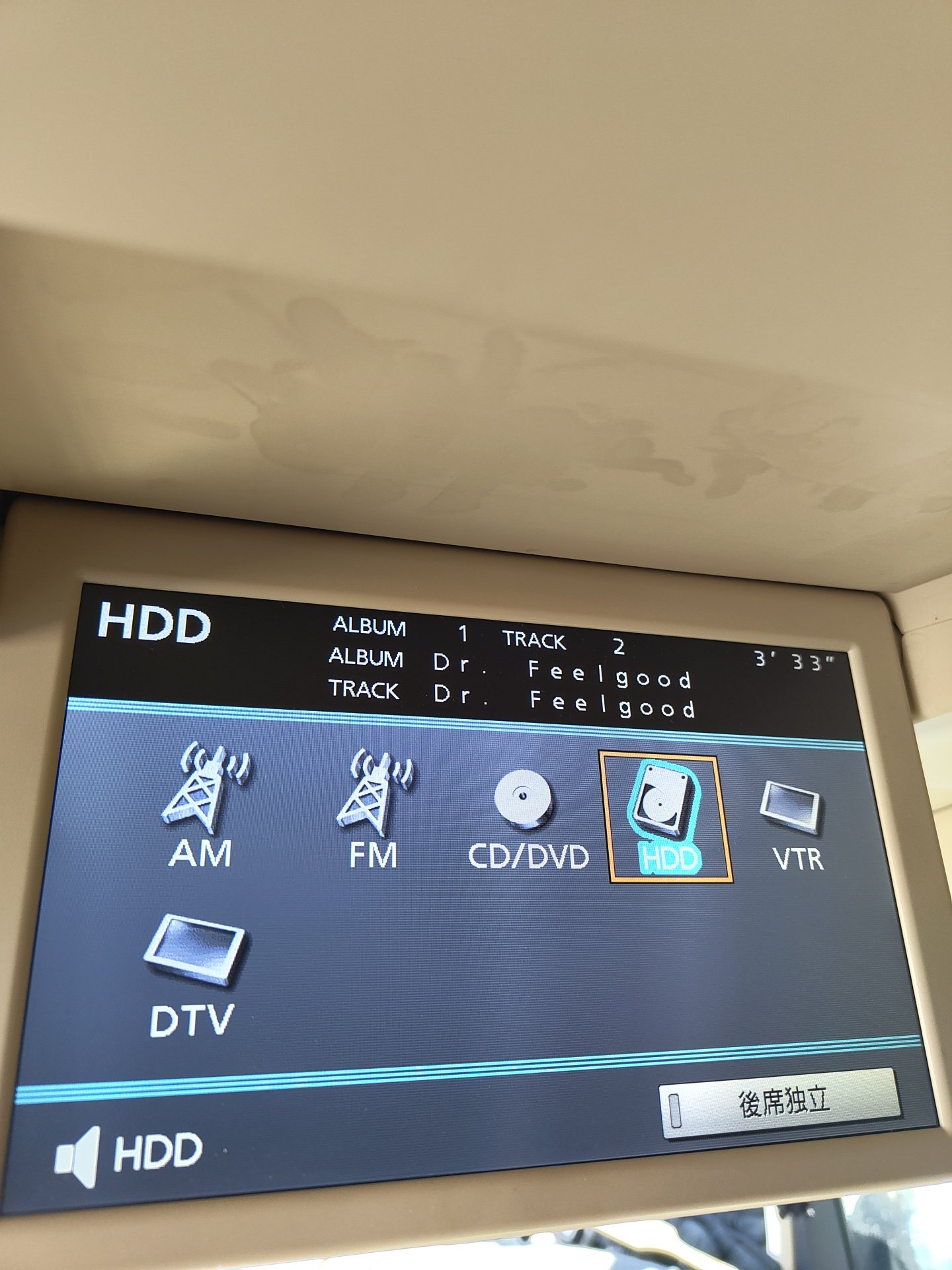

When i have insert dvd. It automatically lowered on both screens, i can use the dual option to only show it in rear, if disk is switched off it mirrors the front.
On yours the cd/dvd is greyed out which means you dont have a dvd inserted out recognised

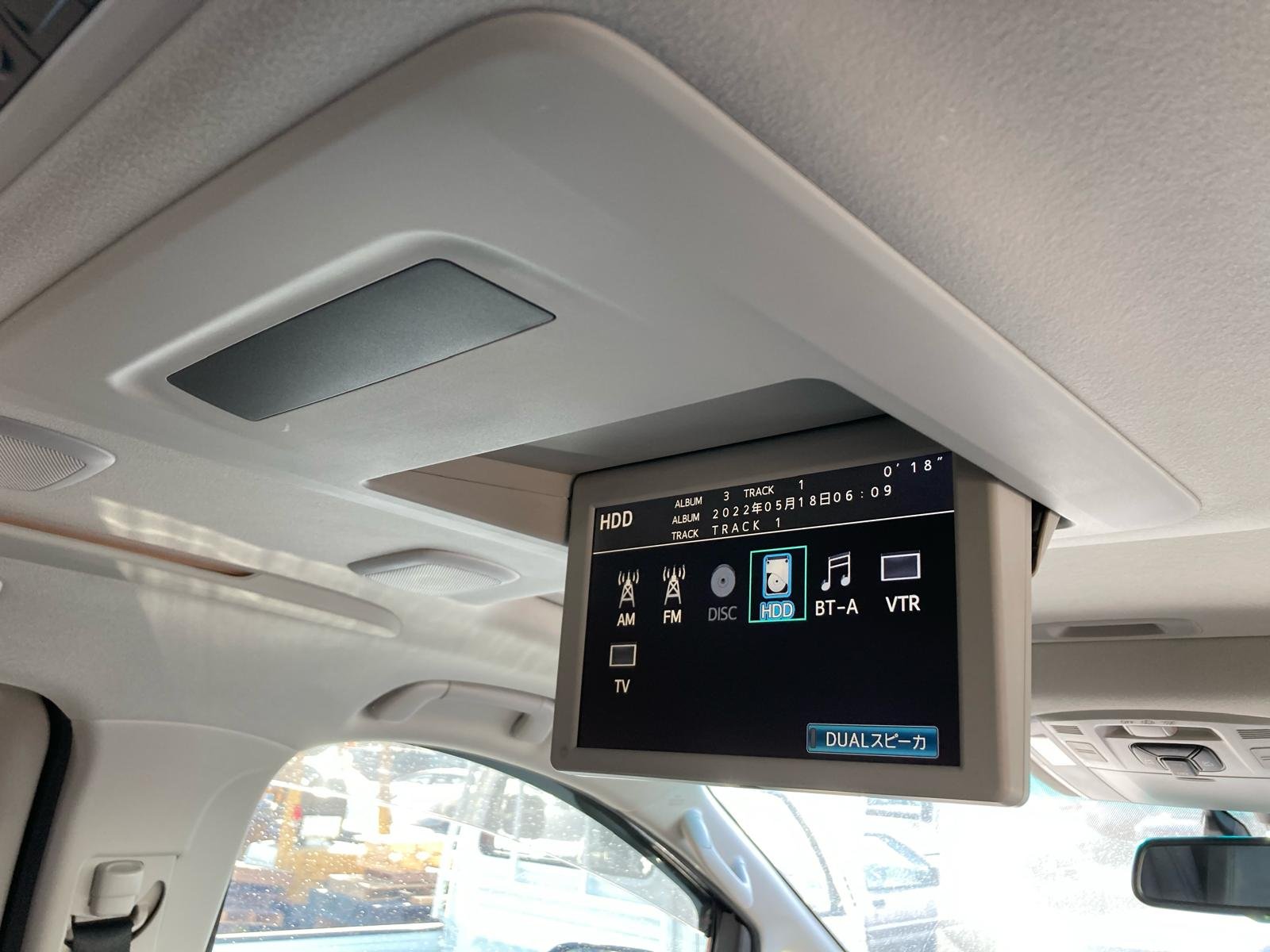

That was just a stock photo I had from getting it imported. It does pick up the disc when inserted and even if I split it doesn't display on the rear screen.

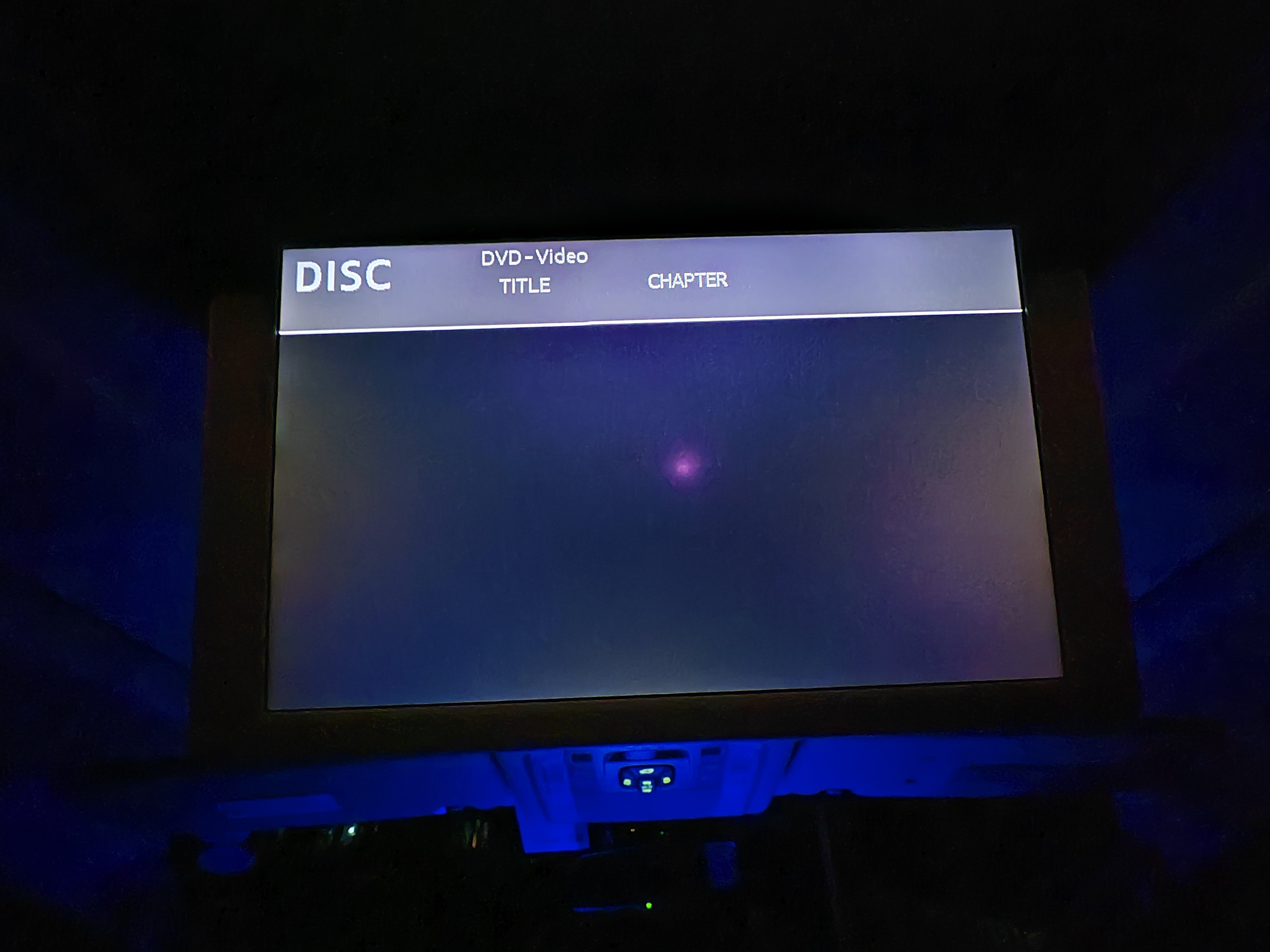

This is all I get with a disc loaded.

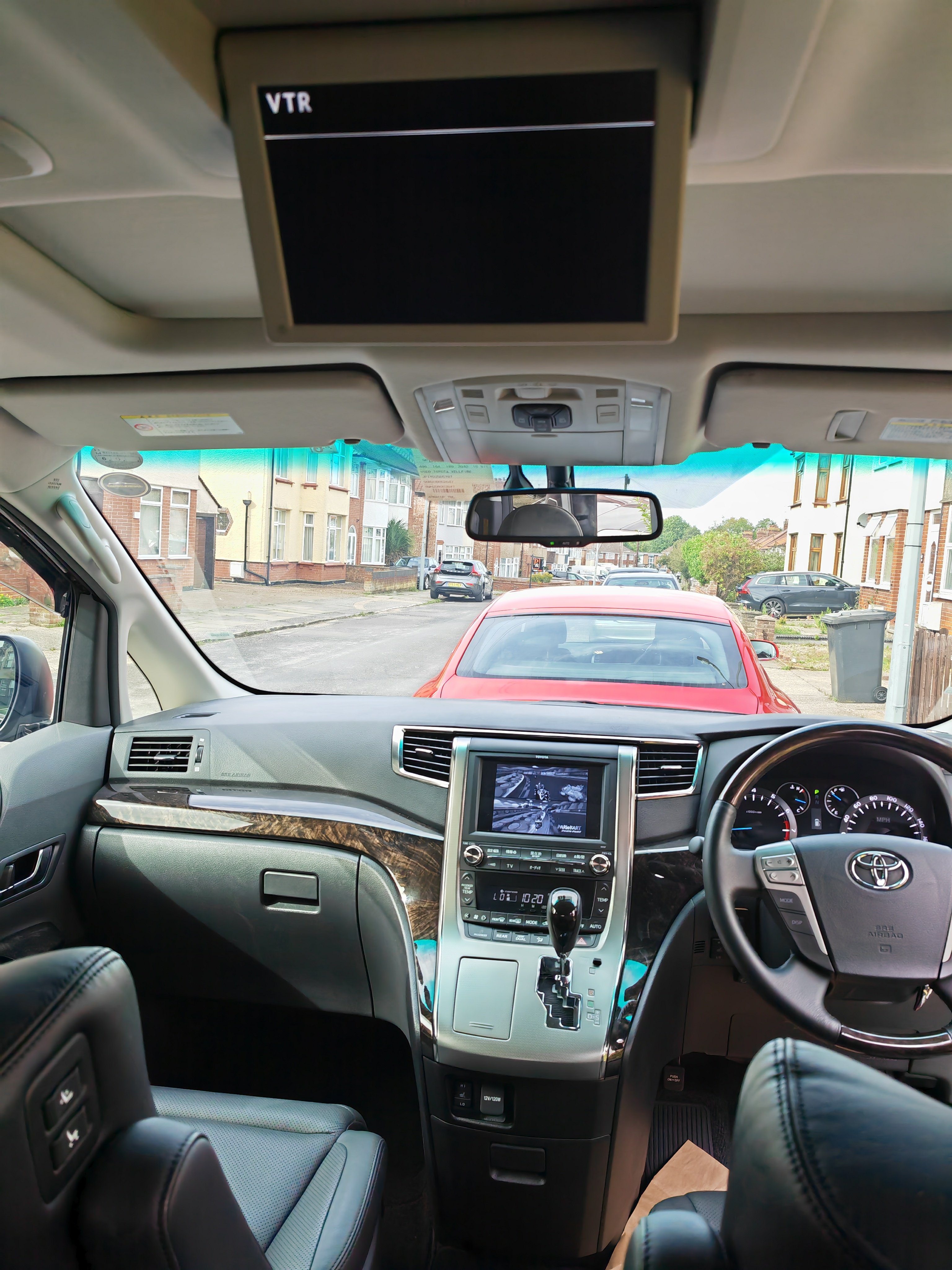

hello! having the same issues as you, although I'm trying with the VTR function. any updates or fixes?
just an update, once I got my remote working I was able to press the front seat independent button. even with it toggled both ways, my rear screen is still showing blank.

I didn't find any settings using google translate (other that the DUAL, or in my case Front Screen Independent) in my van, nor my friends. I also tried to leave the battery disconnected overnight without any success. I'll try to pull the head unit and see if that works.
of note; I do have the rear headrest screens that are somehow connected to the system so that may be playing a role. I doubt it though because the picture is coming through fine on the front screen.
