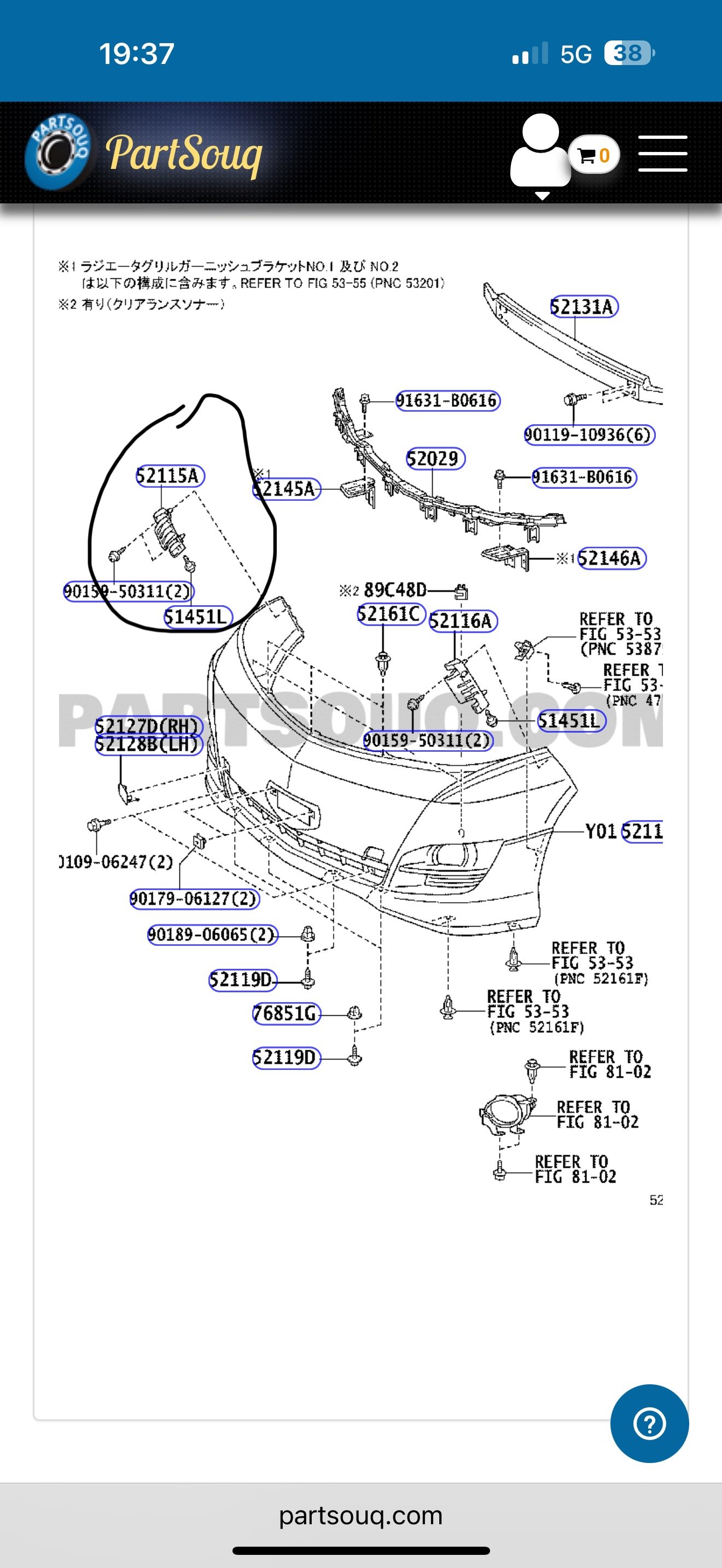

I believe I am missing a bracket of some kind from where the front bumper meets the body of the vehicle. Can anyone help. Photo attached.
Welcome David there is a bracket behind there I broke mine ages ago and bought replacement from Toyota not expensive if you pm me your reg no. I will give you a part no. And a picture
many many thanks for the super quick response. FB07 EGK
once again many thanks,
regards, David
This happened to me. All I had to do is push the sticking out bumper hard and it clicked back into it's original position. You might need to thump it with your fist as I once had to do.
thanks for that, will give it a go and then post the result
For anyone who is interested, I eventually sorted said problem.
Very simply there is a nut with a washer attachment - see parts diagram PNC 52161F - that holds part of the bumper in place. This just needed loosening slightly, the bumper was then slid back into its correct position with the nut then being tightened.
Thanks once again for all those with their welcome comments of assistance.
