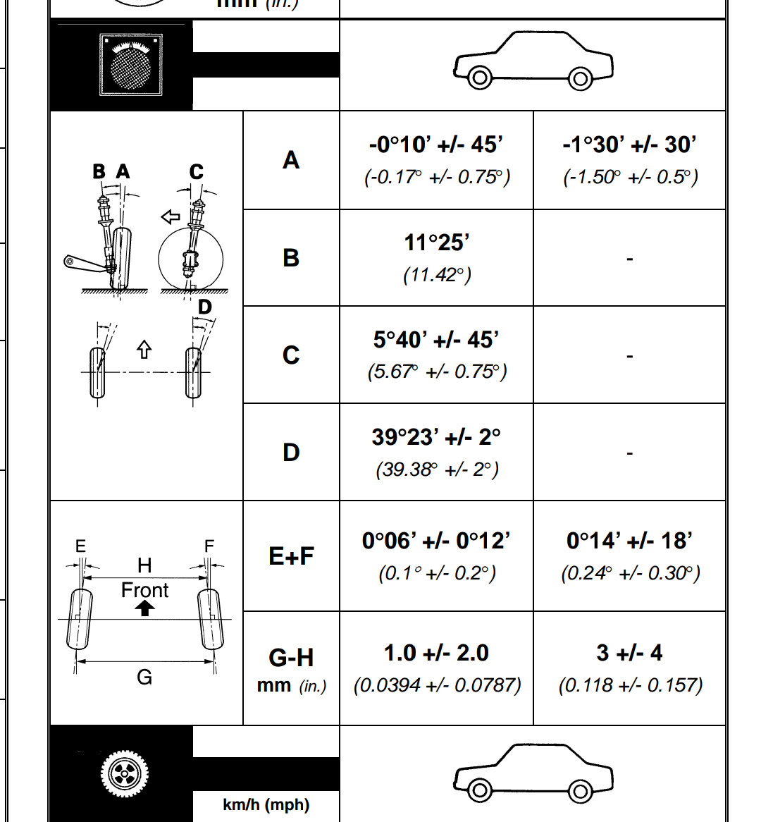

Im having new tyres fitted to Willo, my trusty 2009 Vellfire, 2.4l ANH20 and I was thinking of having a 2 or 4 wheel alignment. I know the garage is not going to have a clue of what to set the angles to because I will get the usual "its and import". Does anybody know the measurements so I can let them know.
5 hours ago, Chris.ac said:
Left column is front, right column is rear.
You are a star. Thank you

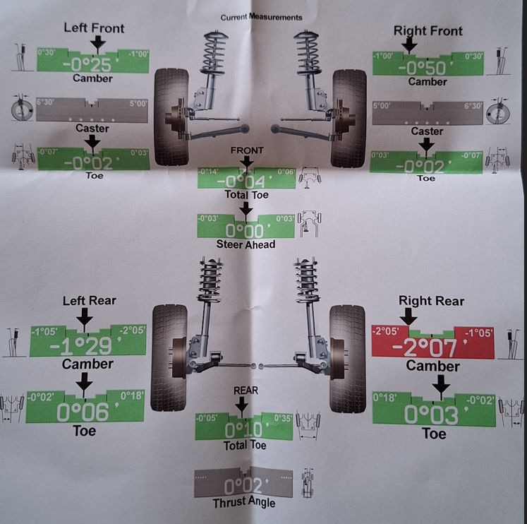

I also had some issues with my Alphard 2012, I think I may have used some force to turn the steering wheel and after that the car is pulling to the passenger side, got the wheel alignment checked by something called a Hunter device and they said its all good and does not need adjustment. I also checked the tyre pressure and everything is ok but the car still pulls towards the passenger side. They also checked the tyres to be nearly new and good condition. Please help.
They also mentioned that right rear is not adjustable.
Did you fix this?
It not, were your front struts replaced and the wrong type of bolts fitted in the mount?
