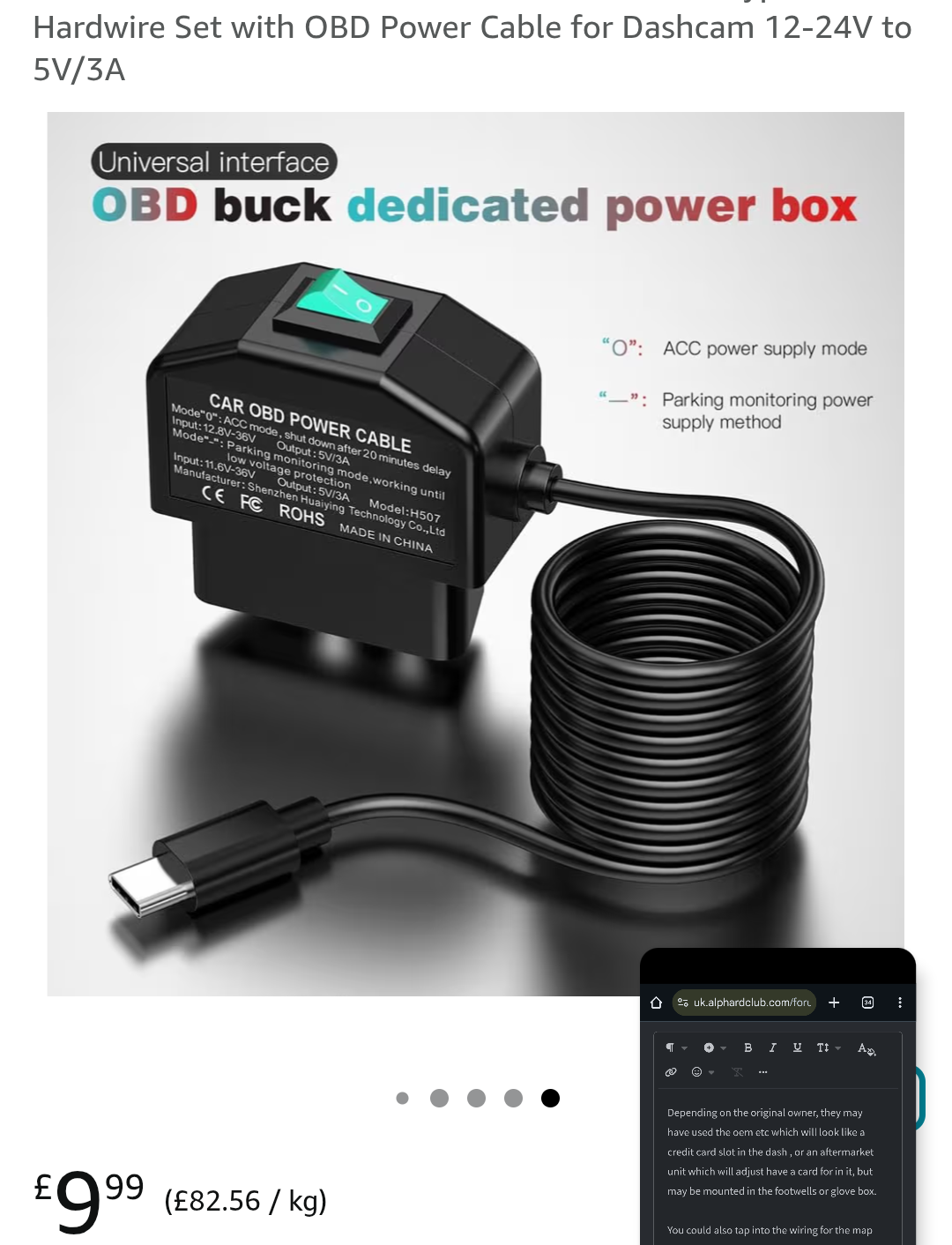

You can also buy an obd2 adaptor that will give you power
You can buy them for £25 at halfords, or far cheaper on Amazon.
Eg.
