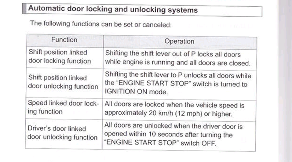

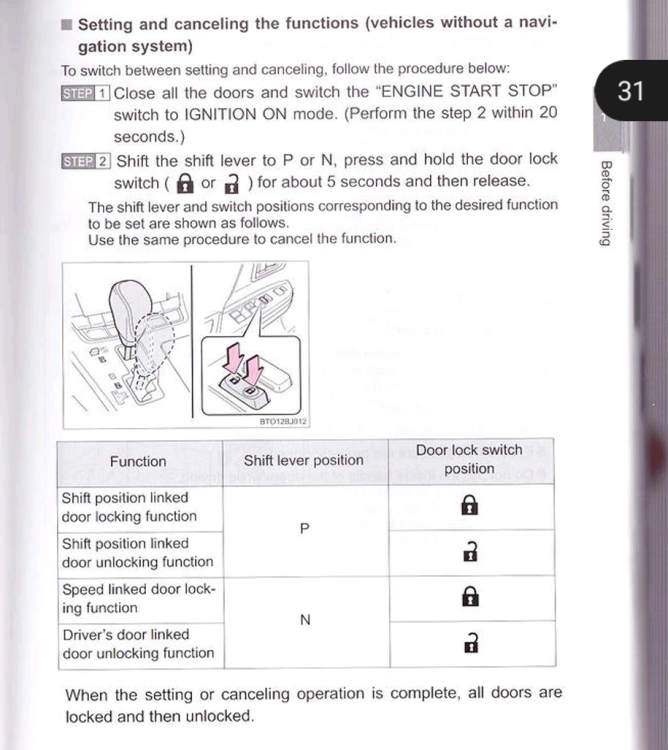

Here are the auto lock unlock linked to P instructions.
Each option is a toggle, so if you turn on ignition select P then press the unlock button on the driver's door, it will toggle between unlock all on moving to park, or not unlocking all when shifting to park.
If you turn on ignition, place in P and then press the lock button on the driver's door, it will toggle between locking all doors when you shut out of park, or not doing anything when shifting out of park.
So in my Alphard, i have it to sort unlock when i shift to p, like a taxi, and it only auto locks when i go over 20kph.
