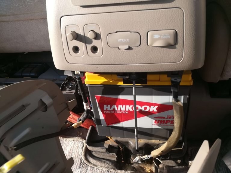

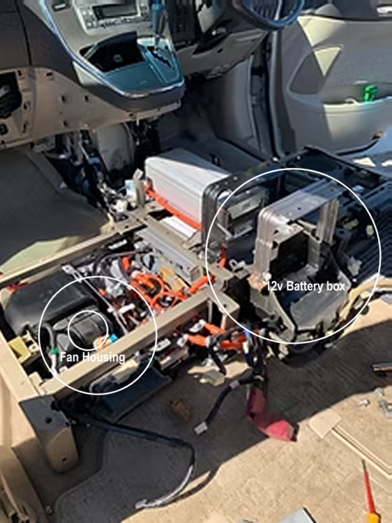

Please can someone assist me with 1) the location of my hybrid batteries 2) how to clean the cooling fan to the batteries 3) location of 12v auxiliary battery

1. Across the car running under the front seats.
2. The cooling fan is under the front passenger seat.
3. 12V battery is in the rear of the centre console.
A couple of pics that might help- FOR INFO ONLY- also found this on Facebook https://fb.watch/GIOCi8ppoL/
