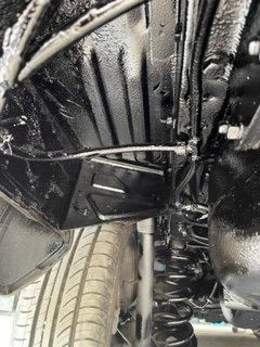

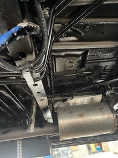

Hi Iain,
We had ours treated in 2022 and then checked last year to see if it needed 'topping up' (no need...).The treatment was upol with added waxoyl, our sprayer said the underside was clean enough to avoid prior steam cleaning, so it wasn't too pricey. Roads aren't salted in Japan, so I gather this is the reason that vehicles aren't undersealed. In the UK, on the other hand....

Hi Iain,
Gremlins in the last post - try again...
