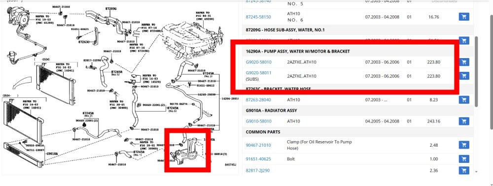

Wow, I was just coming on here because I have the exact same problem! @PaulE do you know the official part name for the pump?
Is it this by chance?
Edited by alphardoh
added link
The Toyota diagram ref is 16290A - PUMP ASSY, WATER W/MOTOR & BRACKET
There are several part no.s as they kept changing them for the same part and updating the part nos. You can usually get them on Ebay.
These are the numbers from Amayama. Toyota Alphard Parts - Toyota Car and Auto Spare Parts Online - Genuine Online Car Parts Catalogue - Amayama

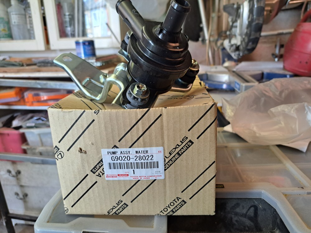

G9020 58010 /58011/ 58012. However I ended up with a spare one after the post office cocked up my delivery and this is
G9020 28022 (see pics) Double check your vehicle against any you see for sale. 20260729_150701[1].jpg
