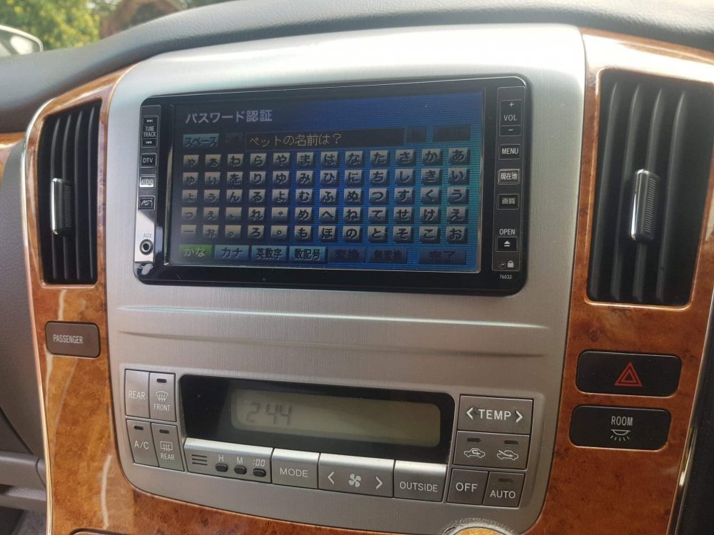

Going to see if the screen opens and flattens - the one we have is like a keyboard on the screen but in Japanese characters.
When you switch on your car, the Japanese lady should greet you, and a Toyota logo, and Japanese characters, appear on the screen.
Depending on your head unit, the open button is lower left hand side at the bottom.
Pressing it should open the screen so as to look like a small tray, which it ISN'T, and the CD slot should be across the top of the facia behind the screen, and a MD unit too.
As far as I can see from my JPNZ manual is that all (original) head units have a CD player.
I don't see any that resemble a 'keyboard'.
With the menu system (of my unit) there are many screens which look like keyboards, because they are.
Without wishing to worry you, I wonder whether your unit may be 'stuck' on a menu screen.
It also sounds like you may be a candidate for an upgrade to an 'English' unit.
Can you upload a photo of the head unit ?

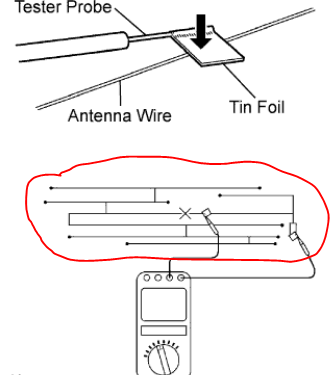

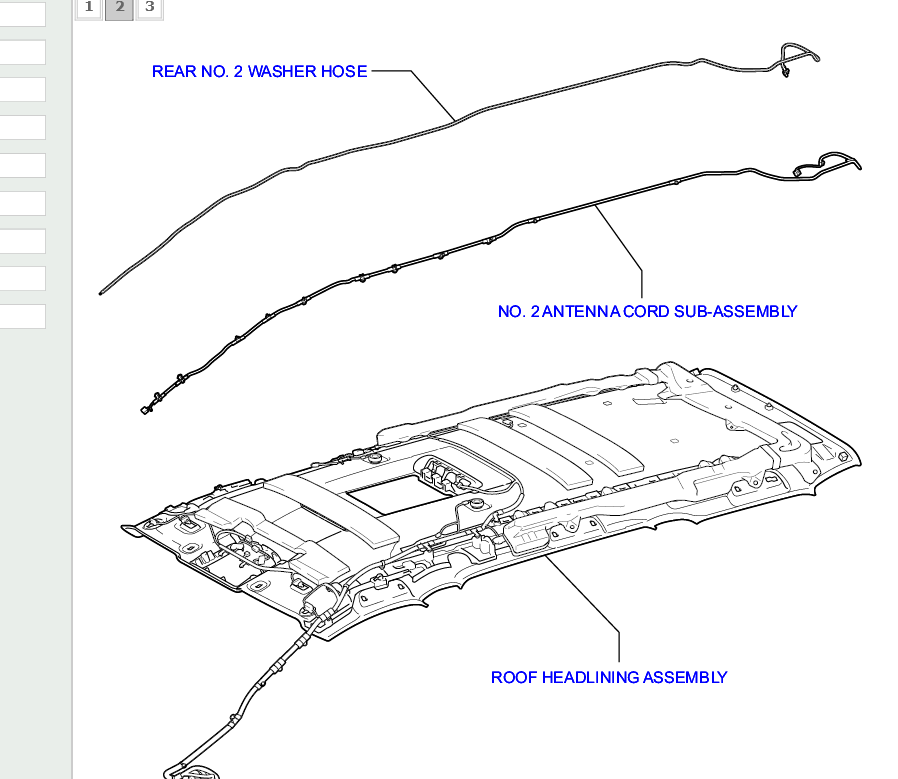

Looking at the schematics - the aerial runs to back of dash and travels up the A pillars following the rear washer hose, before headed to back of car - antenna must be on rear glass or rear passenger side glass

On 10/15/2021 at 1:31 PM, Chris.ac said:
Looks like this on glass (circled in red)
Thank you, yes it's there but Halfords wouldn't even take the old radio HDD thing out.
