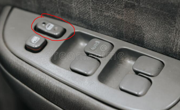

Which door unlock button? On the door, dash or remote? Does this work for the side doors too?
It's the driver door main button taking care of all doors.
Jesus what a gumby...I thought this was for the windows..🙄   cheers!
Nov I've done this & it had the same effect as just pressing it once...should anything happen after 5 secs - ie noises, clicks or anything flashing on the dash? Do I have to do this before every journey?
I'm puzzled here...am I just being a thick tit?
Your doors locks should close and open to confirm programming, it's tricky to get it right.
Have a look on the below video.
Another option is to use Techstream- Toyota software(available to download online) and switch the door autolocking when driving to OFF completely.
This works a treat, thanks guys.
I can advise that when youve pressed the unlock button for long enough and let go it does a quick lock/unlock cycle.  Not sure if getting out and locking/unlocking with the key is necessary but thats what I did.
