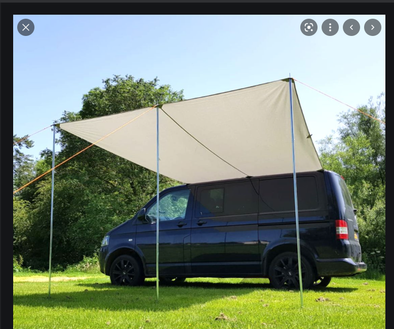

I was after something like this that would slide into a rail that's fixed to the side of the alphard.

I've just fitted a plastic c rail to the roof of mine and have a cheap "maypole" awning/sun canopy that looks very similar to the pic. As it's only going to be a fair weather awning I've tiger sealed and self tapped the plastic rail to the existing gutter strip. Saves me holing any metal work. I've adhered it to all but the last 6 inches or so at the end as the pop top flares out towards the back and don't want it fouling. It seems strong enough but will let you know when I try it out.
The canopy was about £75, one of these:
https://youtu.be/jPQJK89U8jo
The plastic rail here:
https://www.ukleisureparts.co.uk/shop/awning-rail-c-channel-black-plastic/
Total cost was only about £110. So fingers crossed 😅
That's awesome mate thanks. Exactly what I was after.
How did you go about permanently attaching it to your Alphard?
Tiger seal and self tappers.
It's not permanently attached at the moment though, only to the existing gutter strip. Which seems to be fine. Should ideally permanently screw to the bodywork I guess. Haven't tried it yet though as the weather is hideous.
