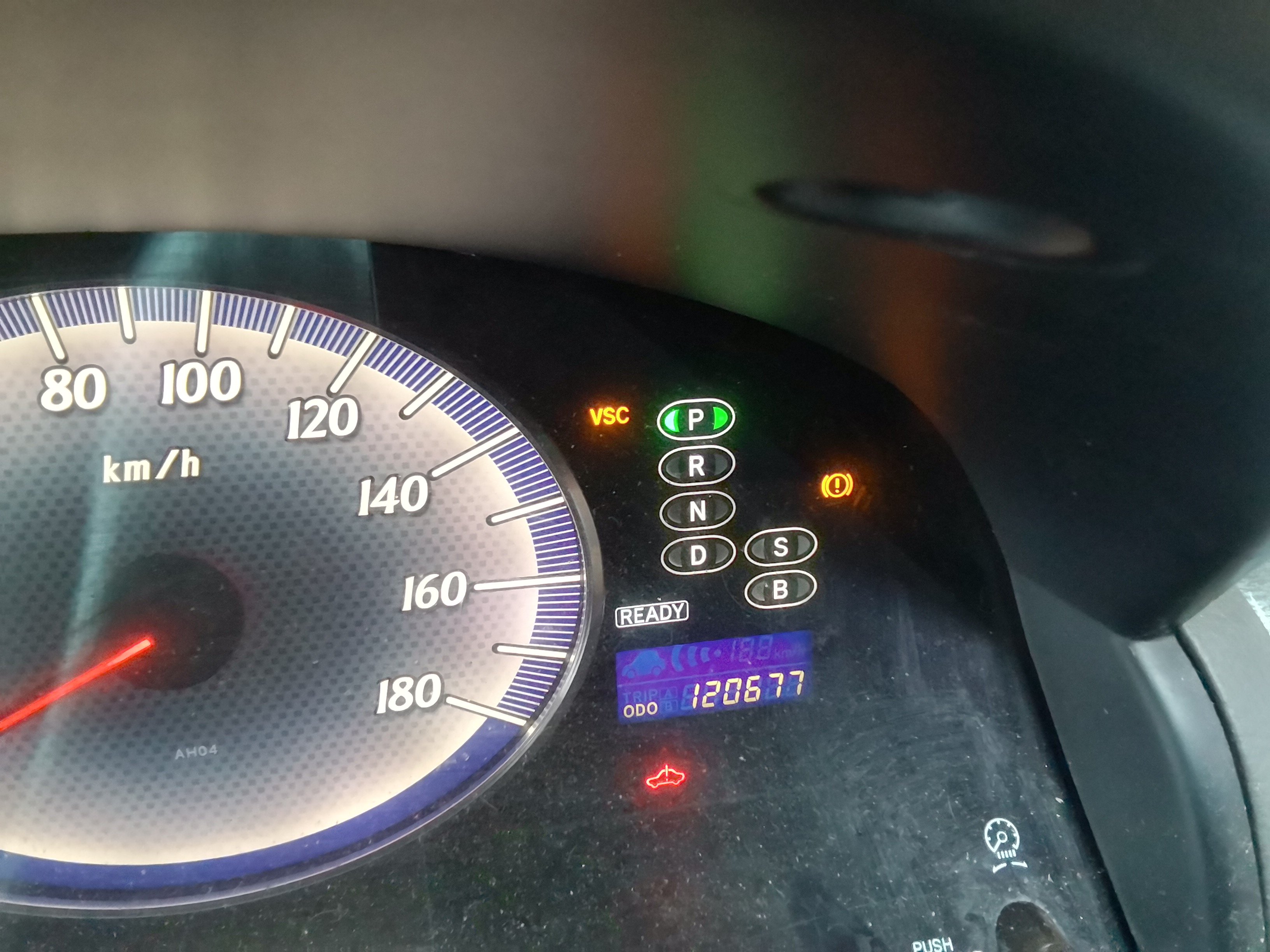

C1310 hv solenoid booster fault, 3 lights on dash, engine cuts out sometimes
Hello fellow alphard lovers!
Got my 2.4 efour hybrid 2006 for about 3 years now, absolutely love it and have done about 30k miles on it, absolute joy!
Until last week, unfortunately..
First of all the car wouldn't switch on, funny noise (not funny actually), no idea what it was seemed like there was something jammed or rattling? Noticed oil level was low (as usual as been told the 2.4 engine between 2002 and 2007 have a piston ring issue? Correct me if I'm wrong), topped up the oil, connected my battery booster and it finally fired up with a nasty surprise, 3 lights on dash (as per picture)..
Since then the engine has cut off twice, once because hybrid battery went so low the engine cut off and wouldn't switch on, had to call AA who cleared the codes and it switched back on, second time was on motorway, it switched off for no apparent reason, stopped on hard shoulder, waited couple of minutes and it fired back on...
Apart from all listed above, noticed the engine doesn't seem to stop when hybrid battery is fully charged (it used to), the usual start stop waiting for traffic lights does not happen anymore, and the usual hybrid ecu that shoes battery being charged doesn't show the usual yellow and blue arrows, apart from other minor things that came along like: can only open driver window the other ones stopped working, cruise control doesn't work and the 100v ac power (used to use it to charge my phone) also doesn't switch on anymore... Worth mentioning that couple of weeks ago I had none of these problems, apart from constant oil top up (5 to 10l a year)
have taken the car to 3 different garages, all of which have different views of what could be wrong with it (first one doesn't know what's wrong, second said it's probably the inverter and the third says it's probably hybrid battery)
Any ideas or direction would be extremely welcome!
Many thanks
Gabriel

Isn't the right most yellow light the footbrake tell tale.
As your vehicle appears stationary I would expect that light to be on !

In regards to the footbrake my light is red and on the left side of the dash, didn't include that in my shot.. those 3 lights are on all the time whilst I'm driving..
And the noise coming from the engine bay was a different noise, rather loud and rattling whilst I was trying to fire up the engine.. that didn't happen anymore, it was just the start of my problems!
I know the noise you mean from the book, it's rather low and "electronic like".. not related to it..

That yellow lights seems to be a Brake warning light. ( ! )
Probably not the ABS though as that warning has a slightly different symbol (ABS)

So we got brake lights, vehicle stability control and that red car is hybrid system light right?

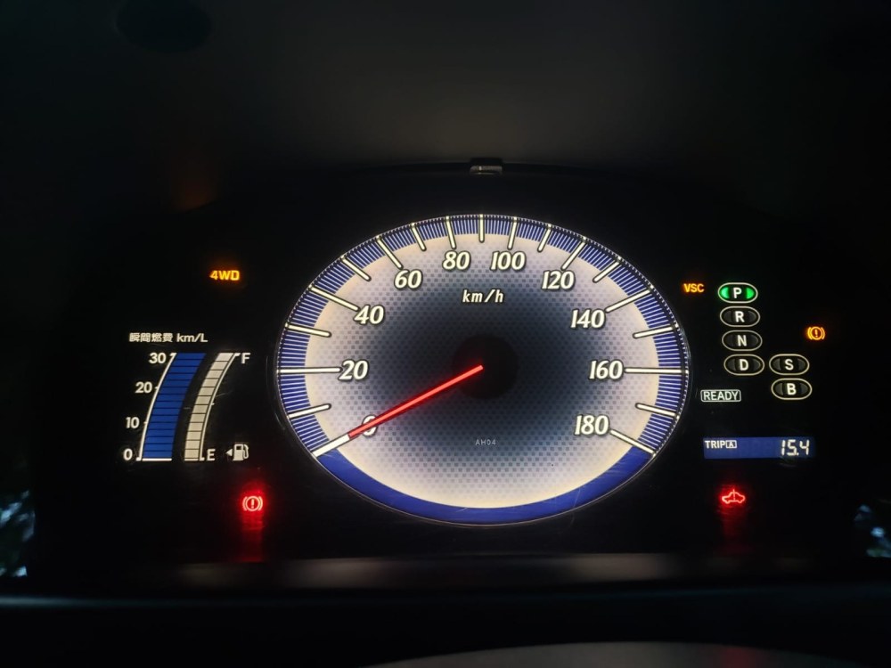

I have the same problem since a month ago. I noticed that when the VSC light comes on, it comes on together with the check engine light and check hybrid red car ! light come on. It can only be the VSC problem speed sensor problem or gas cap or tyre pressure. Once the VSC is fixed, the other two lights goes away. I haven't fixed it yet.
I can feel my hybrid battery is running and being charged so I think this is a design issue. Can be just a simple issue
It happened before some 2 years ago but with the 4WD light on. The w/shop guys will give you different opinions and I ended up first changing the HV inverter and after driving a short distance, the lights came back. They next changed the pump for the hybrid radiator and it never came back. So I think it was not the HV inverter but just a simple pump issue. What a price I had to pay.Error10Sept2022.jpeg

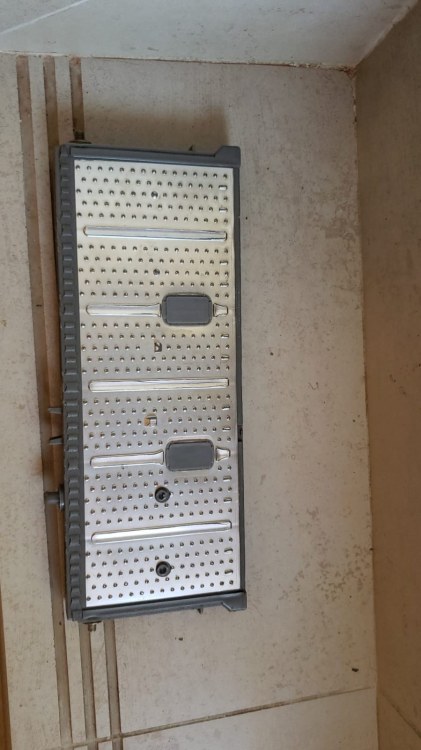

Thanks for that bud. Mine wont even turn the engine on to charge the battery. Ive had several computers on it but none seem to be able to pull any live data. Im close to checking battery cells manually. Im actually a HV tech for ford but I'm stumped with this one with no real direction to follow . Will be sure to update if i figure it out though
You mean this....
You can find some on youtube, like this one..
https://www.youtube.com/watch?v=2YYsTWLTyY0
Edited by taifansi
If the 4WD, VSC, and hybrid warning light (car with exclamation mark) are lit the most likely cause is a hybrid fault, not a VSC fault. If they come on after a period of driving a common issue is the inverter coolant pump isn't pumping and the inverter is overheating. Whatever the issue, you need Techstream to find out what the codes are and to get live data.
Edited by smurf
Right on Smurf! But my stupid mechanic blamed it on the inverter and changed it. After driving around a couple of miles, all the 4 lights came back on. He changed the pump and the fault cleared. This was 2 years ago. It cost me alot.
Just about a month ago, this time 3 lights came on. The VSC, Check engine light and the check hybrid light. This happened when I noticed the aux battery went dead several times and I kept charging it and finally I change to a new battery. The cars seems to be running good but I couldn't clear the lights. The hybrid battery seems to be kicking in when idle but the energy display usually stops working when the check hybrid light comes on. Any suggestions?
The only suggestion I can offer is to connect up with Techstream and read the codes. It could be absolutely anything.

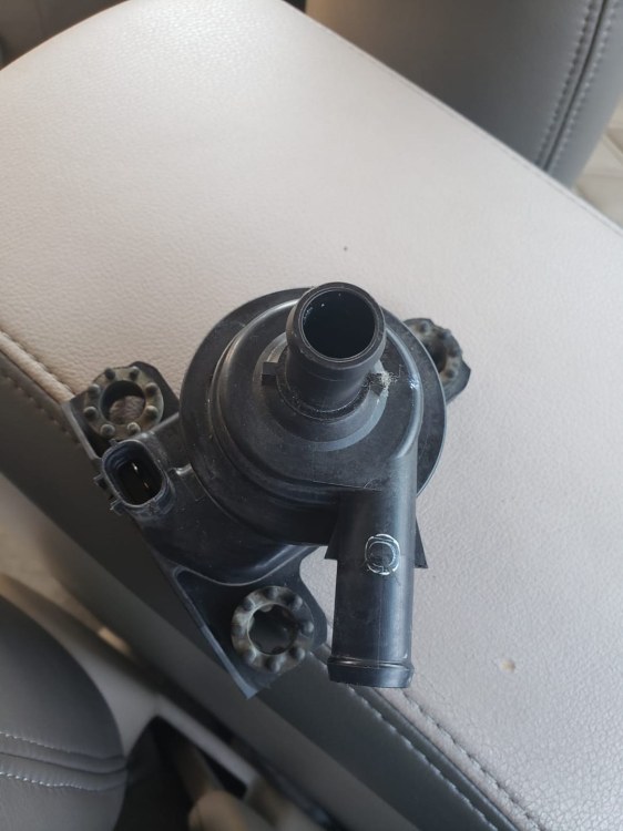

Hi all. Finally fixed the car at the garage. They replaced the hybrid radiator pump and the circuit board from the hybrid battery. The car is running smoothly and the hybrid kicks in too. I have the codes but they are all in Chinese.

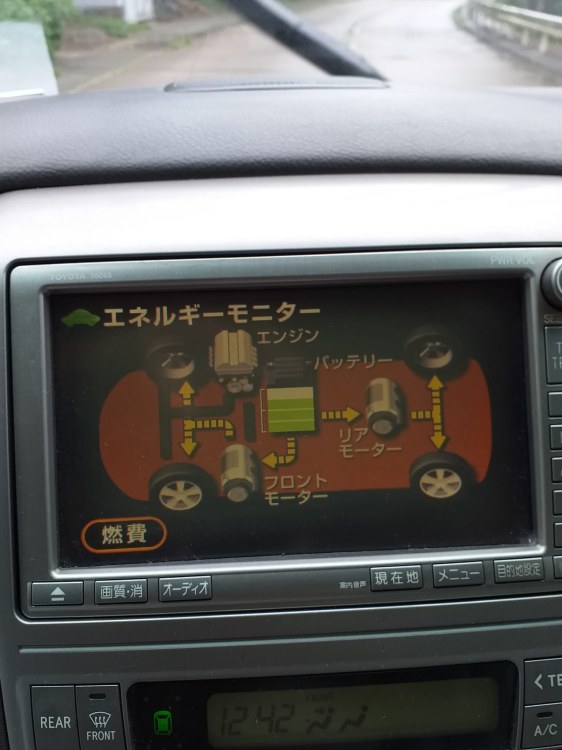

I have one more thing to tackle. My Head-Up Display radio is dead after those guys did an interior cleaning job. They broke the on/off switch and it was going crazy but now is dead. Anyone can guide me where can I get a replacement? It had the part no: TOYOTA 56065.
Can an after market android radio work? I would like to know if the HV battery energy display will continue to work or not or is there one that can be connected to the ODB2 and show up on a display.
Edited by taifansi
Only the OEM stereo will give you the hybrid info sadly
