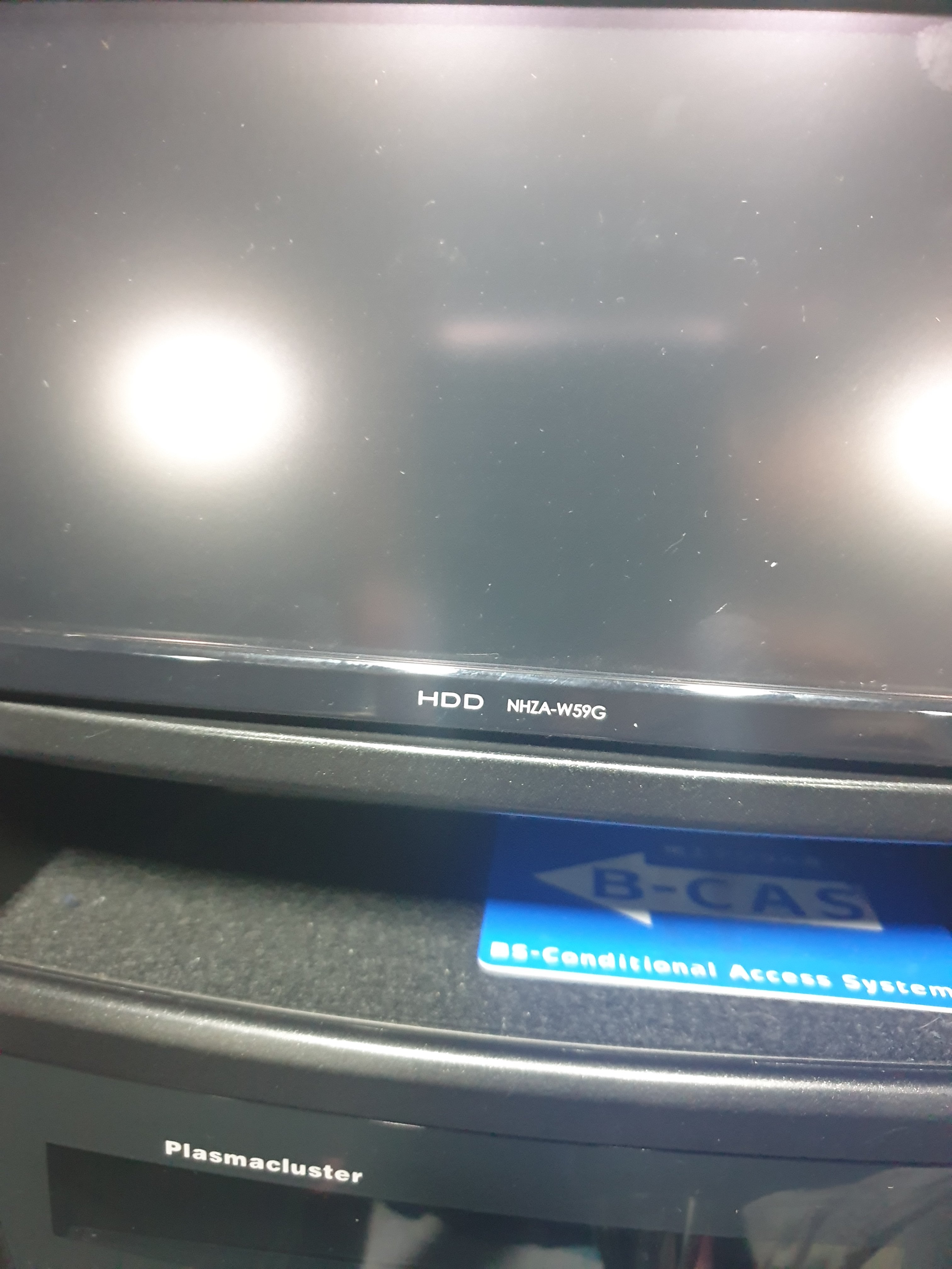

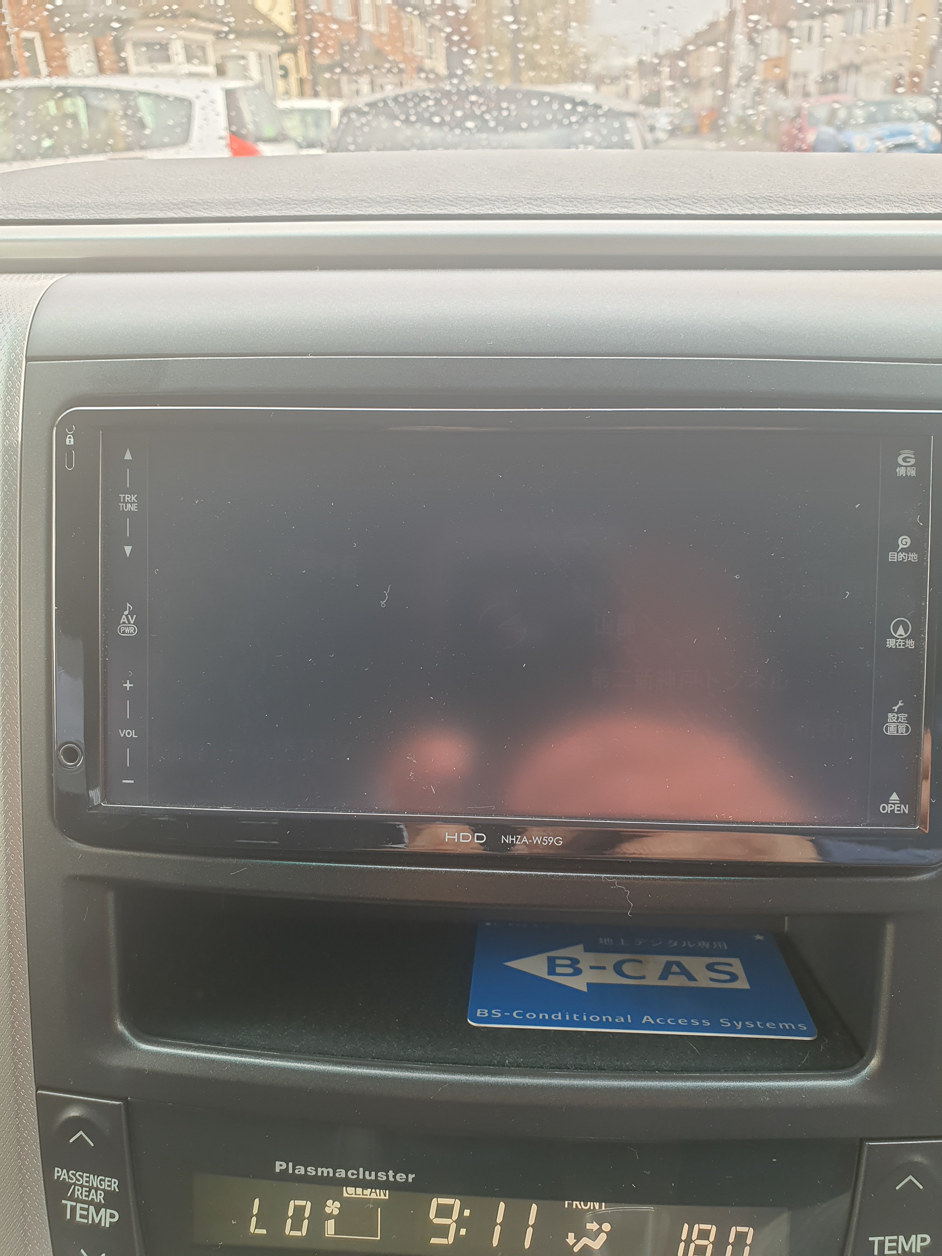

Thanks for responding. My Alphard is a late 2009 on a 59 plate. My car does not have park assistant or 8 speakers and does not have a USB input. You can play DVDs on the unit. The unit can also accept a SD. I looked at many Alphards before I went this one and I did notice that there are different head units. I will take a better photo of the unit, the attached photo was on my phone.
Photo taken from the manual apologies if this does not help. Later I will take a better photo of the unit.
Here is a photo of the unit in my car.
Follow up on NHZA-W59G navigation head unit, my initial intention was to get rid of this ASAP. However, having spent some time with the unit, just over a week I'm just starting to get use to the unit, only just mind you. So far I managed to set up the speakers when I was playing a CD very easy to set up. My next goal will be to connect my phone via Bluetooth and connect my wife's  iphone via the AUX input. One thing I did notice I managed to come across a menu that appears to monitor the diagnostics of the car, I need to do somemore investigation as I can not remember how I found this menu. I will do another follow up in due course. I will not be getting rid of this unit under circumstances, never thought I would be heading in that direction.....

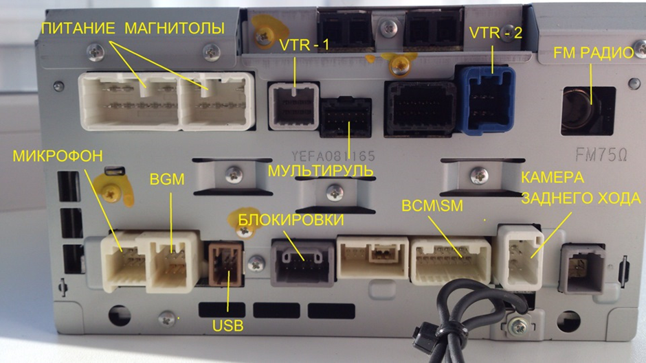

I'm starting to work out all the myriad of tear connections with a lot of help from some Russian forums. There are connections on the rear for extra cameras, iPod interface (old style 30 pin ones) and a composite video AV in. Using a combination of these in contemplating getting a raspberry pi that I have laying around to do carplay/android auto to allow Waze or Google Maps to show up. Chris has wired up a dedicated box for this successfully which gave me the idea. I'm hoping to find where the ETC device injects it's audio feed as that can shout over the top of music or radio that's playing so I can have navigation prompts while listening to radio broadcasts.

Shamelessly copying from a Russian site, this is what the back will look like although there are a number of variations! Mine has a wider (16?) pin connector instead of the ones labeled VTR-1 and the black one to the right of that, this comes to a break out connector where a specific iPod connection lead can be plugged in to allow old 30 pin iPod's to work.
I also don't have the brown USB connection, but a grey one, as I don't think mine has a USB input.
I gave up wondering about the ETC audio input as I think that's all part of the AVC-LAN connection so it's not a simple audio input sadly.
