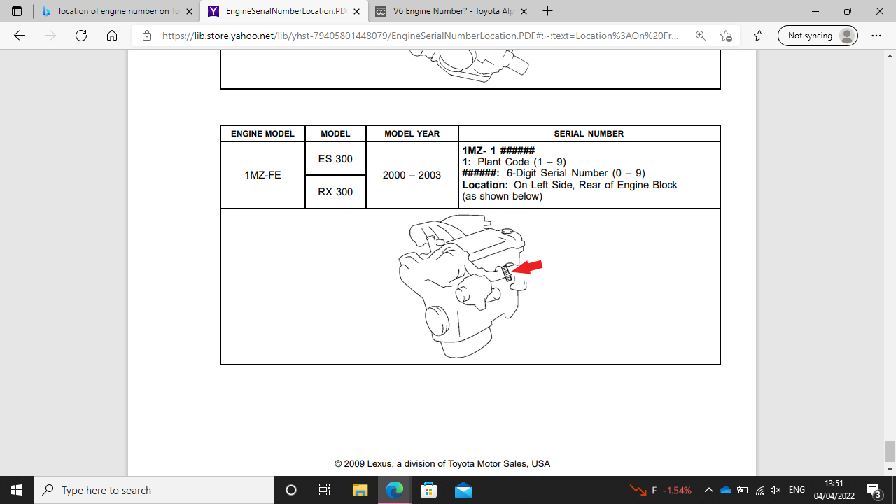

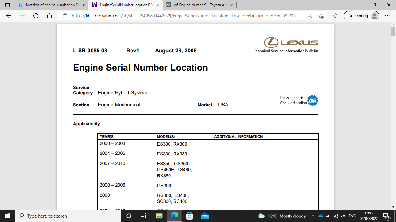

Try searching Google for location of engine number on Toyota 1MZ FE engine.
It brings up several locations including, probably, the location on US made engines.
It should follow that it is somewhere visible when installed in the van, otherwise there isn't much point.
Try half way down rhs of block looking at front of engine.
Thanks for that Google Search Idea Rojie, different words in the search engine to what I was using!! Came up with this document. Two screen shots below, first top of doc, second is the one I'm hoping for!!
Many thanks
Phil
