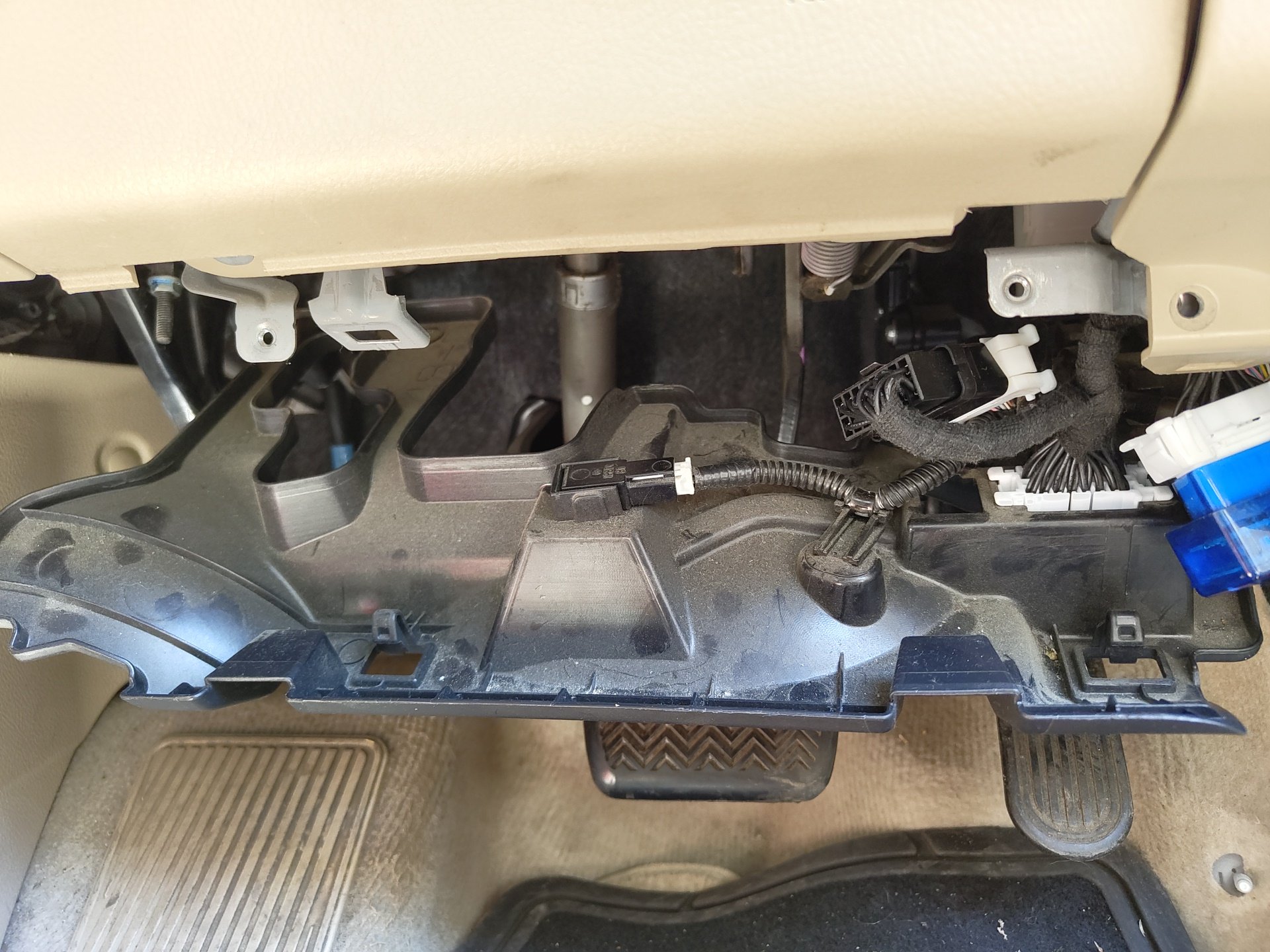

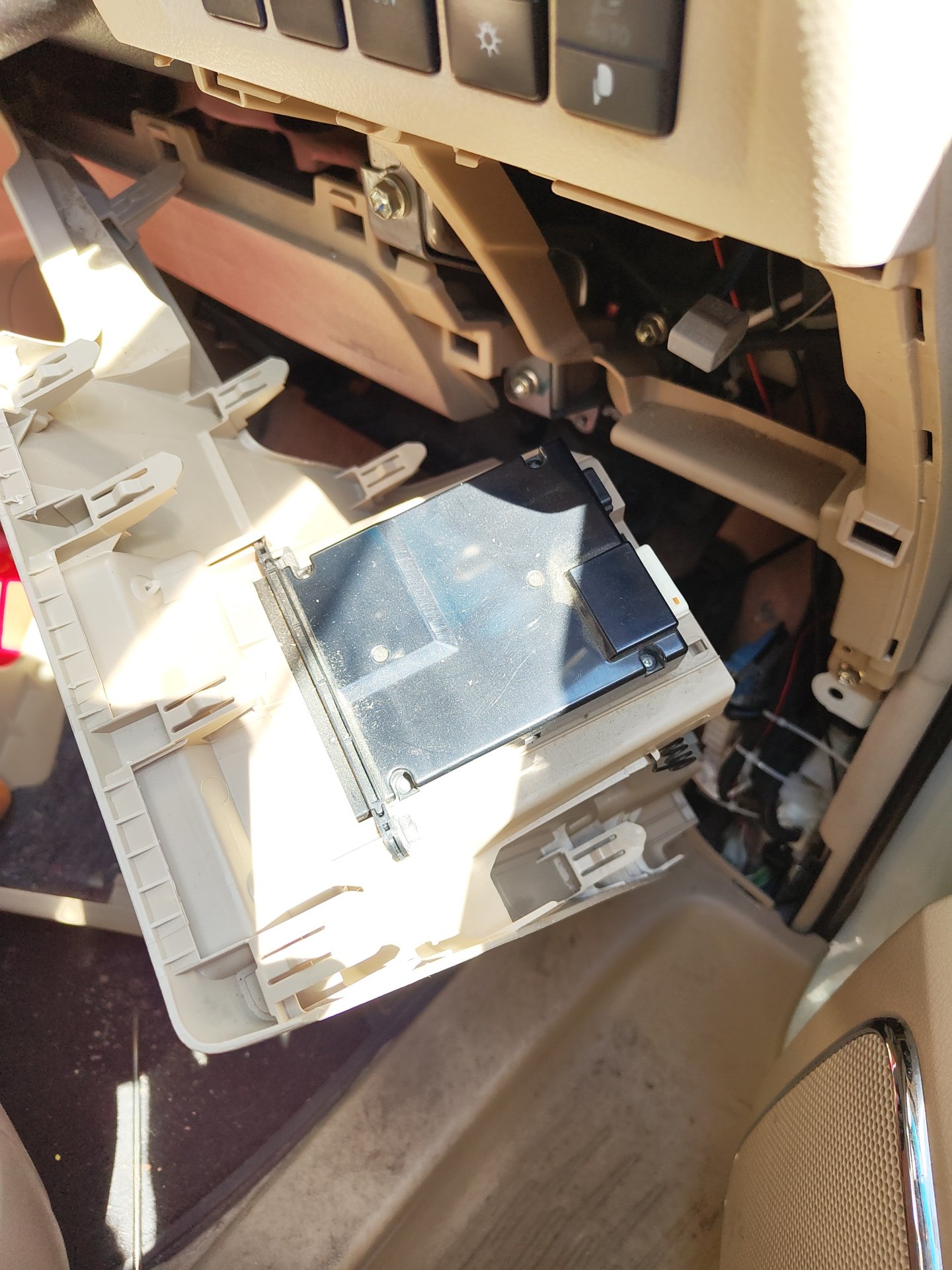

Not difficult, remove a couple of screws from black cover under the drivers footwell.
Remove the plastic kick panel on the right side, held on by one plastic thumbscrew.
You'll reveal a few screws holding the lower dash panel,  undo, and pull from the door side, you'll see the etc unit, disconnect the larger plug that powers it.
