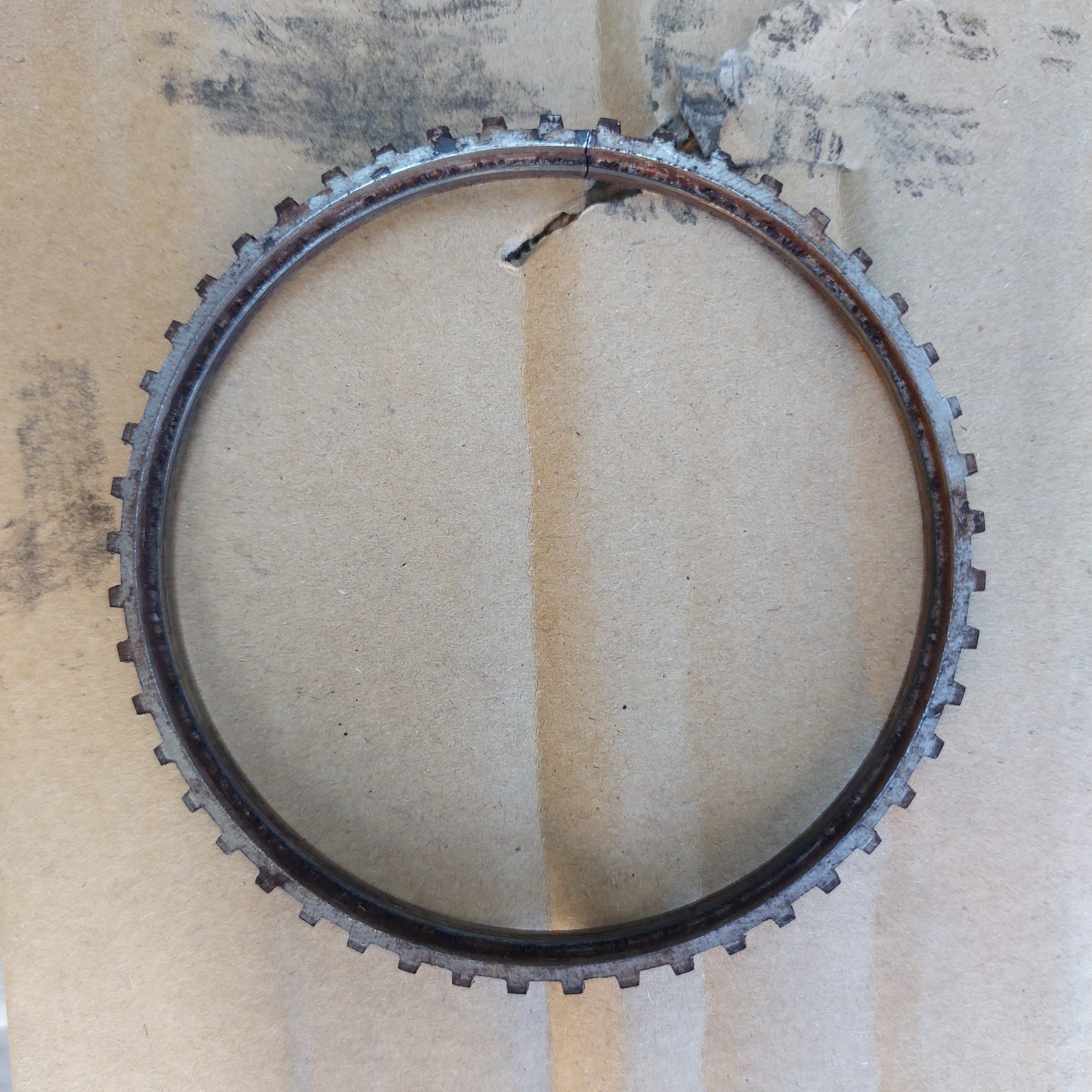

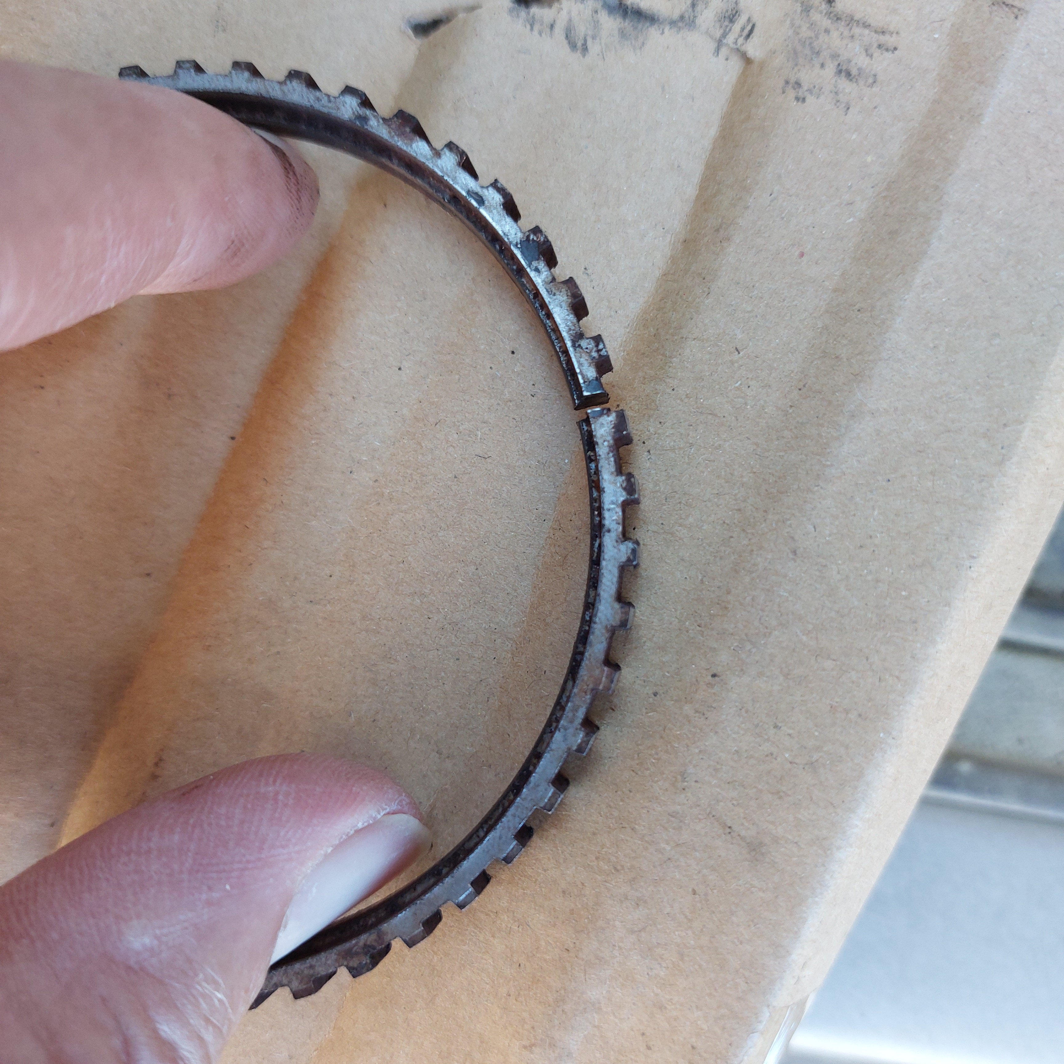

Update..... Worth noting....
Having searched unsuccessfully for a replacement reluctor ring I decided to buy a complete driveshaft from a breakers yard in Tokyo....
It arrived in just 10 days and has been fitted and what's more .....
The fault has at last gone.
Now I have discovered a company in Lincolnshire who not only stock reluctor rings but also can make them to order..
I have sent my old broken ring and will post back on here when I hear from them regarding availability and cost... I've attached 2 pictures of the broken ring... Difficult to spot until it was ooened up...
