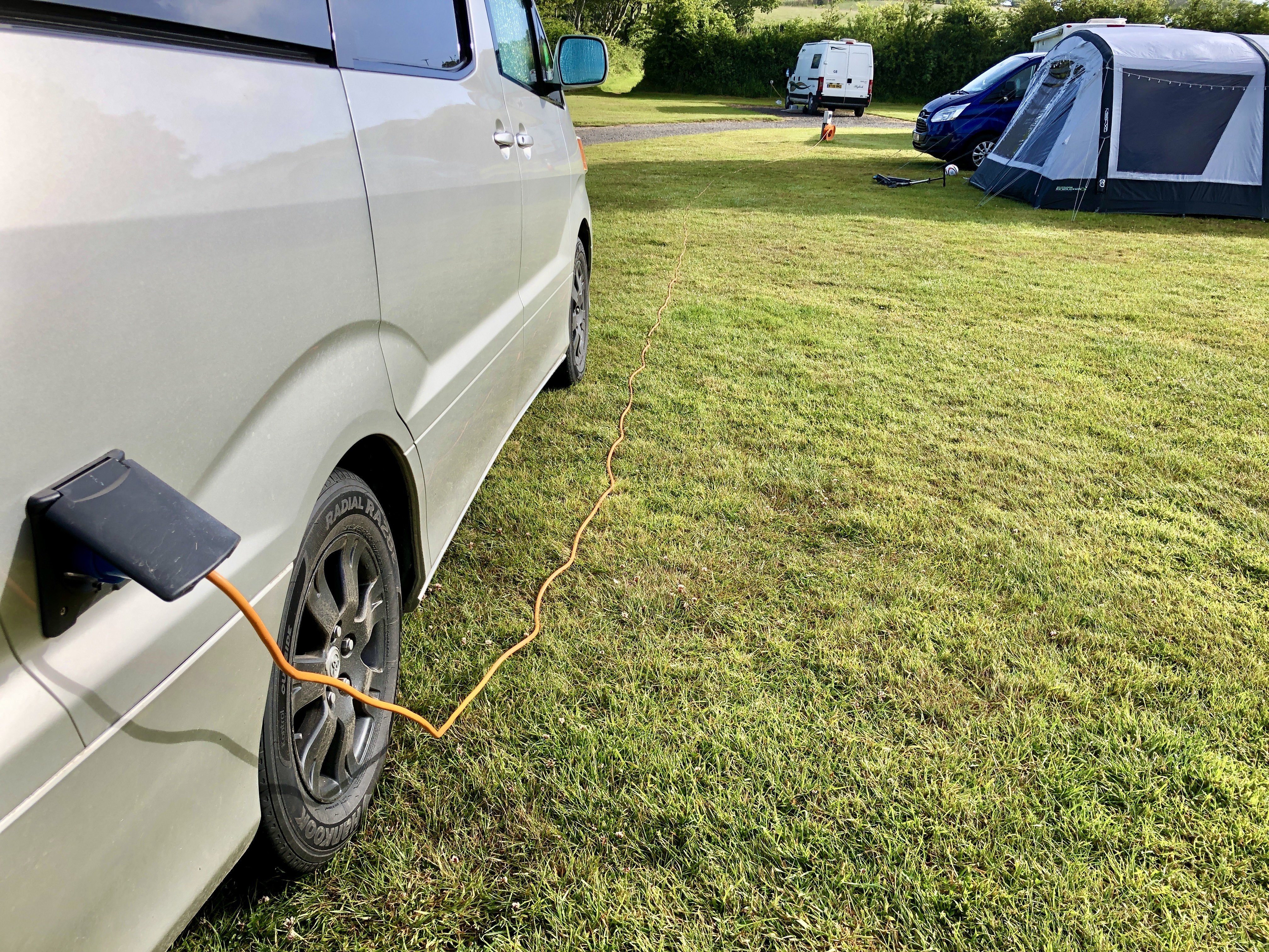

Posted
So remember when I said I hate the big heavy git hookup cable I have, I take it all back. Every inch required in Devon.
Posted

I’ve just brought a cable, but can’t plug it into my Alphard as the cap get in the way. Any thoughts? Thanks
Posted
What vehicle do you have ?
What year ?
Alphard were not made in 1998.
Have you got a 'proper' EHU connection, or a home-made type ?
Posted
Sorry, it’s a 2008 Alphard G. It’s a Japanese import conversion. An approx 4 inch square plastic cover on the vehicle.
