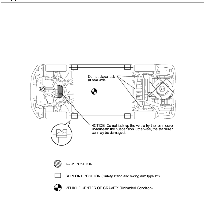

Hi Darren,
The 4 jack points on our Alphard are on each sill, to the rear of the front wheels and to the front of the rear wheels. I had to change a wheel at the roadside after a puncture on the first long trip out - found it hard work using the standard jack because of the additional weight of the campervan conversion, so decided to add a hydraulic jack to the kit after that....
On 6/21/2022 at 5:35 PM, Chris.ac said:
on 20 series:
This is useful.
On mine the sill was previously damaged / squashed by a swing arm lift using the points shown on the diagram. Has anyone else had the same problem?
Going to be spraying underbody protection in the next couple of weeks so glad to find out the position of jacking points, and I'm assuming that safety stands are another name for Axle stands?.
