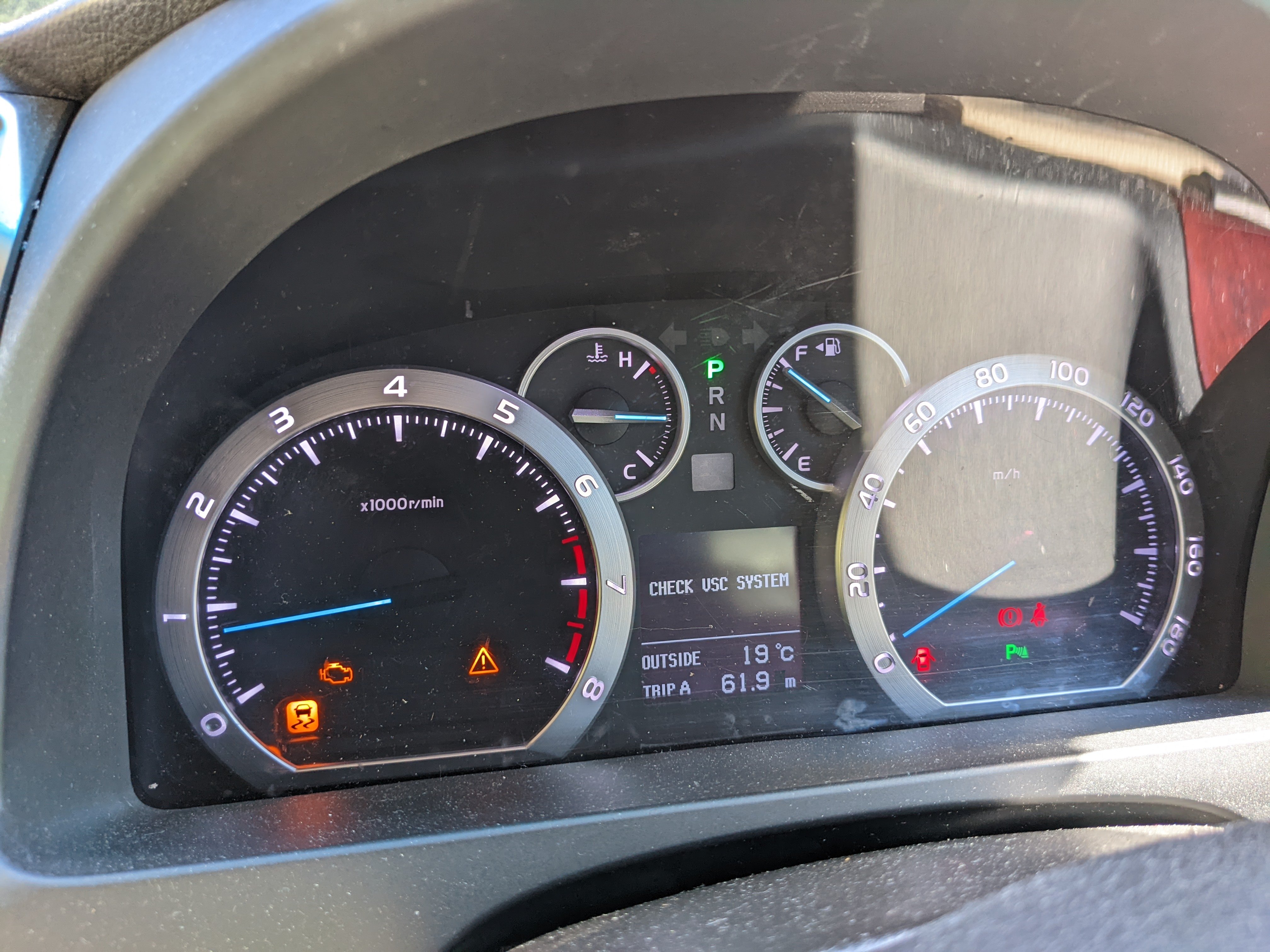

Bryn Posted June 7, 2022 Share Posted June 7, 2022 Hi, Hoping someone can help. Currently experiencing intermittent dash warning lights and message check VSC system , comes on every journey after approx 10mins of driving. All local garages contacted so far have been unable to provide a fault code scan , I purchased a ODB scanner however this will not connect. Can anyone advise of a garage or a forum member local to the Bournemouth area who might be able to do a fault code scan? Many thanks, Bryn. Quote Link to comment Share on other sites More sharing options...

Bryn Posted December 24, 2022 Author Share Posted December 24, 2022 15 hours ago, maq said: Did you make any progress? Yes the matter is now resolved, thanks . The vehicle was returned to Algy motors in Southampton who carried out a fault code scan who suggested that the MAF was faulty , I replaced the MAF but this didn't improve matters. I then purchased a hookie copy of Techstream software and cable from Ebay for about £40, plugged it in and checked the balance of short term and long term fuel trims which indicated a vacuum leak somewhere, then used a water misting spray over the engine with it running to locate the vacuum leak which was tracked back to a vacuum hose on the air box - with that fixed and codes cleared everything now running 100%. Quote Link to comment Share on other sites More sharing options...
