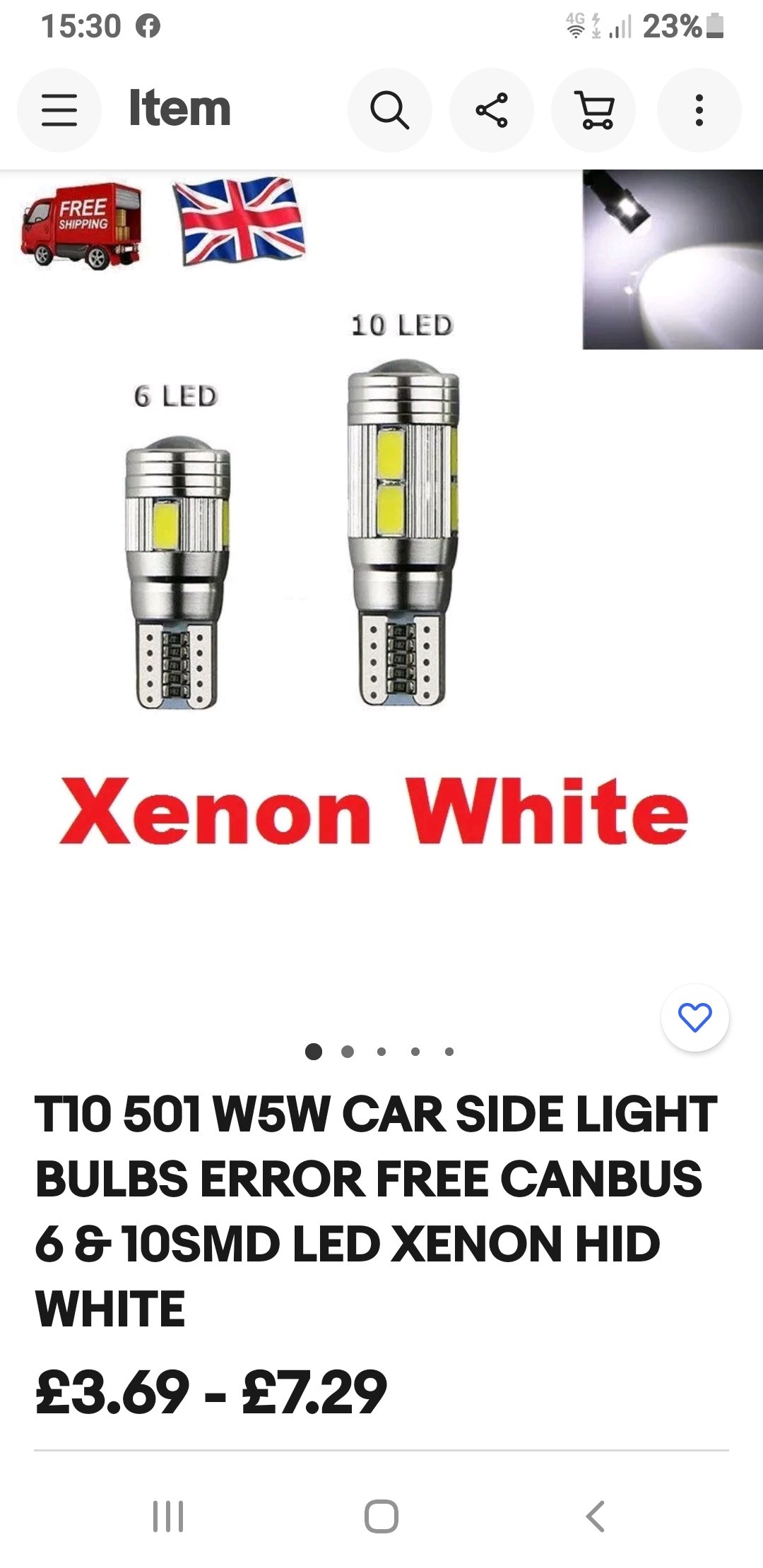

Front Side lights are W5W /  T10 type. I fitted these below. 10smd type.

3 hours ago, Jellybean said:
My Vellfire is not all LED.
Thankyou for confirming this. It is minefield to find right bulb otherwise.
I can see many from AUXITO and ARGO on eBay like below
AUXITO T10 501 W5W 13SMD LED SideLight Bulb Canbus Error Free 6500K Super Bright
Would like up find some make similar in reputation like Philips Sony Panasonic etc so don't need to think twice about quality but I'm afraid most of these led these days tend to be like these unheard names. May be my ignorance. Any knows which make are good leds?

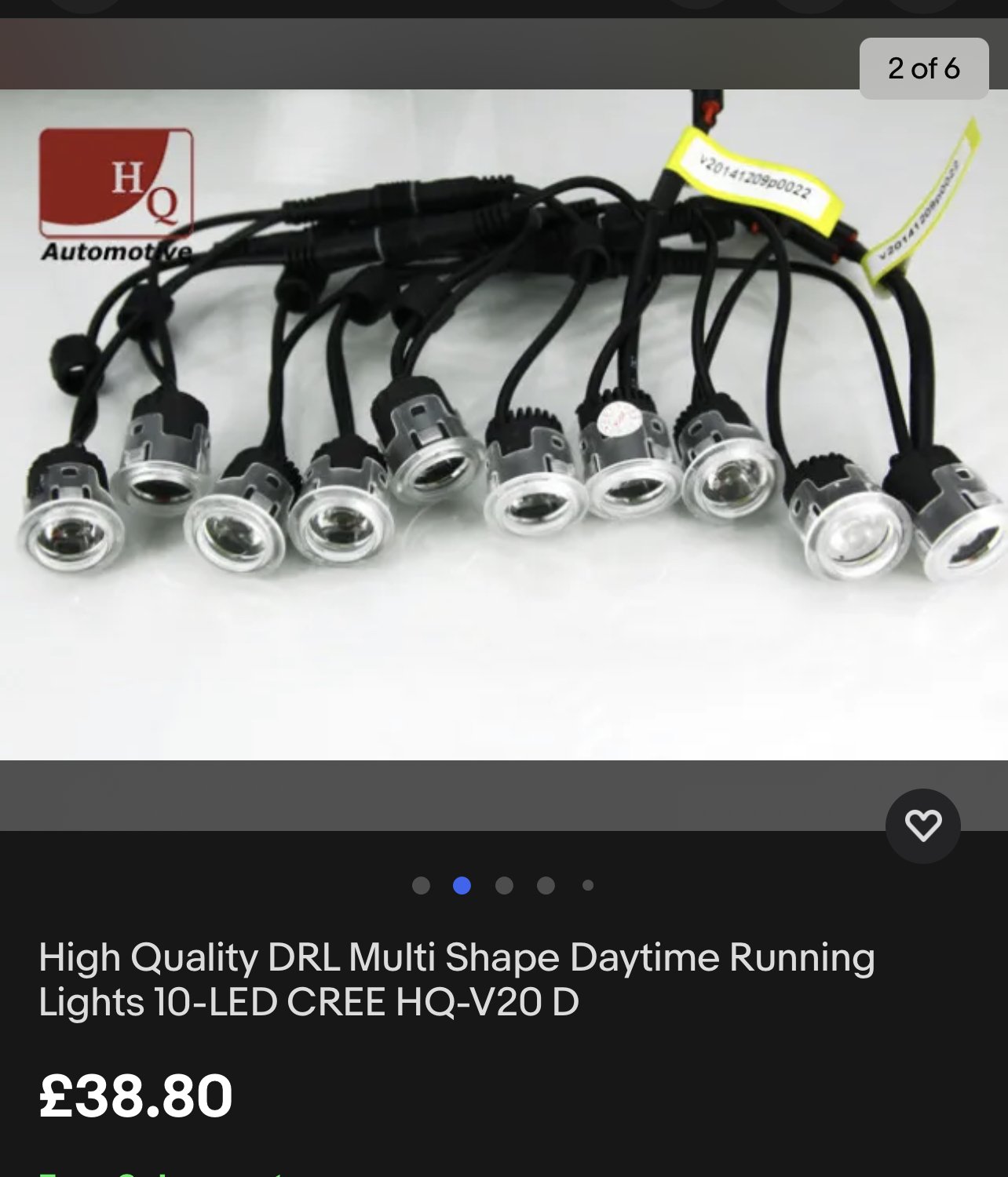

Please also look at the option below. These are individual bulbs and we can get 10 on each side? Can these be fitted as part of the bumper? Last time I bought my led drl, I had exchanged messages with this seller and they were brilliant. By eBay standards I think they are proper sellers. These lift as below have "High Quality DRL Multi Shape Daytime Running Lights 10-LED CREE HQ-V20 D" the last bit v20 a b c d, not sure what the difference is. If anyone finds out please share. I'll try to mail / call them at some point. Individually fitted drl bulb can be effort but will look great. One from previous post are easy.
Please note it's lighting / wiring will need to be done in a way the it connects to headlight wire. Moment you turn headlight on it turns drl off. I might be stating the obvious. Also I fitted a switch for drl, so I can turn it off if I wanted. In nighttime you might be parked somewhere and not need DRLs blasting pure white light
