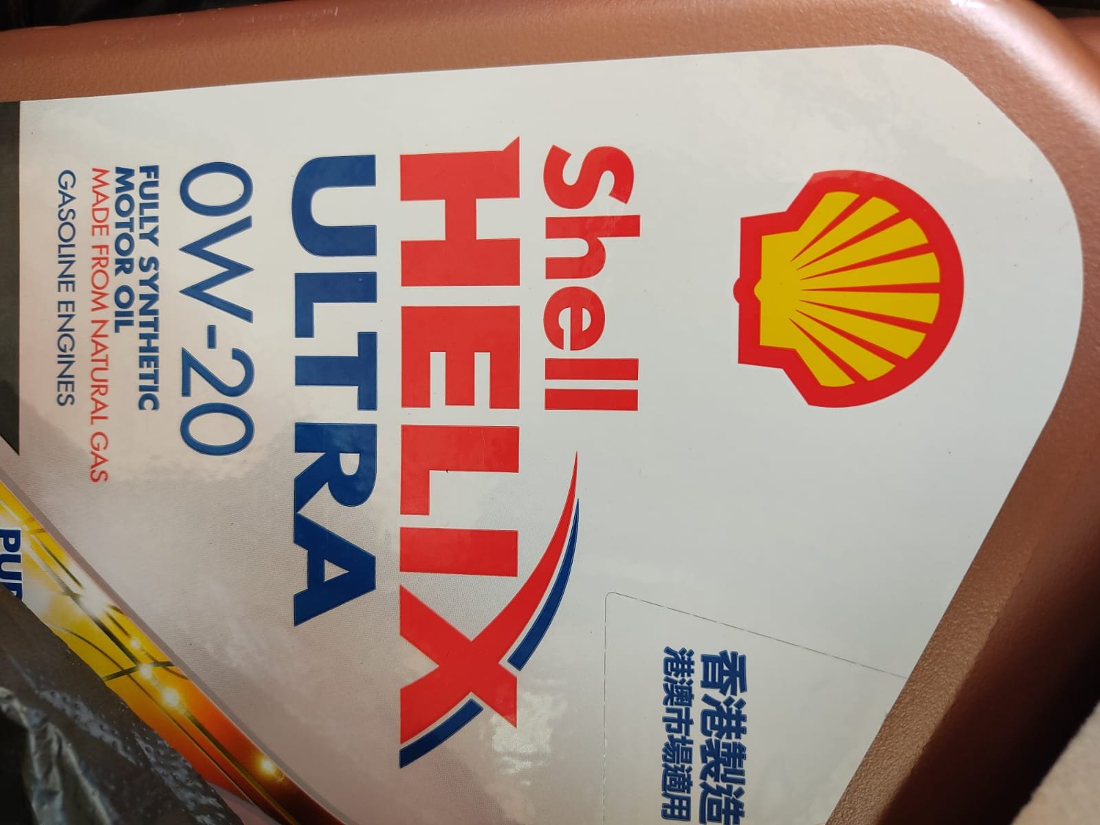

I have used 0w-20 right before I transported my Vellfire from HK to UK as I think Uk is much cooler. Do you agree with it?
Do you have any recommendations for my next engine oil?
