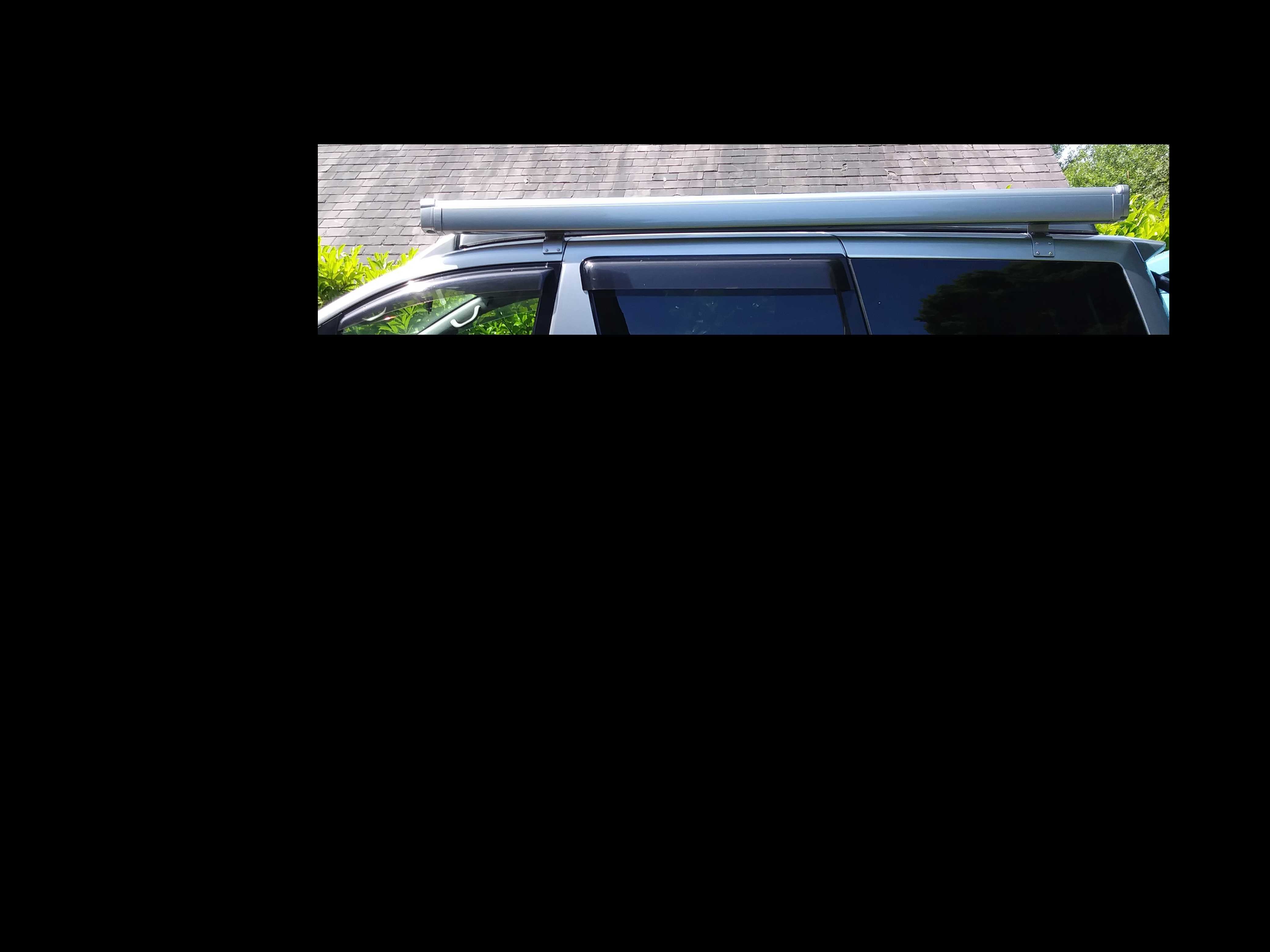

Hi Neil,
Our converter (Wellhouse) fitted a Thule Omnistor 4900 wind-out awning alongside the pop-top. Not sure if the brackets were standard or customised for the roof slope - you may be able to see from the photo.
Incidentally, I've taken to referring to it as a 'canopy' rather than awning, which more people now call the drive-away tent structure fixed to the side - can make a difference where campsites charge extra for awnings.....
In terms of use, we've found that extending it only part-way out is useful for shelter from rain when side door is open, and robust enough to hang wet gear etc., but fully extended it just needs more attention to manage flapping / pooling with water. Also, setting the rear leg slightly shorter than the front leg gives a rain run-off. Not had sufficient sun on a windless day yet to need it fully extended for shade! We can still dream...
