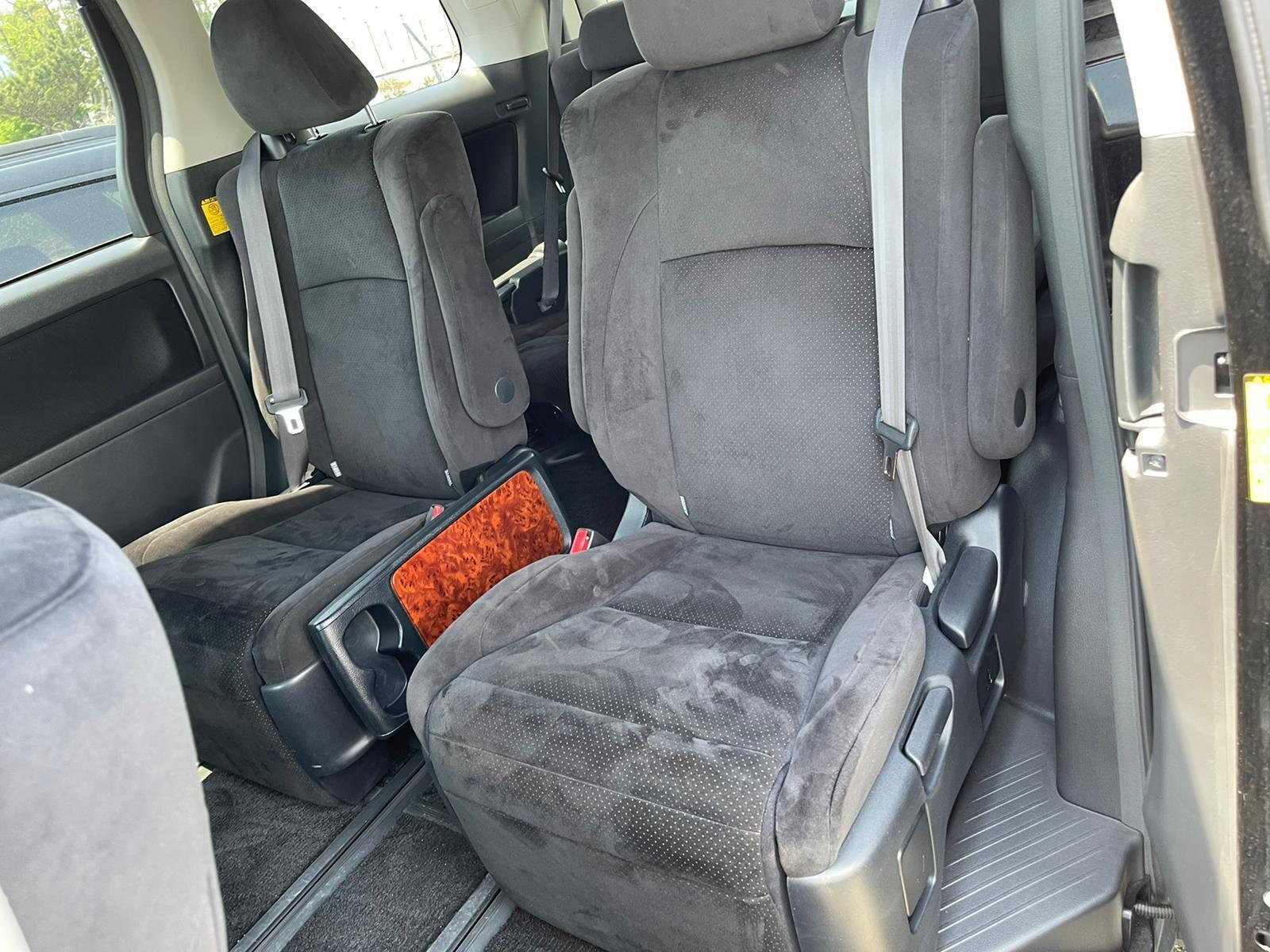

I noted on the first edition, the seats could be rotated, this facility has been removed on the second edition. However on the non-electrical 7 seater, is it possible to remove the seats and place them back in reverse so all four passenger seats face each other, they share the same rails and I could do this on an Espace I used to have.

Seat belts are integrated fully into individual seats, so no issues facing backwards, just not sure if it can be done and if so, will they still slide.

I haven't bought yet, but was looking at the version 2 (08-15) in the 7 seat version and the middle row 2 seats have the belts fully integrated into the seats. So I assumed on the non-electric middle row seat versions the seats were reversible (lift them out of the rails, turn them around and put them back in so they can face backwards). I know they don't swivel as they stopped that at the end of version 1 in 2008.
Edited by robwalley1963
Added picture

I have seen and spoke to a guy who has the 7seater vellfire, and yes he has turned his middle seats around by unbolting them, but he said that they didn't slide so unless anyone knows how to slide the seats when turned they won't be able to use them as a bed, but they definitely can face backwards

I agree. This probably can be done.
Care needs to be taken that the seats are fitted in the 'ideal' position, as they will be fixed.
There is another complication.
Seat belts.
If the middle seats do not have lap straps *which attach to the seat itself) they will fail the MOT as the seat anchorages in the C pillar cannot be used.
Lap strap seats were available in the seies 10.
All this, based on my knowledge of a series 10, not a series 20.
The anh20 has its seat belts attached to the seats so not a problem, just the fact you might not be able to slide anymore
