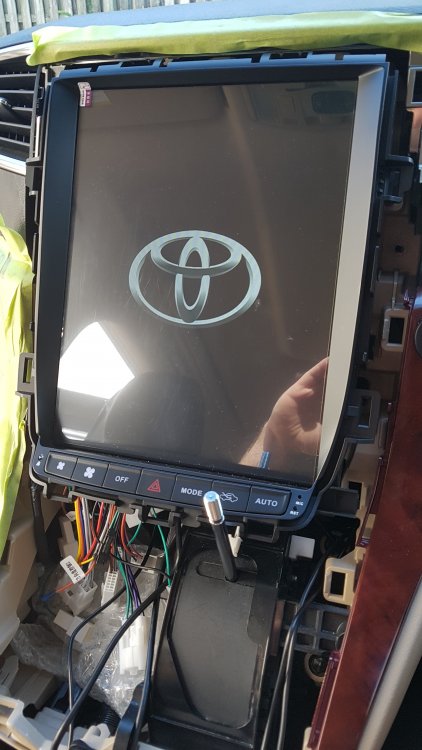

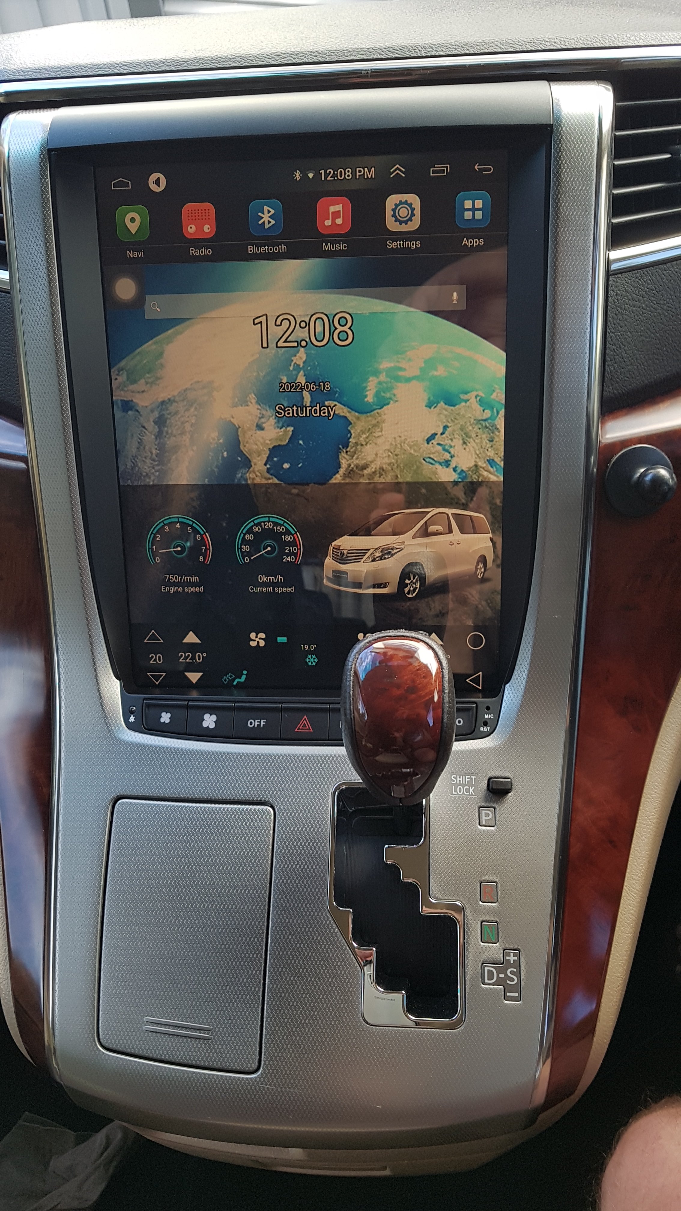

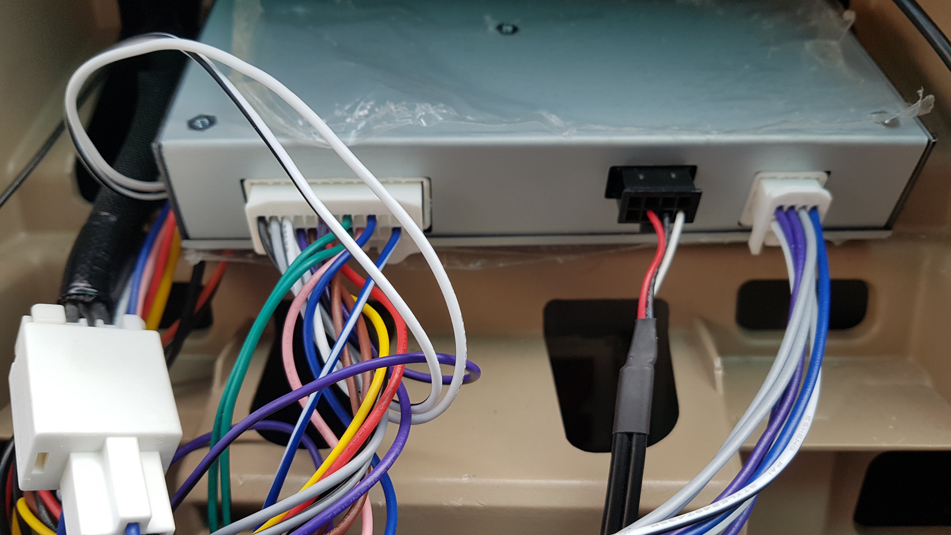

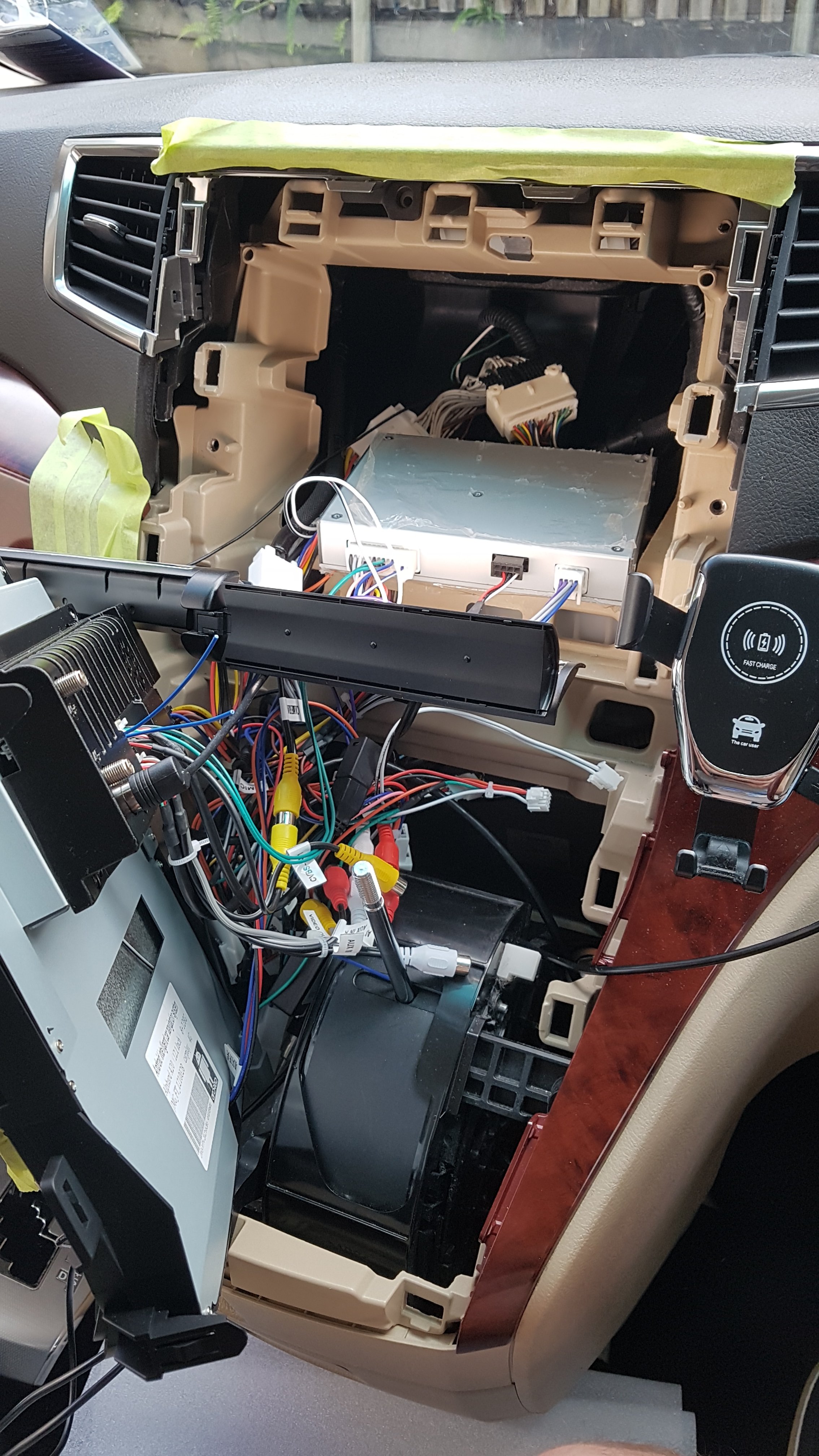

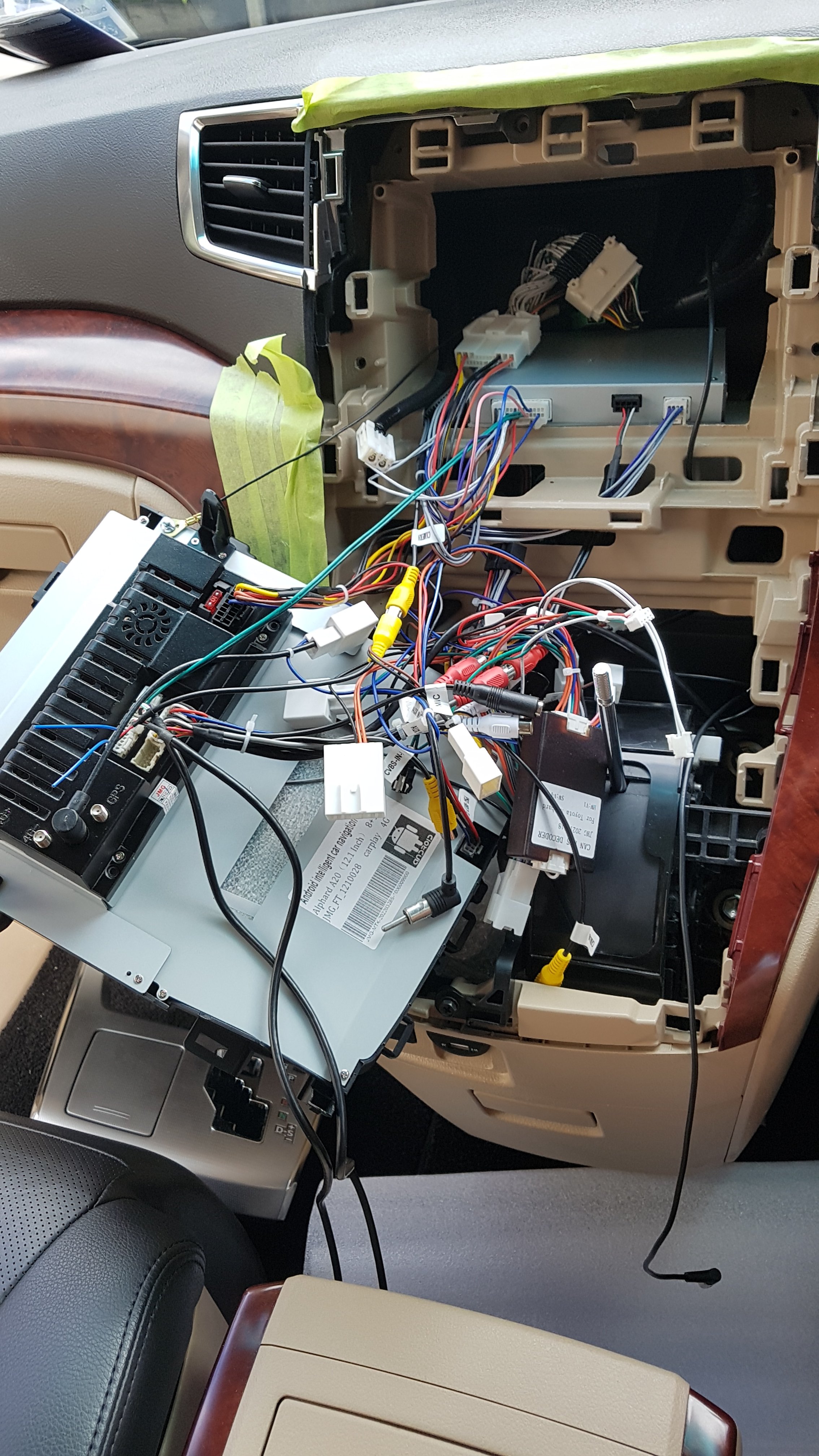

Damo_Oz Posted August 1, 2022 Posted August 1, 2022 (edited) After months of waiting for the Alphard to get to AUS from Japan with shipping delays in late 2021 and compliance plate shortages here we got the Alphard on the road. One major thing was an issue from the beginning........the original head unit with CD, DVD, etc. All in Japanese and constantly chatting about who knows what! After hunting around and getting advice from my Bro in-law who owns a Car Audio installation business interstate we decided upon this unit: https://www.aliexpress.com/item/1005003522580371.html?spm=a2g0o.order_list.0.0.60cf1802EZPwgG which had to be installed with an optical box or it simply would not work: https://www.aliexpress.com/item/1005003953692442.html?spm=a2g0o.order_list.0.0.60cf1802EZPwgG Seemed easy enough but be warned, it is not simply a "plug n play" unit. There are way more cables supplied with these units that you will need due to the variations between Alphard variants. After much foul language and frustration I was tempted to just pay someone to finish the installation but contacted the supplier on Ali Express who put me in direct contact with one of their Factory Engineers. He was outstanding and even though there was a bit of a language barrier we had several back and forths via Whatsapp exchanging photos of what I had and him sending photos of what it should look like, there were a few things I got wrong. I did my best but these things do not come with instructions! I highly recommend one of these but be warned, the easiest part of the install is removing the trim, fascia panel and original head unit. If you do go down this rabbit hole and you get stuck, don't be like me and spend weeks trying to figure it out solo! As you will see from the pics, it's a tad fiddly but wow, it looks and works brilliantly! Edited August 1, 2022 by Damo_Oz 1 1
Voodoo101 Posted August 3, 2022 Posted August 3, 2022 Looks nice. Question for you, what is the optical box for. I have just installed and Android Head unit and it all works, but dont have the optical box, but I do have an extra plug that seems to go nowhere, top 1
Damo_Oz Posted August 4, 2022 Author Posted August 4, 2022 Thanks. To be completely honest I really don't know exactly what it does! I do know that without it, I couldn't finish the install. There was a week delay between receiving the head unit and the box. I tried to get it working without it and......no go! 1
R4v3n Posted August 4, 2022 Posted August 4, 2022 Well, I'm sorry if you didn't found this one, but it seems to be full plug & play : https://www.dvdgpsnav.com/blog/toyota-alphard-head-unit-replacement-android-radio-upgrade-navigation-multimedia-system-tesla-style/
Voodoo101 Posted August 5, 2022 Posted August 5, 2022 On 8/4/2022 at 7:26 AM, R4v3n said: Well, I'm sorry if you didn't found this one, but it seems to be full plug & play : https://www.dvdgpsnav.com/blog/toyota-alphard-head-unit-replacement-android-radio-upgrade-navigation-multimedia-system-tesla-style/ Expand They are all just Android head units, just in a different orientation. The wiring is general, but you have to add a box to translate the signal that comes from the ECU to something that the head unit can understand. This is what the optical box is, it's a canbus. If you don't have the amps then you can get away with just the normal head unit, although with this you need it because it has to control the vents. 1
redsome Posted August 5, 2022 Posted August 5, 2022 On 8/5/2022 at 1:46 AM, Voodoo101 said: They are all just Android head units, just in a different orientation. The wiring is general, but you have to add a box to translate the signal that comes from the ECU to something that the head unit can understand. This is what the optical box is, it's a canbus. If you don't have the amps then you can get away with just the normal head unit, although with this you need it because it has to control the vents. Expand So if you use the optical bus, the alphard sound system with 18 speakers can support it? because in Vellfire premium sound (18 Speakers), it uses a different audio system can anyone explain?
Chris.ac Posted August 5, 2022 Posted August 5, 2022 they call it optical box, but it has no optics. From what I have gathered, there are 3 boxes you can get, one is a LVDS convertor, it is able to take the blue square gvif connector that the parking assist ecu connects to, and convert that video signal (if you have the front/side/rear cameras and sonar) and into a single phono o/p) this then feeds in to the android unit (You can then keep the original car cameras) or you use their supplied rear camera. The next box is the canbus box, this will feed info related to doors open, climate control, speed. and provides some form of control over the configurable aspects of the alphard, such as auto lights, locks, windows. The optical box, is used to provide the signals to feed the external 18 speaker amplifier (the 18 speaker system has an 8 wire connection from the stndard head unit to the amplifier) I imagine it also supports the rear screen 1
Voodoo101 Posted August 25, 2022 Posted August 25, 2022 This is the item you need for the 18 speaker system I think. Car Android Radio Cable Connector Socket Power Wiring Harness with CANBus MOST Decoder for Toyota Alphard Lexus IS250 IS300| | - AliExpress This is the one for the doors etc. Beware of the seller though as they are not helpful at all. They sent me just the cable and I'm still fighting with them to get it sorted, but it is the only place I have found the unit. Skyfame Car 16pin Wiring Harness Adapter Canbus Box Decoder For Alphard 20 Android Radio Power Cable - Speaker Line - AliExpress

garych Posted July 17, 2024 Posted July 17, 2024 I have a 12.1" Tesla style screen android unit purchased from dvdgpsnav, it has video output to support rear screen, and my 18 speaker system still works after installation, there's not a fiber optical box outside, maybe it's inside the unit. If you would like to check it, here's the link: https://www.dvdgpsnav.com/blog/toyota-alphard-head-unit-replacement-android-radio-upgrade-navigation-multimedia-system-tesla-style/ any questions you can contact them directly via email or contact me.
