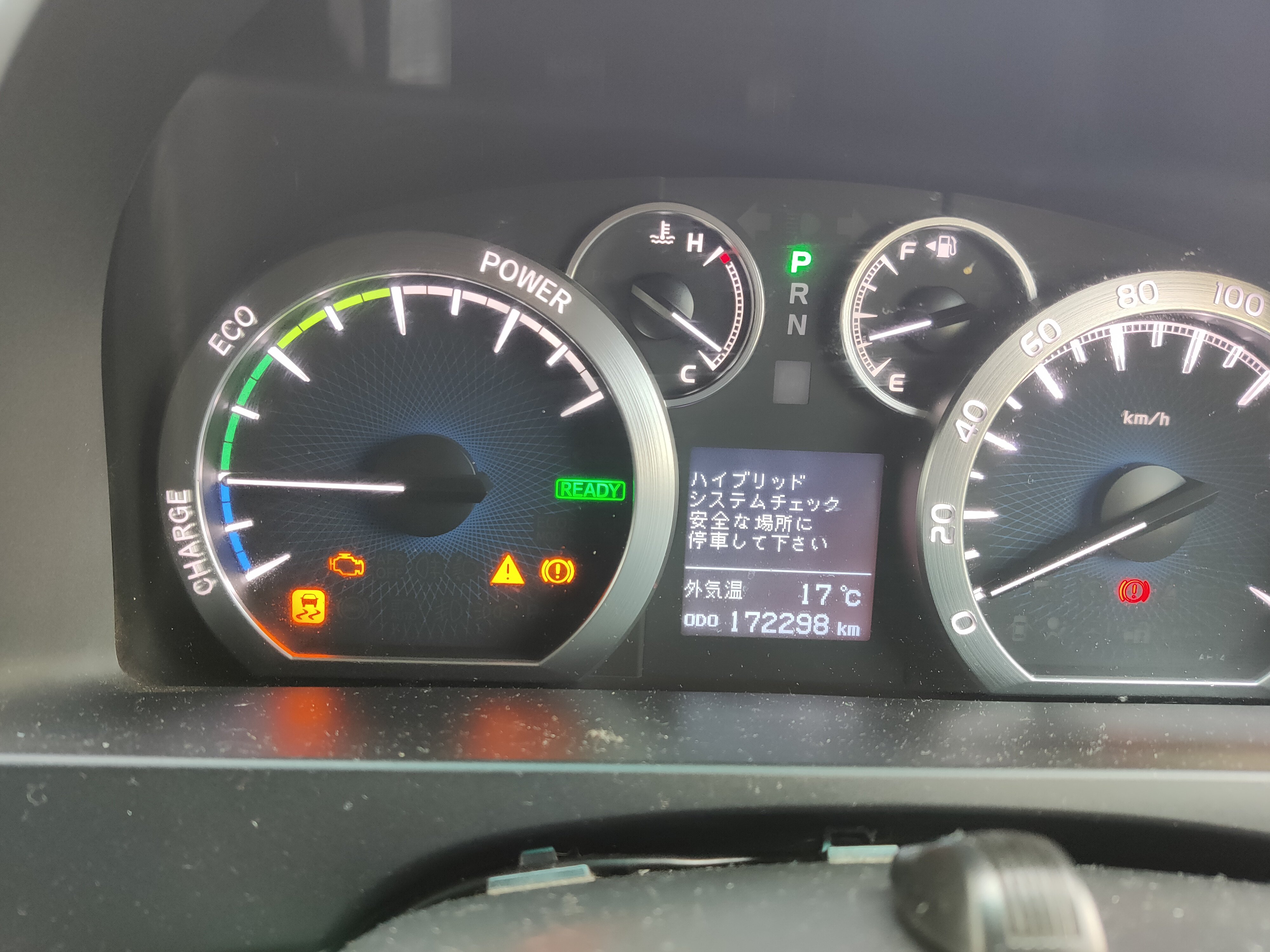

I replaced a new 12v battery in my 2012 model Velfire. After a couple of days 4 warning lights came on whilst I was driving (plz see photo). At the same time various things stopped working, like Cruise control, only petrol engine operational.

Well, I don't own an hybrid version, but I own a prius 3.
The japanese message is telling you to check the hybrid system.
First thing to verify in this case is the 12v battery voltage, if it's too low for the computer, it will warn you there's a problem.

I suspect it's the hybrid battery system, rather than the 12V. The 12V is required to boot up the hybrid systems when first starting it up. If the battery isn't working properly or doesn't have enough voltage, you'll know, because it will fail to switch on. But all engine functions should run off the hybrid battery after that first step, including restarting the engine, so I can't see why the 12V battery would cause the car to go into a safety mode while it's actually driving.
