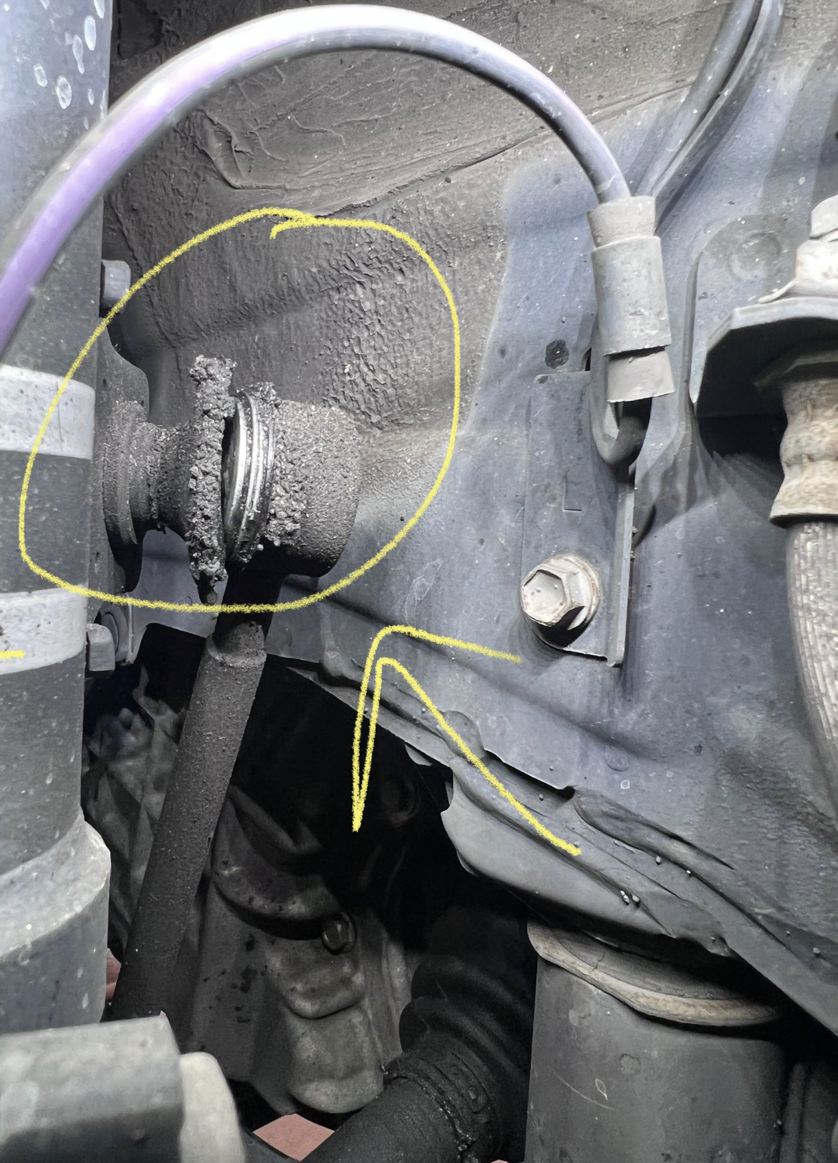

Teekay Posted October 27, 2022 Share Posted October 27, 2022 Rubber boot for drop links in front suspension are split and I need to find replacements. Please see the attached picture. Anyone else faced this and found part number or substitute for other Toyota models, if you can share it, that will be much appreciated. I’ll also keep looking. Thank you Quote Link to comment Share on other sites More sharing options...
Teekay Posted October 27, 2022 Author Share Posted October 27, 2022 4 minutes ago, Teekay said: Rubber boot for drop links in front suspension are split and I need to find replacements. Please see the attached picture. Anyone else faced this and found part number or substitute for other Toyota models, if you can share it, that will be much appreciated. I’ll also keep looking. Thank you https://toyota.epc-data.com/alphard/ggh20w/62602/chassis/4803/48820B/ this seems like part diagram Quote Link to comment Share on other sites More sharing options...

Rojie Posted October 27, 2022 Share Posted October 27, 2022 3 hours ago, Teekay said: Not registered yet! Does not need to be ! You don't need it registered to have a VIN number ! The VIN belongs to the vehicle, not the DVLA. You should find it in the B pillar, passenger side. It Won't look like a European one, because it isn't. Picasso is trying to help you. I checked the EPC myself, and there does not appear to be a rubber boot on there. There are more than one stay bar, maybe the boot comes attached to the correct one ! Quote Link to comment Share on other sites More sharing options...

Teekay Posted October 27, 2022 Author Share Posted October 27, 2022 If anyone looking for same, I’ve received confirmation that part no we need blueprint is ADT38580 autoharp spare sells them, you can Google perhaps many more vendors Quote Link to comment Share on other sites More sharing options...

ThuMentaliss Posted October 28, 2022 Share Posted October 28, 2022 only issue is how long has this boot not being able to stop the crudd entering the joint...personally I would change the complete arm 2 Quote Link to comment Share on other sites More sharing options...

Teekay Posted October 28, 2022 Author Share Posted October 28, 2022 9 hours ago, ThuMentaliss said: only issue is how long has this boot not being able to stop the crudd entering the joint...personally I would change the complete arm Great point! I need to find decent mechanic to get my wish list of checks and preventives started Quote Link to comment Share on other sites More sharing options...

Alphard Club Posted October 31, 2022 Share Posted October 31, 2022 On 10/27/2022 at 12:39 PM, Teekay said: Rubber boot for drop links in front suspension are split and I need to find replacements. Please see the attached picture. Anyone else faced this and found part number or substitute for other Toyota models, if you can share it, that will be much appreciated. I’ll also keep looking. Thank you I replaced mine.. made a big difference in handling. Mine were shot. Not expensive if you get aftermarket 1 Quote Link to comment Share on other sites More sharing options...
arthurj Posted October 31, 2022 Share Posted October 31, 2022 My Toyota garage replaced mine no problem, but they weren’t cheap. 1 Quote Link to comment Share on other sites More sharing options...

arthurj Posted October 31, 2022 Share Posted October 31, 2022 9 minutes ago, Teekay said: Roughly how much, I’ll ask my local. £281.78 for replacing both drop links. £89.41 for each link and £95 Labour. Parts 48820-02070 x2 and 90179-12151 x4. 1 Quote Link to comment Share on other sites More sharing options...

Alfie Posted November 1, 2022 Share Posted November 1, 2022 16 hours ago, arthurj said: £281.78 for replacing both drop links. £89.41 for each link and £95 Labour. Parts 48820-02070 x2 and 90179-12151 x4. Blimey! I recently replaced both mine, pretty straight forward with a jack/socket set and checking out YouTube videos. They only cost £16.95 each from https://www.japeurocarparts.co.uk Check with them that the parts fit your model with vin number before ordering. 1 Quote Link to comment Share on other sites More sharing options...
