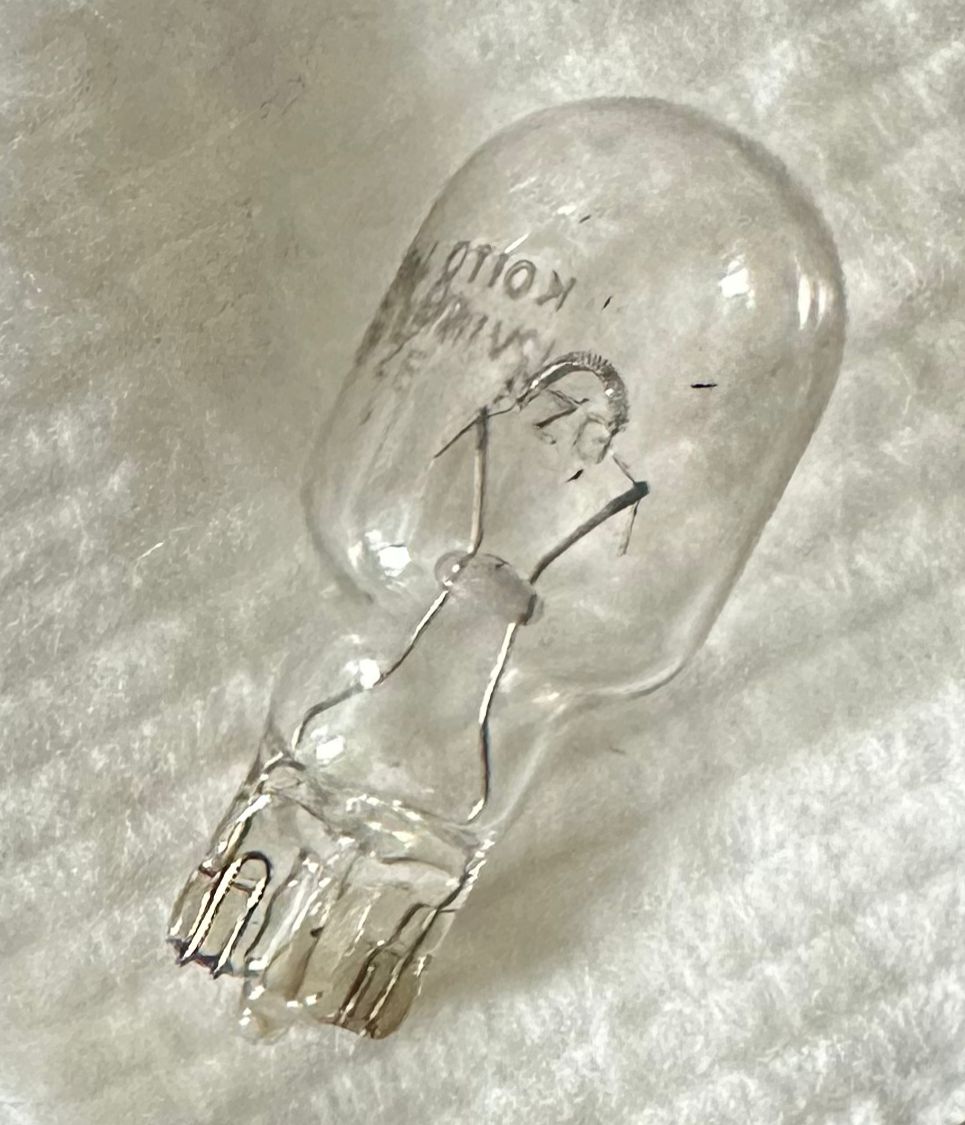

the rear bulb that was in my car that was taken out, and fog light bulb was put in its place, the original bulb says
KOITO JAPAN 921
12V W16W E4 2EL 8ZG
Picture is below:

To remind the original bulb there was
KOITO JAPAN 921
12V W16W E4 2EL 8ZG

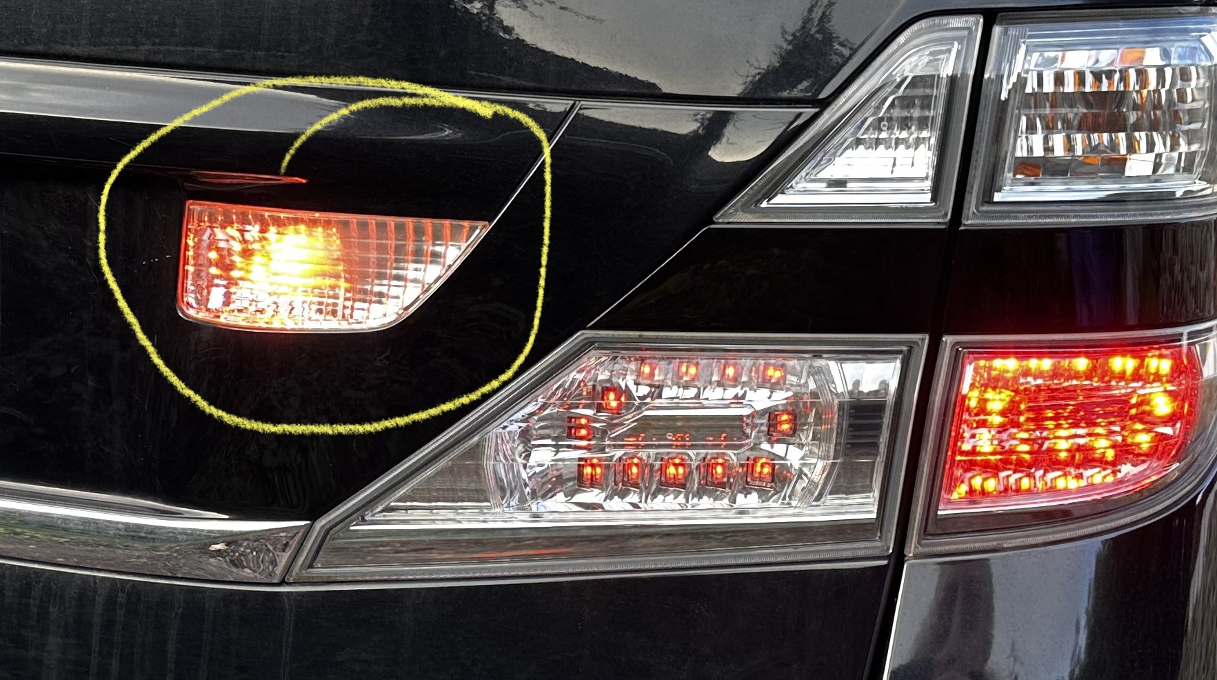

Fog light after conversion is circled in picture below.
