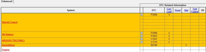

I am currently having trouble with the van with the hybrid system not working.
It stems from November when due to circumstances I wasn't able to use it and the 12v battery went dead- used a booster pack to start as I have done before
but errors appeared on the dash after a few minutes- ABS, VLC, red car. Petrol engine runs but no hybrid- some times everything cuts out.
If I disconnect 12v battery for 20 mins everything works but errors appear again after 10 mins. New 12v battery -the correct one- no better so looking
for answers.

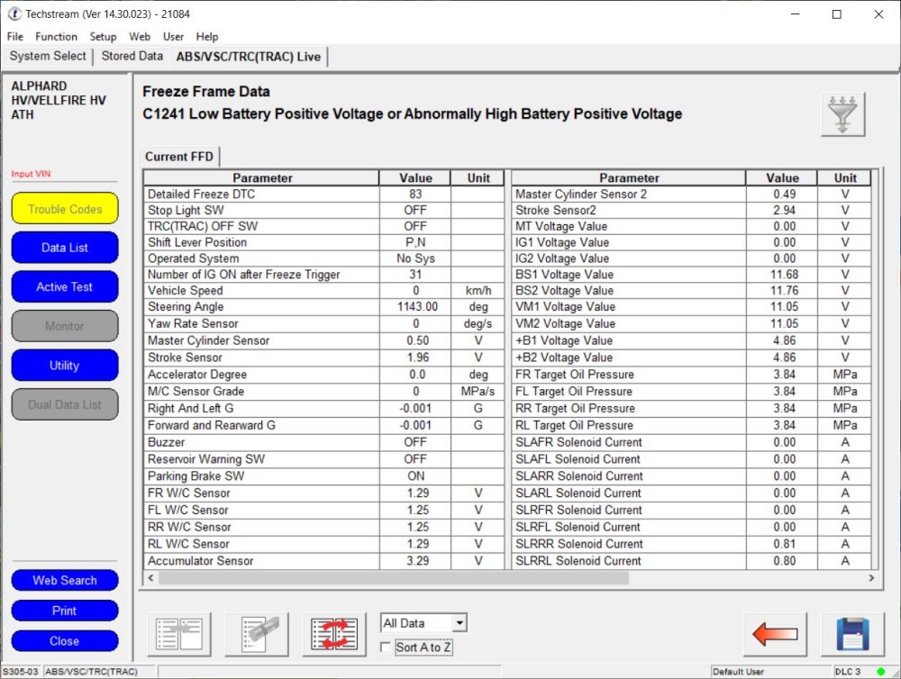

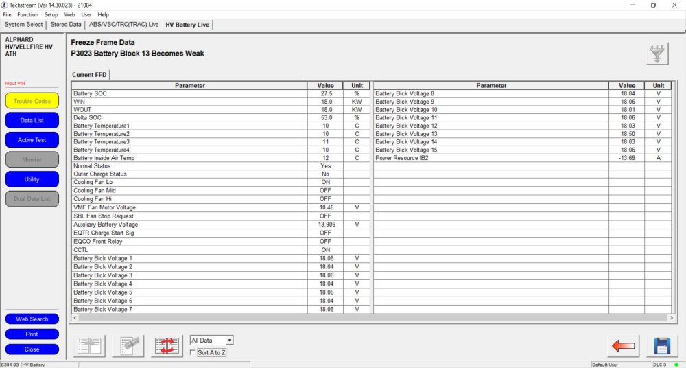

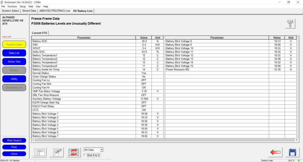

I purchased the "Washinglee" lead from amazon at £79.99- expensive but says will work with 32 and 64 bit windows (7 & 10- mine is Win 10- 64bit) and they give a years tech support. I know other members have done it cheaper.
The instructions were pretty good but the link to Techstream didn't work and the download for the driver put scam ads on my laptop which took a while to clear.
I emailed them and they sent me the zip file with everything on. They warn that anti virus software might delete the 64 bit driver which it did but I was able to
tell the anti virus (mcafee) to accept the file. Followed the instructions and all was well- connected to the van but made the mistake of selecting USA
so Alphard not on list- changed to Japan and all well. Had to run the engine to get all the data on the "Healthcheck" setting.
Am looking for a repairer in the Derbyshire / S. Yorks area or further afield if anyone has any suggestions.
Thanks for this Paul as I have the exact same trouble lights showing on the dashboard. Did you also notice that the dash battery health monitor is showing that the HV battery is loosing its charge very quickly (With accessories on such as blower/AC etc.) as well once the engine is running the HV battery charges back to 3 & 4 green bars? And does your hybrid drive system for the wheels operate as mine no longer does (Indicating that the HV pack lacks the capacity to drive the wheel motors) I have come to the conclusion, based on how old my HV pack is (20 years), having the vehicle sit for a number of weeks undriven more than a few times and the behaviour with the HV pack dropping its charge and recharging quickly to full that the HV battery has “Run its course” and requires replacing.
I am going to replace the whole battery pack as taking apart the console area is a fair job and I don’t wish to do it repeatedly as modules fail, one by one (Reconditioning the HV pack or replacing individual cells/modules)

I suspect the HV pack is faulty  as when the system is working it charges from one to four bars then drops again - a couple of times the van has shut down completely and I think it is when I put the heater on- not sure if this is connected.
