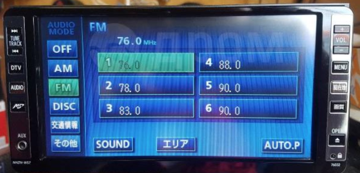

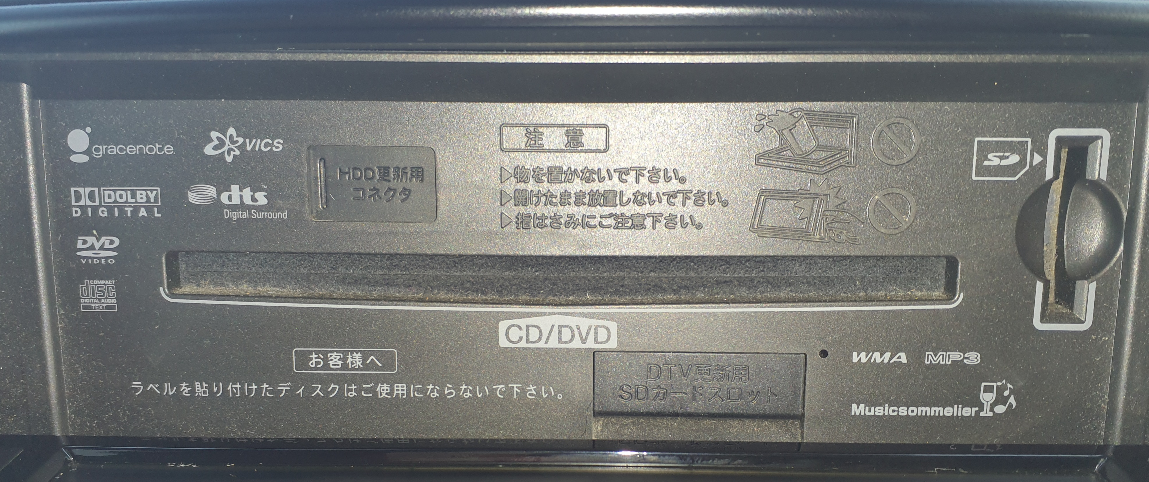

1) What I want to ask is, why won't the front panel open when the eject button is pressed (page 1 -10 pdf). And why it won't open from the touchscreen, from both touch onscreen selections (page 1 -14 pdf)?
The buttons beep when pressed but the panel wont flip down. I've set the angle of display from small to big (page 1 -14 pdf). But the screen panel still doesn't open.

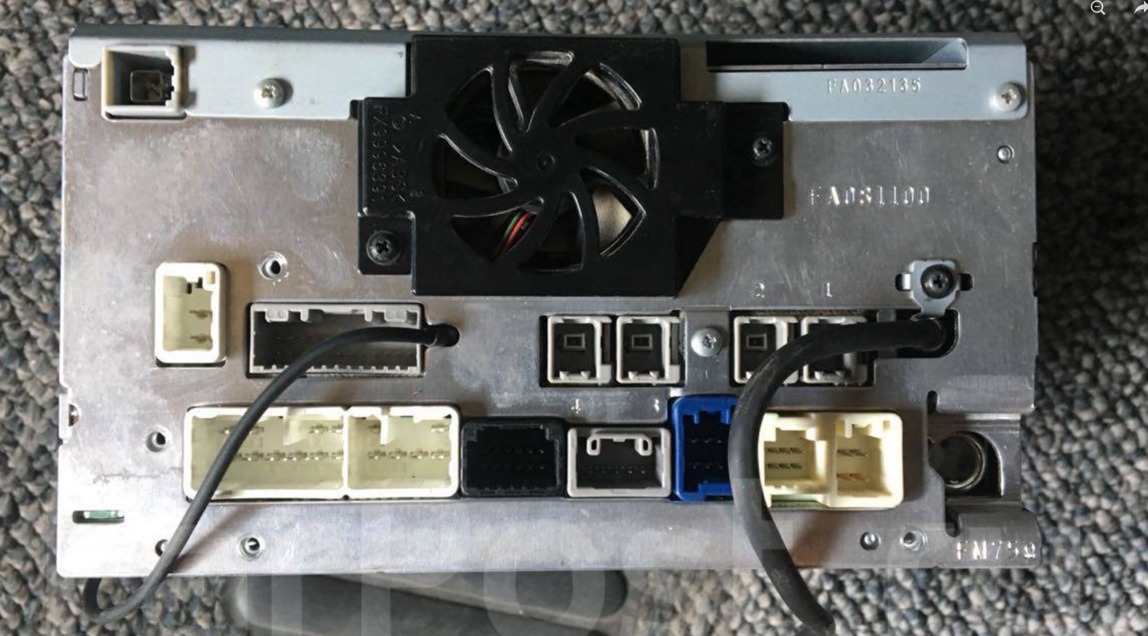

2) Are these NHZN W57 units re- flashable with a UK software conversion package of some sort for the main menus and sat nav maps , main radio and dvd functions?
Are the cables that connect to the rear of the stereo compatible with any English stereo head unit with CCD (camera) ? Without having to install a new rear camera and other wires?
Has anyone upgraded the head unit and used the same in vehicle wiring that the old unit was attached to?
The device powers up and is in full Japanese, text, speech instructions etc. But not managed to tune the radio in or play a cd/dvd because of the panel not opening up.

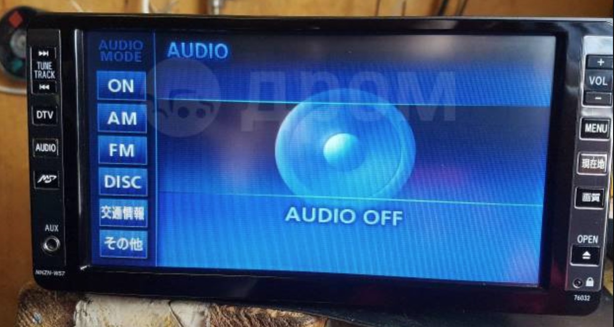

The you tube videos are false. It is someone merely pushing 2 or 3 onscreen buttons for a minute, while trying to guess what they are doing. Pointless waste of everyones time.
There is NO English settings in the software in the NHZN W57 head unit.......... its a Japanese interface for Japan users only, these head units were never intended for English users, unless they understood the language!
Not one of these videos shows a definite explanatory walk through that shows the change from Japanese to English for the NHZN W57 Av multimedia nav system.
Translation is done by phone google translate app, point the camera at the screen or book and read whats been deciphered.
I've been through 3 owner manual books that way !

That blue port on the back of yours is a VTR-in (video in). You can purchase a VTR cable from amazon.jp https://www.amazon.co.jp/-/en/VTR-01-6P-Toyota-NHZN-W57-External-Adapter/dp/B00NPKTAG2

Managed to get the front to open as it should. Possibly last owner didn't use it. So now able to get 1 x AM radio station and 1 x FM radio station working.

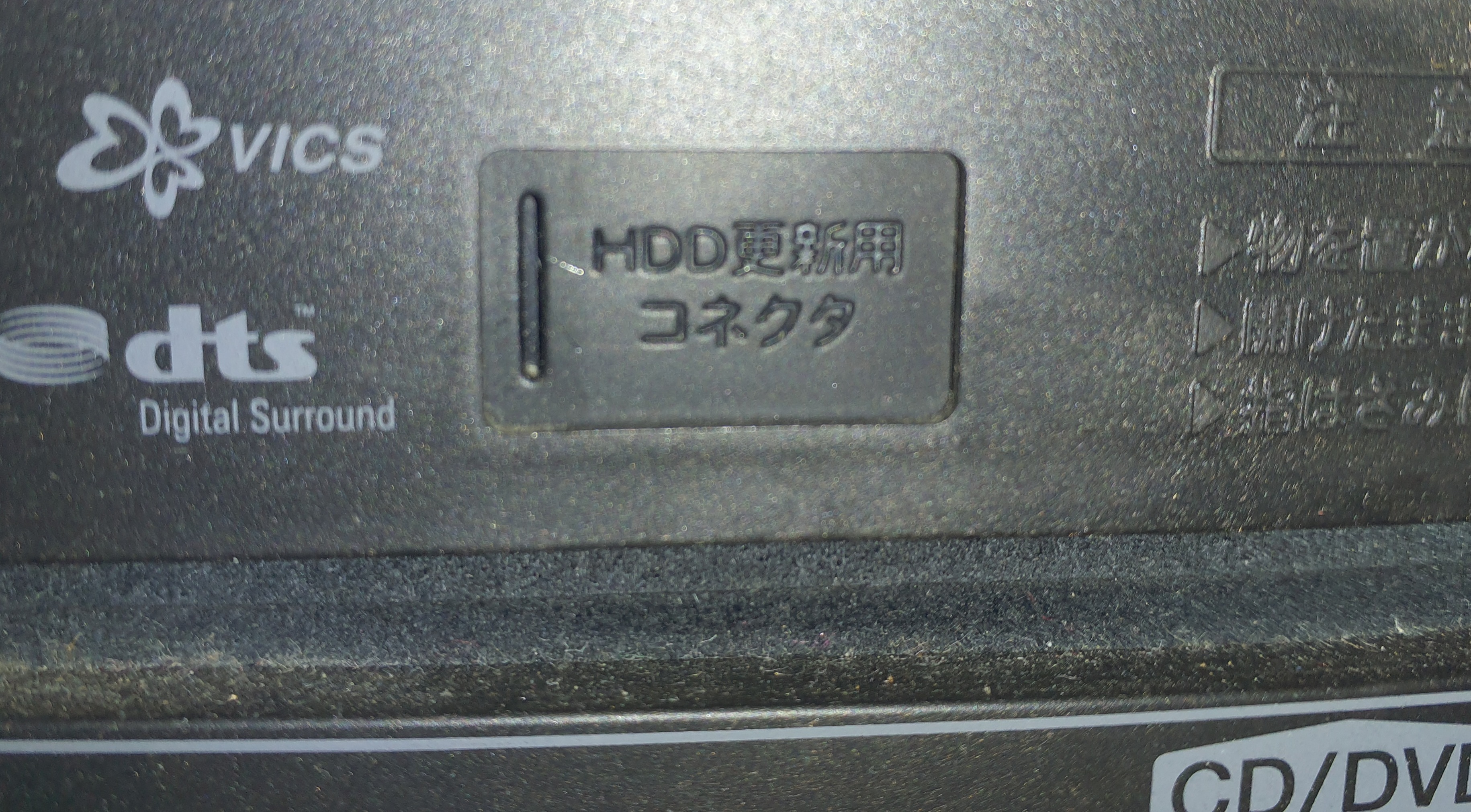

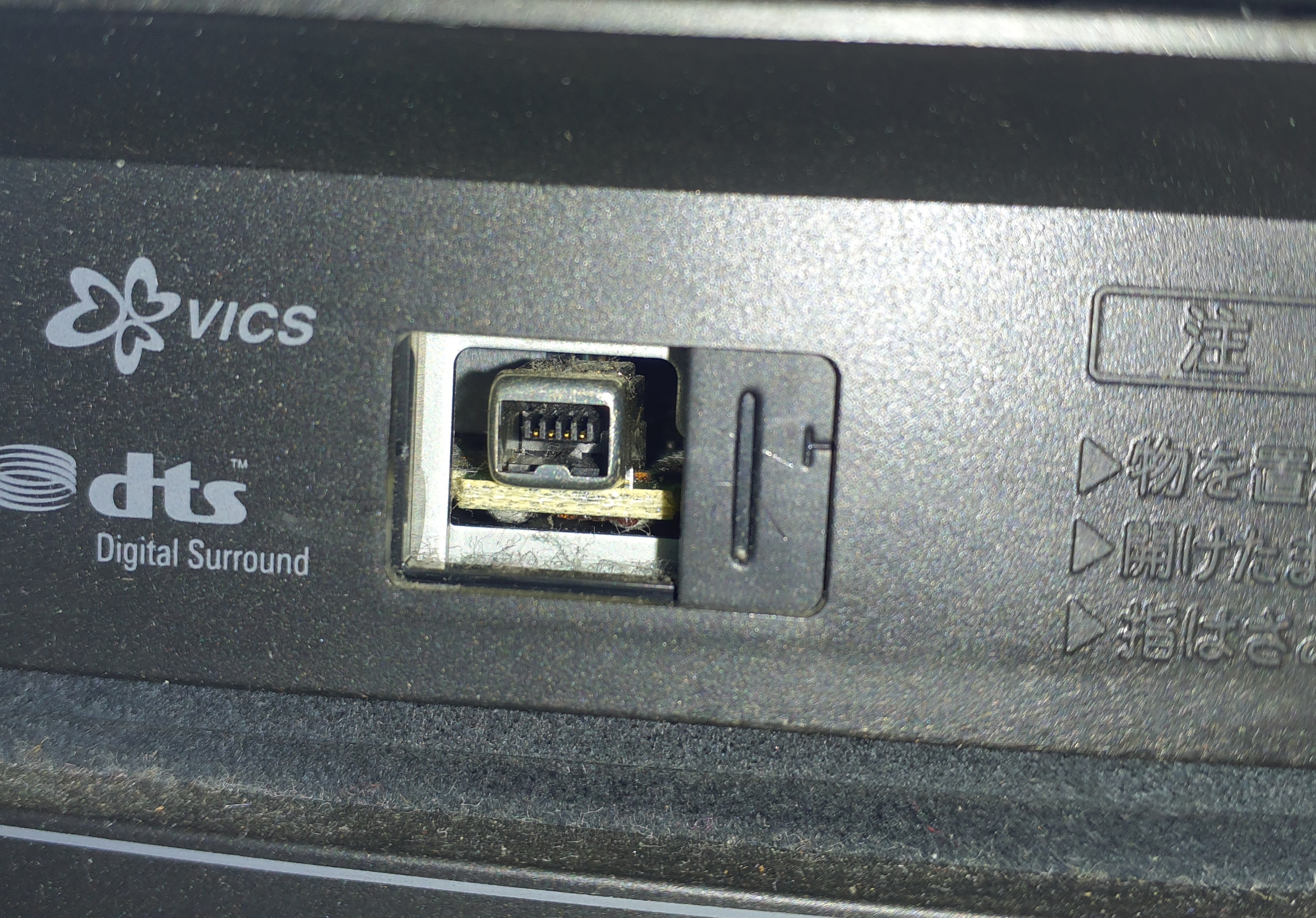

I notice there is a slide door with a usb socket behind it. Looks like the head unit can be plugged into a laptop maybe. Be interesting to find the right lead and computer software. And anyway to put a UK map on it, If any exist.
There is a hard drive in the NHZN W57, I played a CD and the songs were recorded onto the hard drive. Pretty cool!

The problem is, the wiring loom for the headunit  have subtle differences which makes a straight swap more complicated.

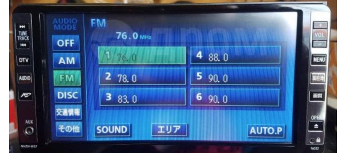

Not a problem! Found my way round the head unit system touch screen settings. It plays cds/dvds and reverse camera works. Sd slot works.
As for the NHZN W57 radio, it doesn't have full range FM. Japan bandwidth narrower than UK.  Japan radio FM range covers 76 - 90mHz only. And thats the range to choose from onsreen.

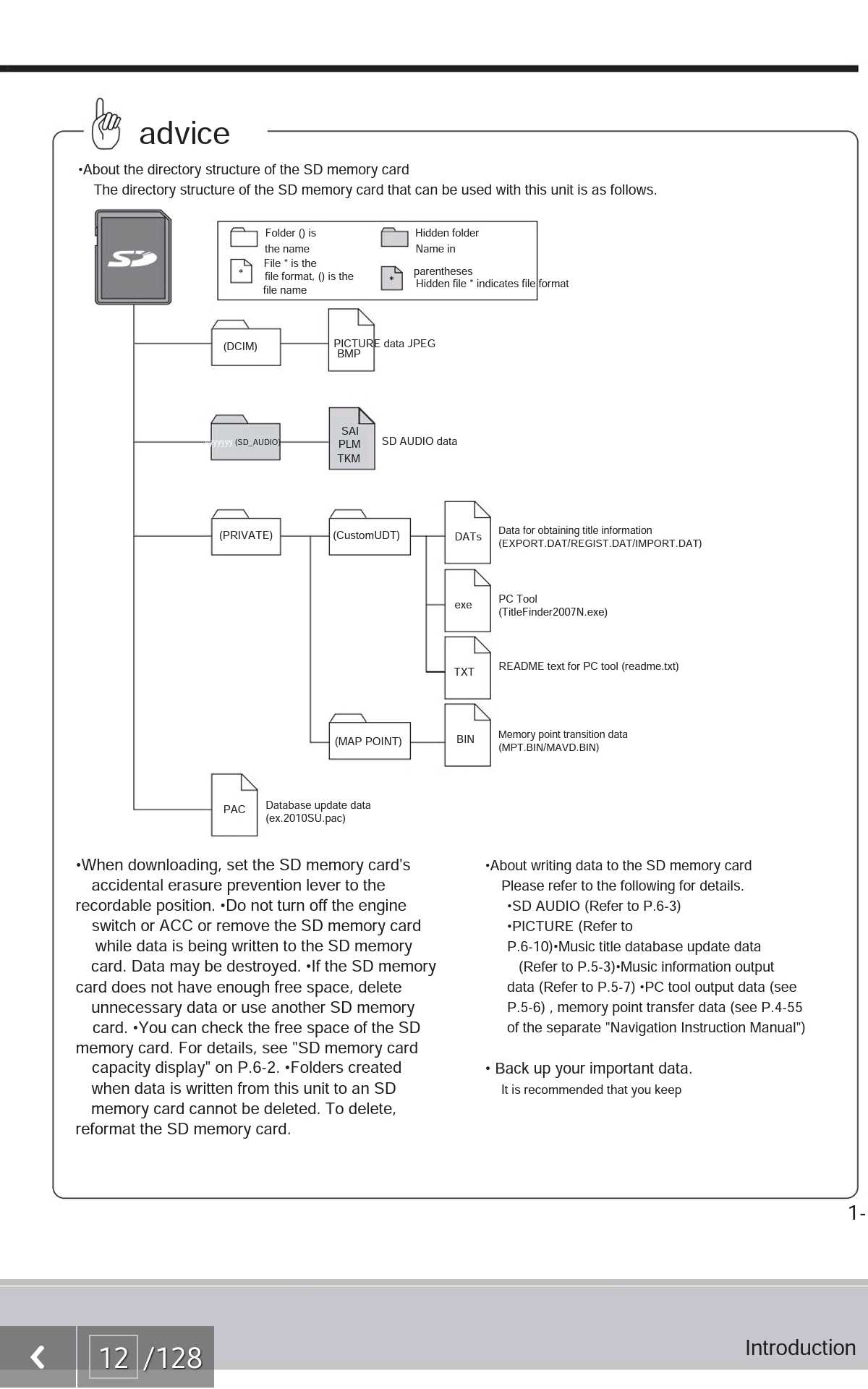

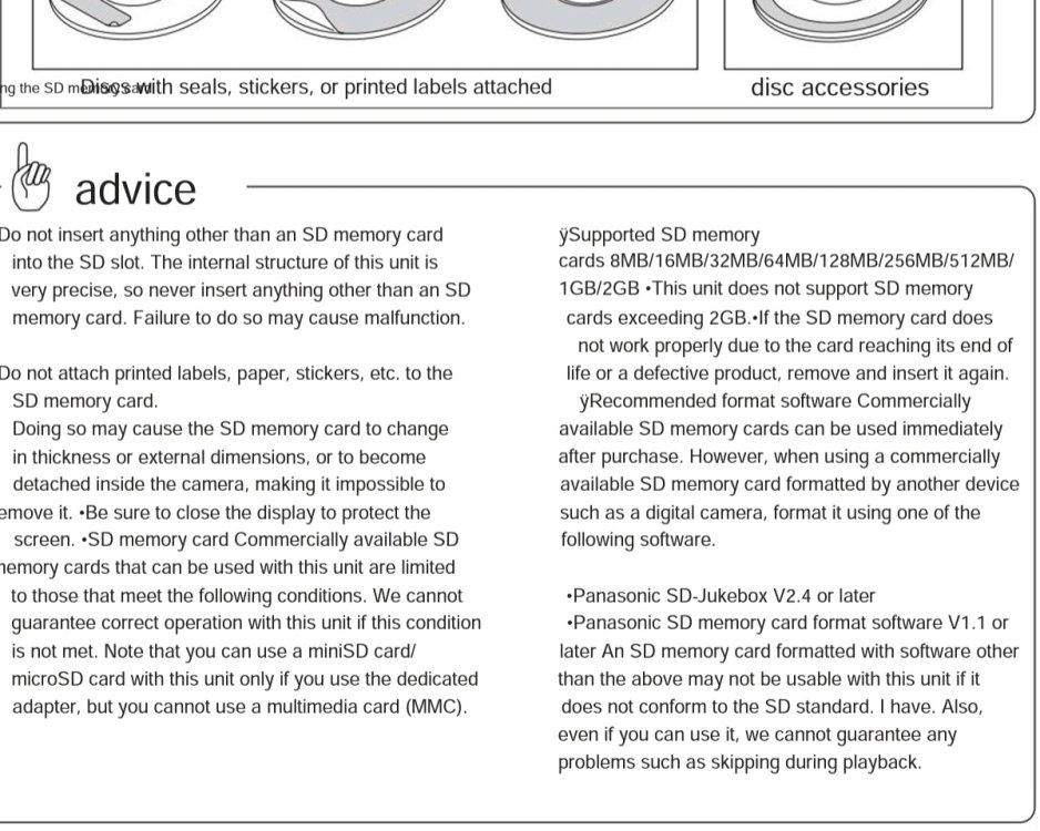

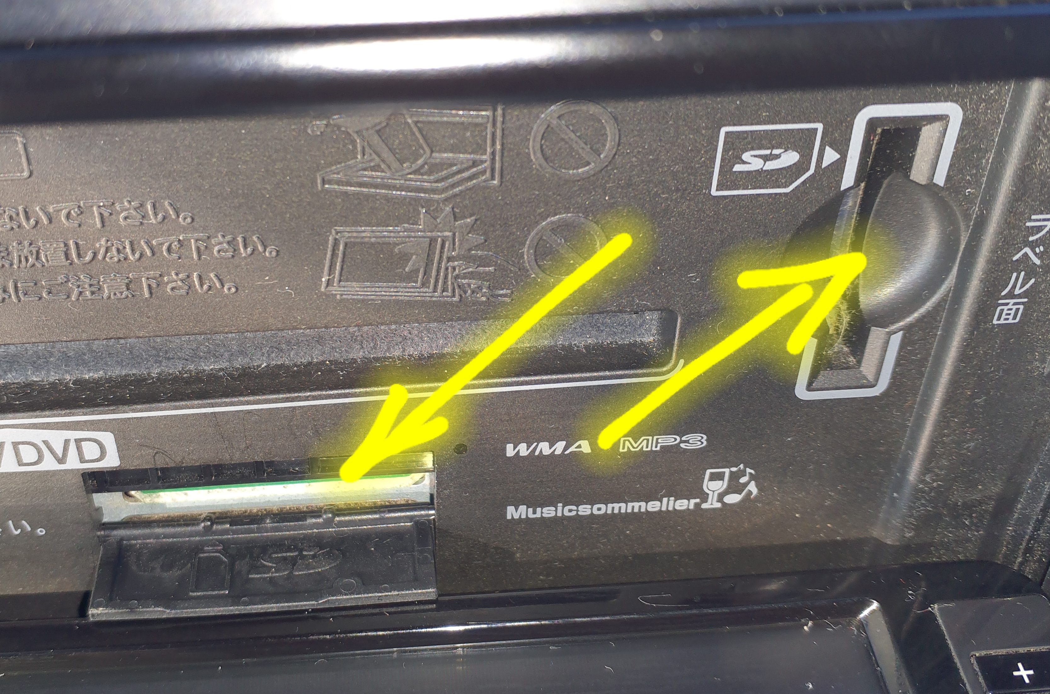

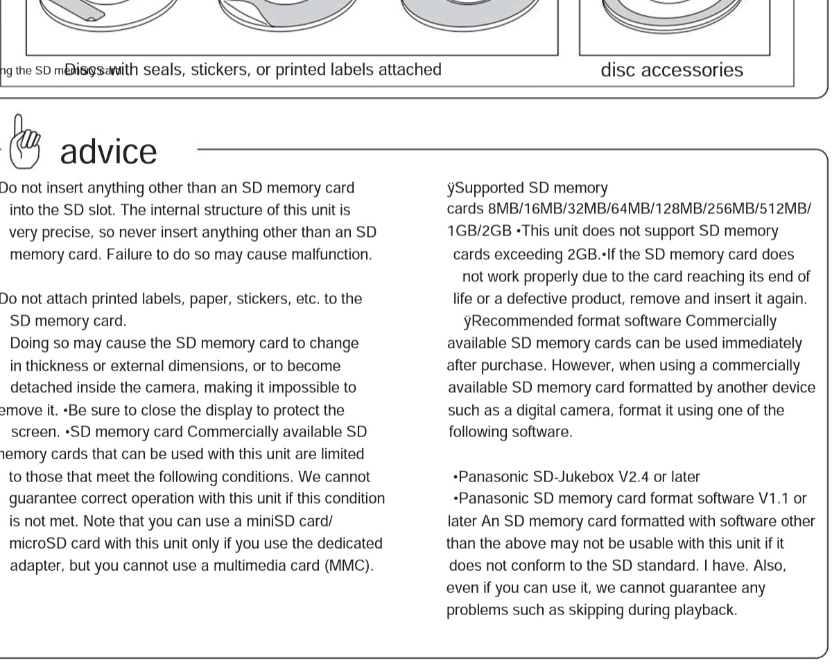

For anyone with the same system (NHZN W57), there are 2 SD card slots. And from the instruction manual is suggests the maximum sized SD card the head unit can use is 2GB max only. Including micro sd in an adapter or full size.
I tried a 128GB card in it and it didn't register.
I understand the head unit can format the SD card into the file structure as depicted in the manual ready for use. See pics.
There is a mention of using a specific Panasonic Jukebox pc tool software to convert or code songs to wma or mp3 format on the SD card.

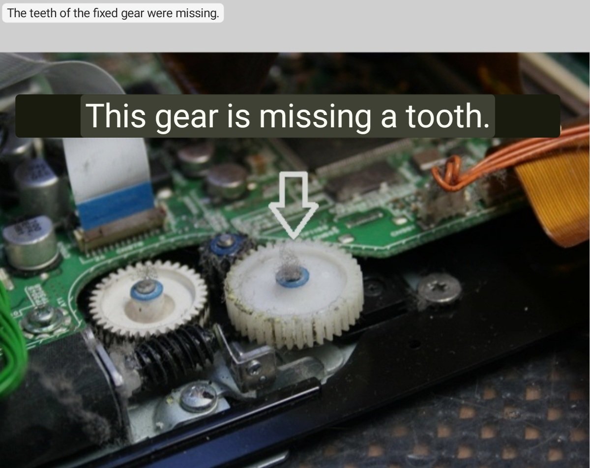

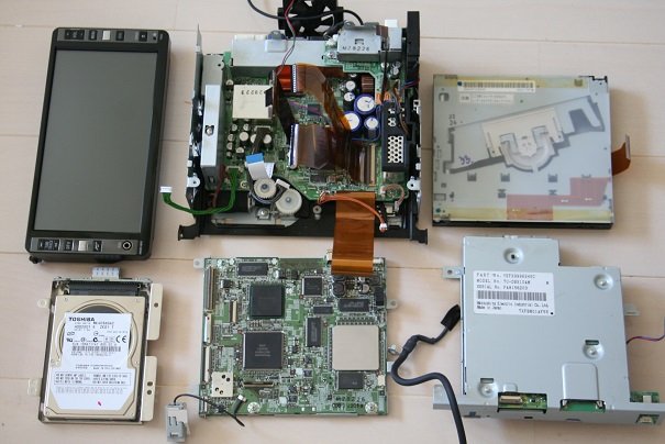

Mentioned at the start of the post. The front lcd screen panel on the NHZN W57 wouldn't open.
Turns out because of a sticky dry or worn cog in the drive mechanism!
A slight whack on the top facia panel seemed to free the screen to open and shut.
