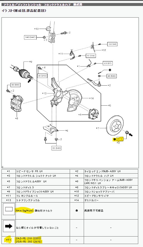

Hello all! I have just had to change the inner cv joint on my Toyota Alphard ahn20 but cant find the torque figure for the drive shaft /hub nut.
can anyone help me with this please?
Hopefully not too late to help out. I've got this from the Toyota service manuals at my work.
2AZ-FE: 216 Nm
2GR-FE: 292 Nm

thats brilliant! thanks so much for that.
