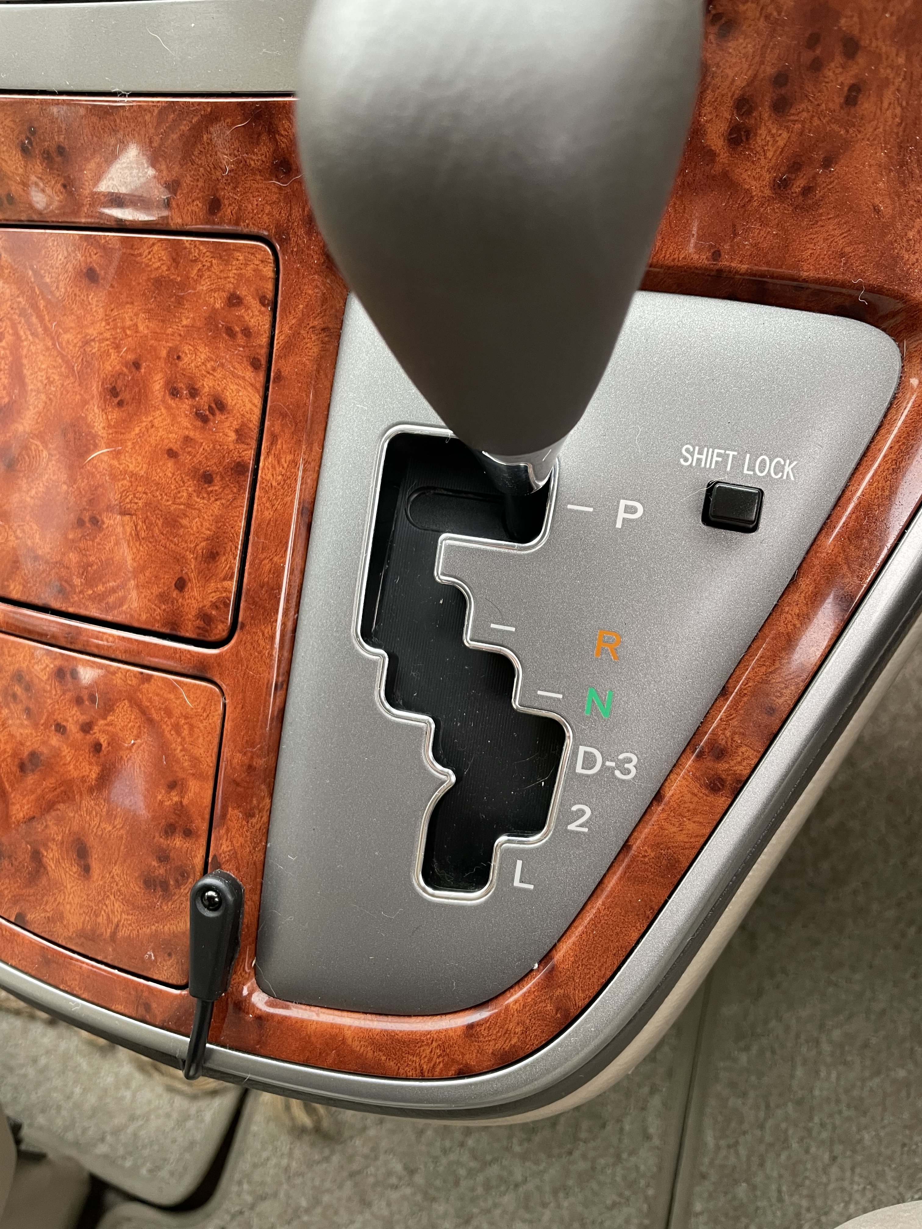

whilst I'm on here, anyone suggest what the black add on item just below and to the left of the gear change is for, see pic
looks like a camera lens

As a guess, the black gadget looks like a microphone or an on / off switch for one of the many options many Japanese fit to their vehicles.
These gadgets get removed, usually, before auction.
I have three or four non functional gadgets.
I have left mine alone fearing removal damage to trim etc.
Thanks Roger
I'll report back should I find my own mystery 'gadget' has an use
